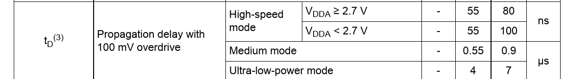

I have a board NUCLEO-WB55 and I'm testing some examples.
I'd like acquire a sine wave about 14 MHz and convert to square wave with internal comparator.
I can't find enough informations on datasheet if it's fast to acquire this signal.
Thank you for suggestions
1 reply
AScha.3
December 11, 2022
for 14 MHz you have 36ns per hi or lo, so 55..80ns is slow, just try it. maybe working - because chip should be always faster than written in ds.
