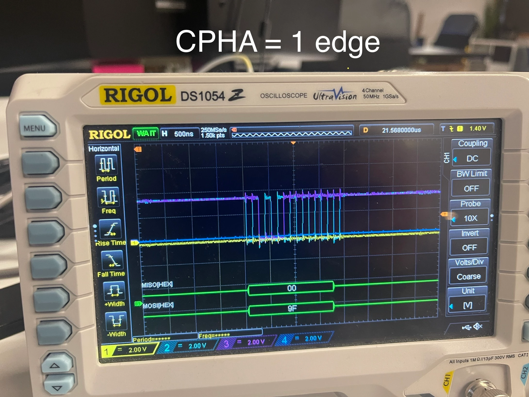

We're having an odd SPI bug with our custom board.
We made a board based on the STM32WB55, everything seems to work fine except for this issue.
We're trying to use the spi in mode 0 (CPOL=0 CPHA=0) , but we can't make it work.

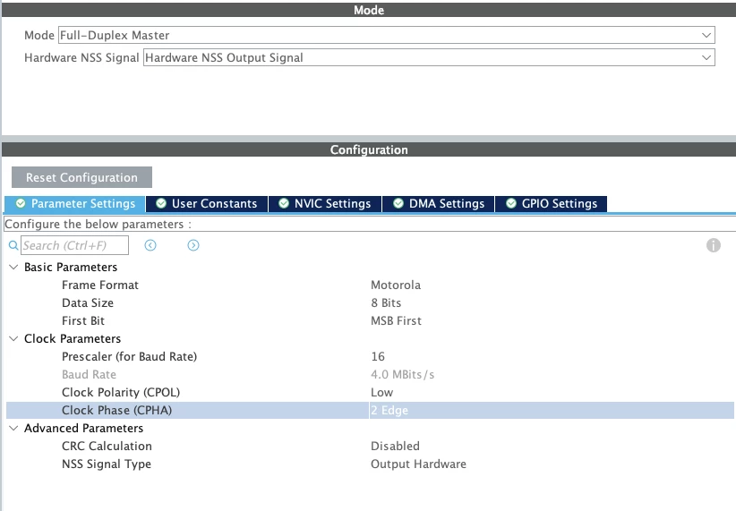

We have these settings:
 0693W00000WJM4pQAH.pngand our code looks like this
while (1) {
 uint8_t payload_instruction[1] = {0x9F};
 mcg_SX1509B_set_output(INT_SPI_CS_FLASH, 0);
 HAL_SPI_Transmit(&hspi2, payload_instruction, sizeof(payload_instruction), HAL_MAX_DELAY);
 mcg_SX1509B_set_output(INT_SPI_CS_FLASH, 1);
 HAL_Delay(700);

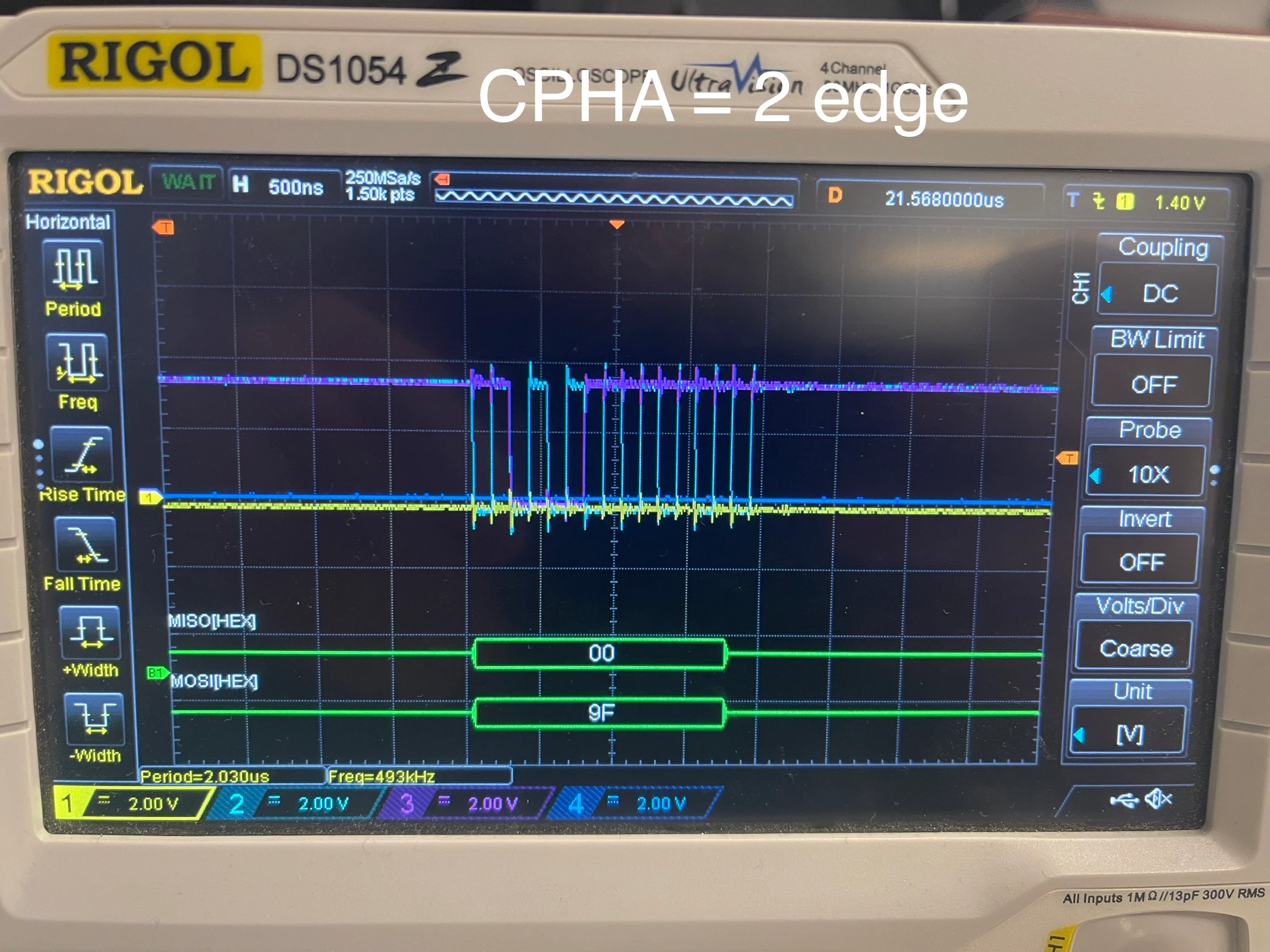

And no matter if we set CPHA = 1 edge or CPHA = 2 edge the SPI signal is the same
 0693W00000WJM4uQAH.jpg0693W00000WJM5EQAX.jpgWe tried the same test on a Nucleo Wb55Rg and we had the expected result but not on our custom board.
Is there anything software or hardware we miss to acheive spi mode 0 ?
