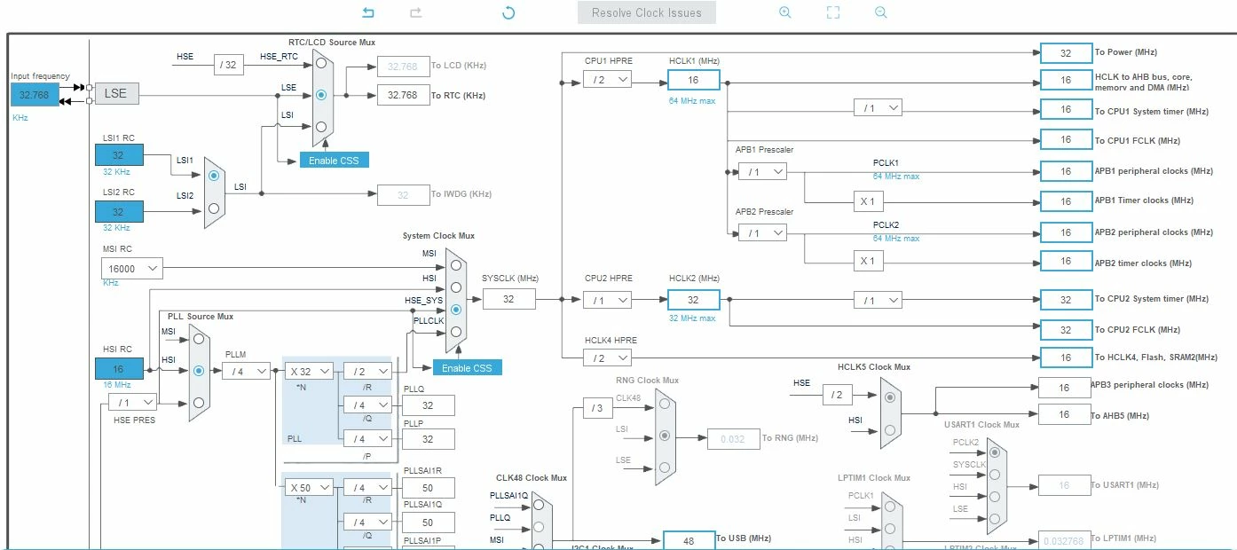

STM32WB55: Can I run CPU1 at 16MHz and BLE at 32MHz?
See attached clocking setup. When I run this, BLE is unreliable. I am running STM32WB55CGU6 in server/peripheral mode. For example, sometimes on power up advertising is occurring and sometimes it does not. And if advertising does work, connecting from my smart phone almost never works. If I change CPU1 to 32MHz, it works great every time and is 100% reliable. I want to run CPU1 at 16MHz to save battery life. I can't run CPU1 any lower because I am running 5 channel ADC DMA constantly at 400kHz sample rate (5x400kHz is 2MHz sample rate for ADC). Is 16MHz on CPU just too slow with all this DMA to SRAM activity? Note that DMA is active but CPU is not doing anything during this time, except servicing BLE.

CPU1 can run to 16 MHz with BLE, only CPU2 must run to 32 MHz. I see in your screenshot that HCLK4 is set to 16 MHz but HCLK4 shall run to 32 MHz for SRAM2 access. Can you change HCLK4 HPRE in order to have 32 MHz for HCLK4 and retry your application ?

From ST:
CPU1 can run only down to 32MHz when running BLE since network co=processor CPU2 must be always clocked at 32 MHz, this is stated in section 5 of AN5289 (https://www.compel.ru/wordpress/wp-content/uploads/2019/12/en.dm00598033.pdf).
CPU1 is capable of running down to 16MHz, however, only if BLE is not needed and therefore CPU2 is shut off.

I tried HCLK1 16MHz and HCLK4 32MHz and it works great with BLE. Thank you for the information.
