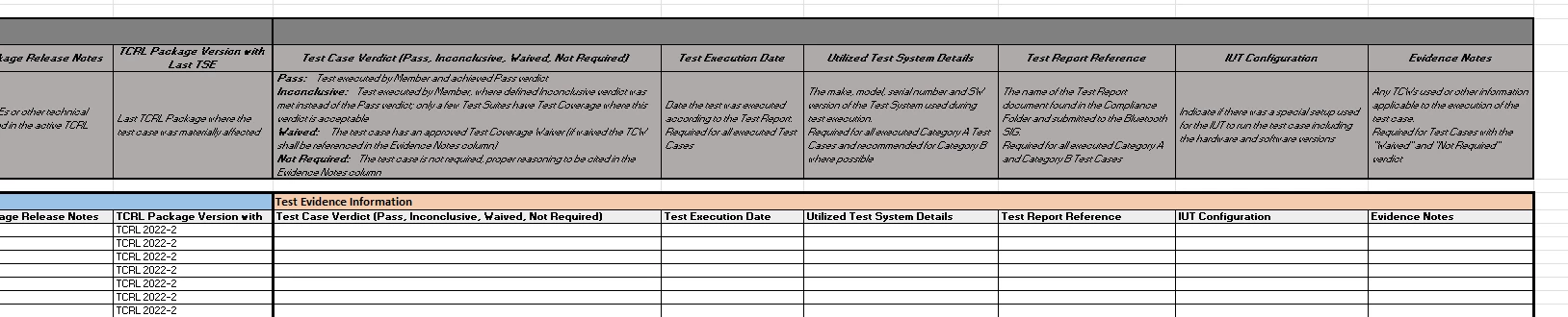

The ST bluetooth SIG wiki for STM32WBx (link here) seems to be out of date since the TCRL required has been updated to TCRL 2024-1. The wiki shows that the test report generated by the online tool, simply required referencing the applicable QDIDs. Well with the new TCRL 2024-1, this is supposedly not required anymore as there's no option in the test report to refence the ST qualified QDIDs ?

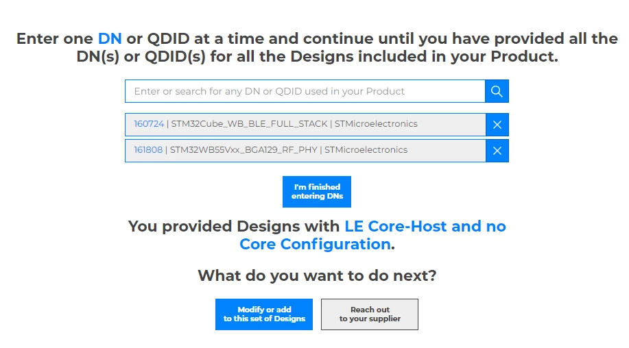

I suspect this couldbe due to the whole tesdt report being incorrectly generated as the online tool from Bluetooth SIG states that hte ST QDIDs does not specify a LE core-host or core configuration ? This leaves one then to specify it manually in the online tool ?
Any help would be greatly appreciated!
