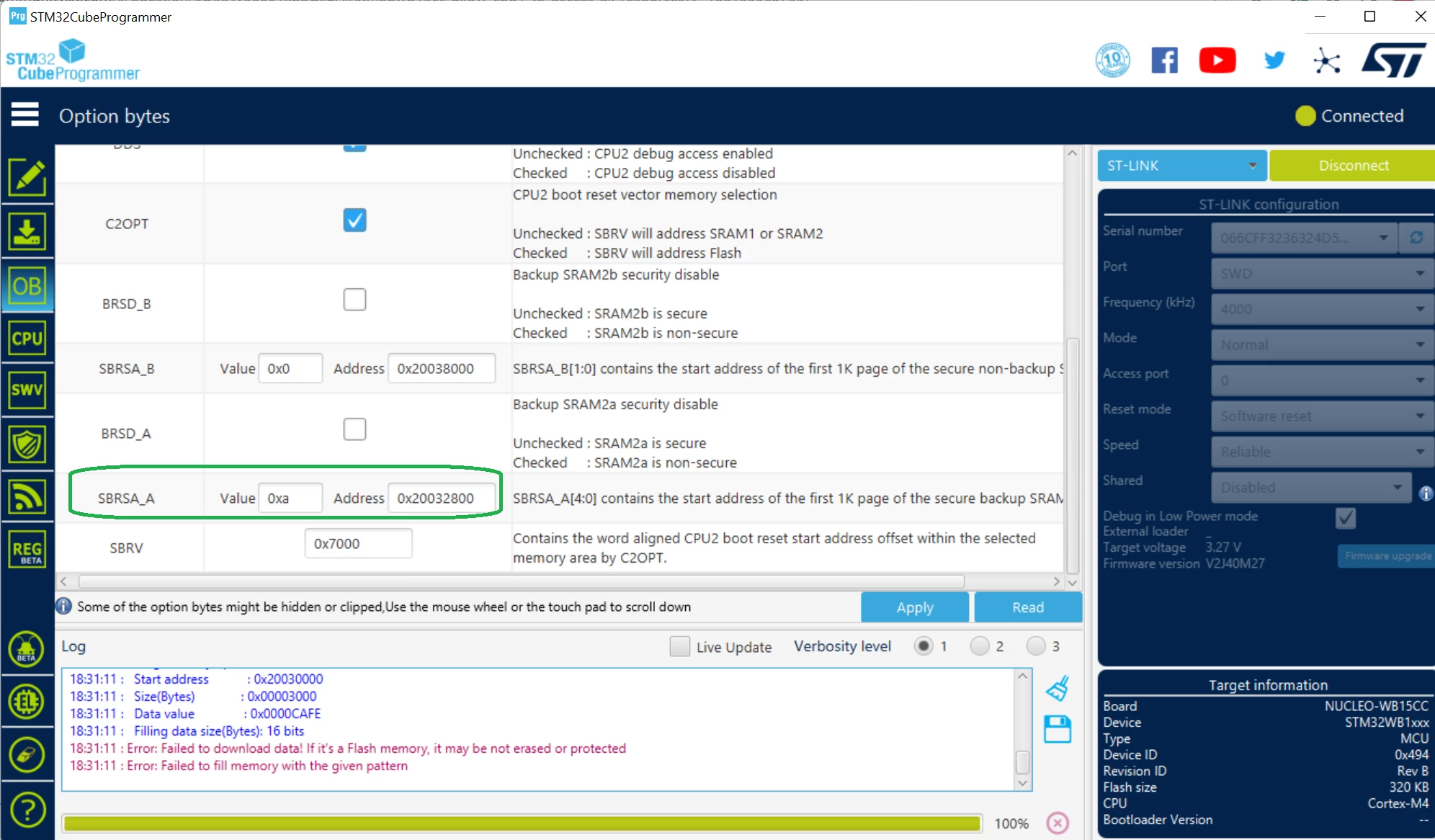

I am trying use the stm32wb15cc to run an application on CPU1, but with no application in CPU. I don't need the RF side at all and want to hold CPU2 in reset and allow CPU1 to access all the Flash and Ram.
However this does not seem possible as Option Bytes are set to reserve parts of the flash and RAM 2a and 2b, so I have limited access. Apparently these bits can only be reset by CPU2. I tried using the Cube Programmer, but it was not able to change these bytes.
Is it possible to clear these bytes in some manner? Or can ST provide a binary for CPU2 that removes the security or just reduces the RAM lock to just the last 1KB of each region?

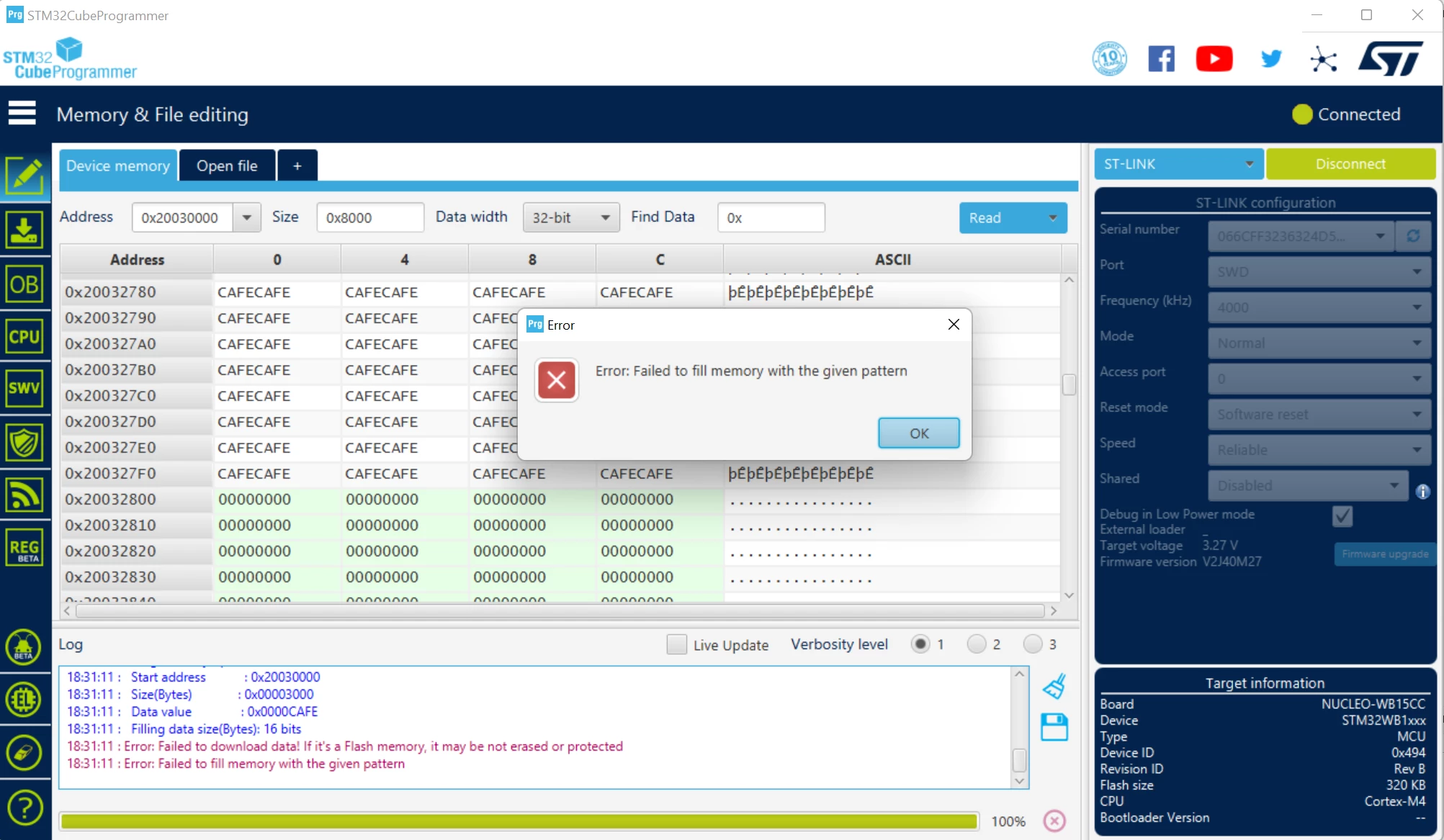

Hi Remi,
I commented out the line that enables CPU2 and used the debugger to confirm that the C2BOOT bit was not set.
I used the CubeProgrammer to do a full chip erase. I then filled SRAM1 with 0xCAFE and confirmed that I was able to read and write to this part of the SRAM.
I then used the tool to read out the values of SRAM 2a, but as expected, saw only 0x00 for the area secured by the option bytes. I attempted to fill this region with 0xCAFE, but the CubeProgrammer failed to write to the protected region. I first tried filling 0x2800 bytes (which is the unlocked size) and that succeeded. I then attempted to fill 0x3000, but that failed as it hit the protected area.

Remi QUINTIN
Aug 31, 2022 3:18 PM UTC
In fact, the 2 option bytes defining the start address of the protected area for SRAM2a and SRAM2b are set by the wireless stack only. So, there is no way for any application on the M4 core to access/modify them.
The only way would be to get a piece of code that would set them to the top of the SRAM memory. But we do not have such code.

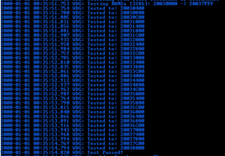

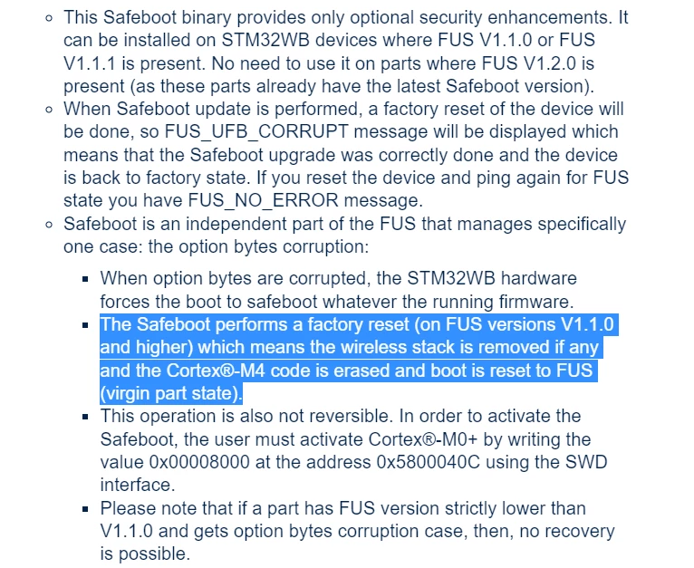

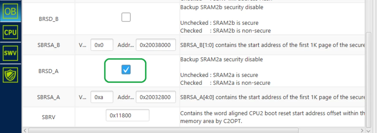

I never got around to loading any of the RF stacks. I found this info about 'Safeboot' and tried both the FUS "FW Delete" and then tried to force the safeboot by writing the value 0x00008000 at the address 0x5800040C.
After I rebooted, the SRAM2a security was disabled and I was able to test access to the full range of SRAM2a. This unlocked 32 KB, combined with the 12 KB of SRAM1, gives me all the memory I need for now. SRAM2b was still locked, but it is small enough that I don't care about it.
I tested access by reading every location in the range and then writing the same value back again.
0693W00000SuFV8QAN.pngI am not sure which of the two steps did the actual unlocking, but it is the end result that counts!
