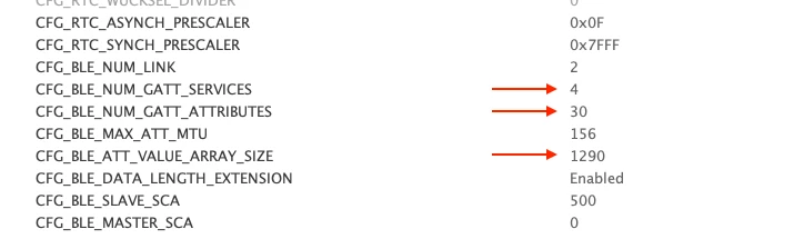

for STM32WB15xx please change some configuration because of RAM limitation ref: NUCLEO-STM32WB15 HardFault Error with BLE custom Template.
0693W00000QNI4aQAH.png config : (in example use this config value I don't known how to calculation :grinning_face_with_sweat: )
Minimum Heap Size : 0x400
Minimum Stack Size : 0x1000

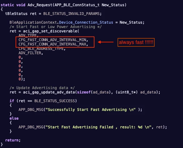

In code generation I can't start advertising with low power mode by change APP_BLE_FAST_ADV to APP_BLE_LP_ADV in Adv_Request(APP_BLE_LP_ADV); function.
because in this function always with fast mode ?
0693W00000QNICeQAP.pngsolution
BleApplicationContext.Device_Connection_Status = NewStatus;
 /* Start Fast or Low Power Advertising */
 ret = aci_gap_set_discoverable(ADV_TYPE,
		 NewStatus == APP_BLE_FAST_ADV ? CFG_FAST_CONN_ADV_INTERVAL_MIN : CFG_LP_CONN_ADV_INTERVAL_MIN,
				 NewStatus == APP_BLE_FAST_ADV ? CFG_FAST_CONN_ADV_INTERVAL_MAX : CFG_LP_CONN_ADV_INTERVAL_MAX,
 CFG_BLE_ADDRESS_TYPE,
 ADV_FILTER,
 0,
 0,
 0,
 0,
 0,
 0);
