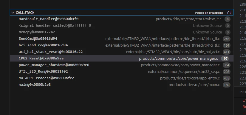

I have made an application on that needs to enter shutdown/standby mode on the STM32WB10 MCU.
I have successfully made it enter the shutdown mode, and I can wake it back up again.
However, when it wakes up, it does not get any response from CPU2.
It is as if the task "shci_user_evt_proc" is never called in a way that allows it to call "
APPE_SysUserEvtRx()" in app_entry.c
As a result I only have Bluetooth when the MCU is started the first time from a power cycle.

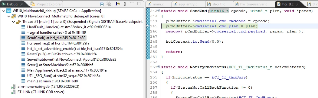

The current version of my application enters standby/shutdown after 10s of no user interaction.
After wakeup, it enters HardFault_Handler() when it attempts to enter shutdown again.
This happens when it attempts to send the command for disabeling the advertising (which i suspect is obvious, since the CPU2 is not responsive).
Below is a screenshot of the stacktrace and the line that causes the hard fault.
I suspect this is caused by my code not doing something the way it should, but I cannot figure out what it should do, or when.

The ResetCPU2() function that attempts to stop the advertising looks as this
void ResetCpu2()
	/*stop adv , stop ble stack , reset cpu2 */
	// Stop Advertising
	hci_le_set_advertising_enable(0);
	// Reset the stack
	aci_hal_stack_reset();
	// Reboot CPU2
	SHCI_C2_Reinit();
Can anyone point me in the right direction as to what I am doing wrong?

Feb 29, 2024 11:52 AM UTC
Hi, I've exactly the same problem. Does anybody have a fix ?
