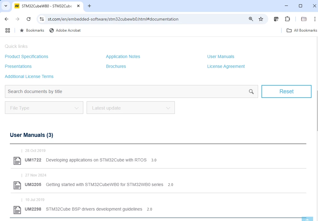

Andrew Neil
Feb 12, 2025 11:12 AM UTC
@jens0501 wrote:
I'm not sure if the wb09 can use this function. rds
That should be answered by looking in the HAL User Manual for the STM32CubeWB0 software package.
But there is no full User Manual listed - just a Getting Started guide:
https://www.st.com/en/embedded-software/stm32cubewb0.html#documentation
@STTwo-32 - where is the full User Manual?

STTwo-32
STTwo-32Best answer
Mar 11, 2025 9:59 AM UTC
Hello @jens0501
the functions HAL_PWREx_EnterSTOP0Mode(), HAL_PWREx_EnterSTOP1Mode() and HAL_PWREx_EnterSTOP2Mode() are not implemented on the STM32CubeWB0. So, I suggest you use the same method as the PWR_DEEPSTOP and the PWR_DEEPSTOP_RTC. Also, I've escalated this to the concerned team to updated the UM3363. (Under internal ticket number 205073). For adding the UM3363 to the STM32CubeWB0 web page, I've sent this request to the concerned team.
Best Regards.
