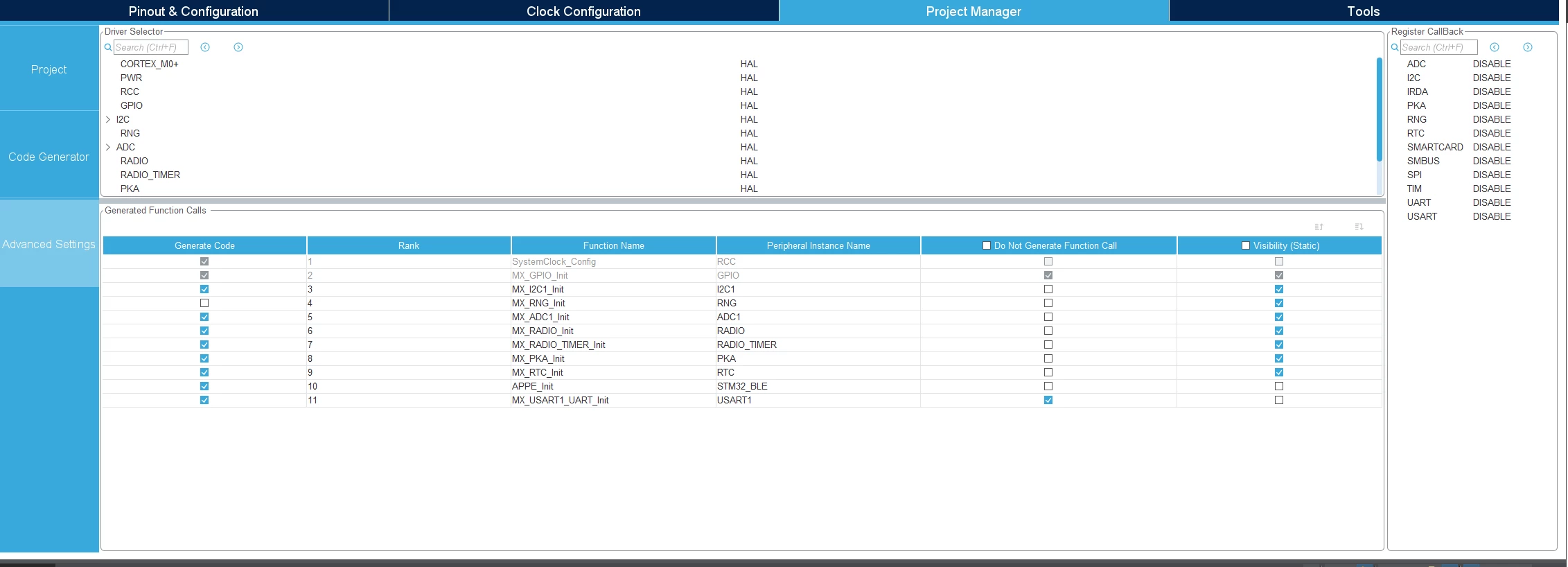

  1. Enable the RNG.
  2. Disable the generate under root.

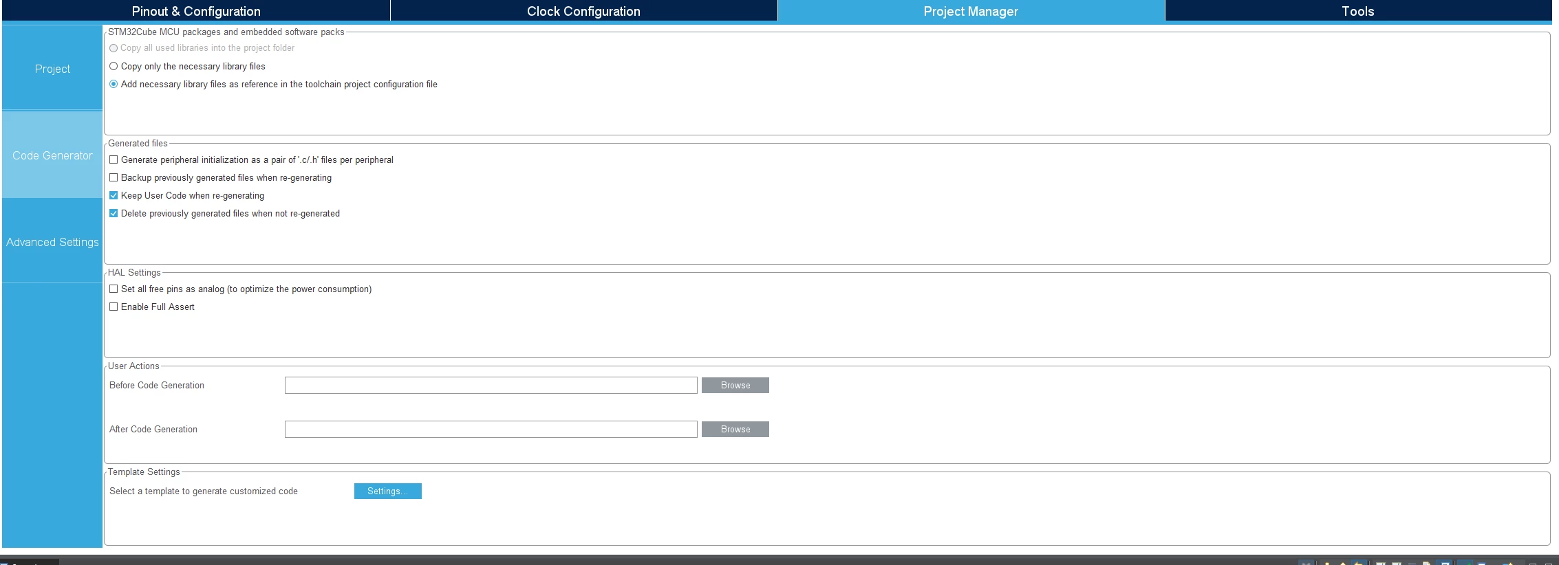

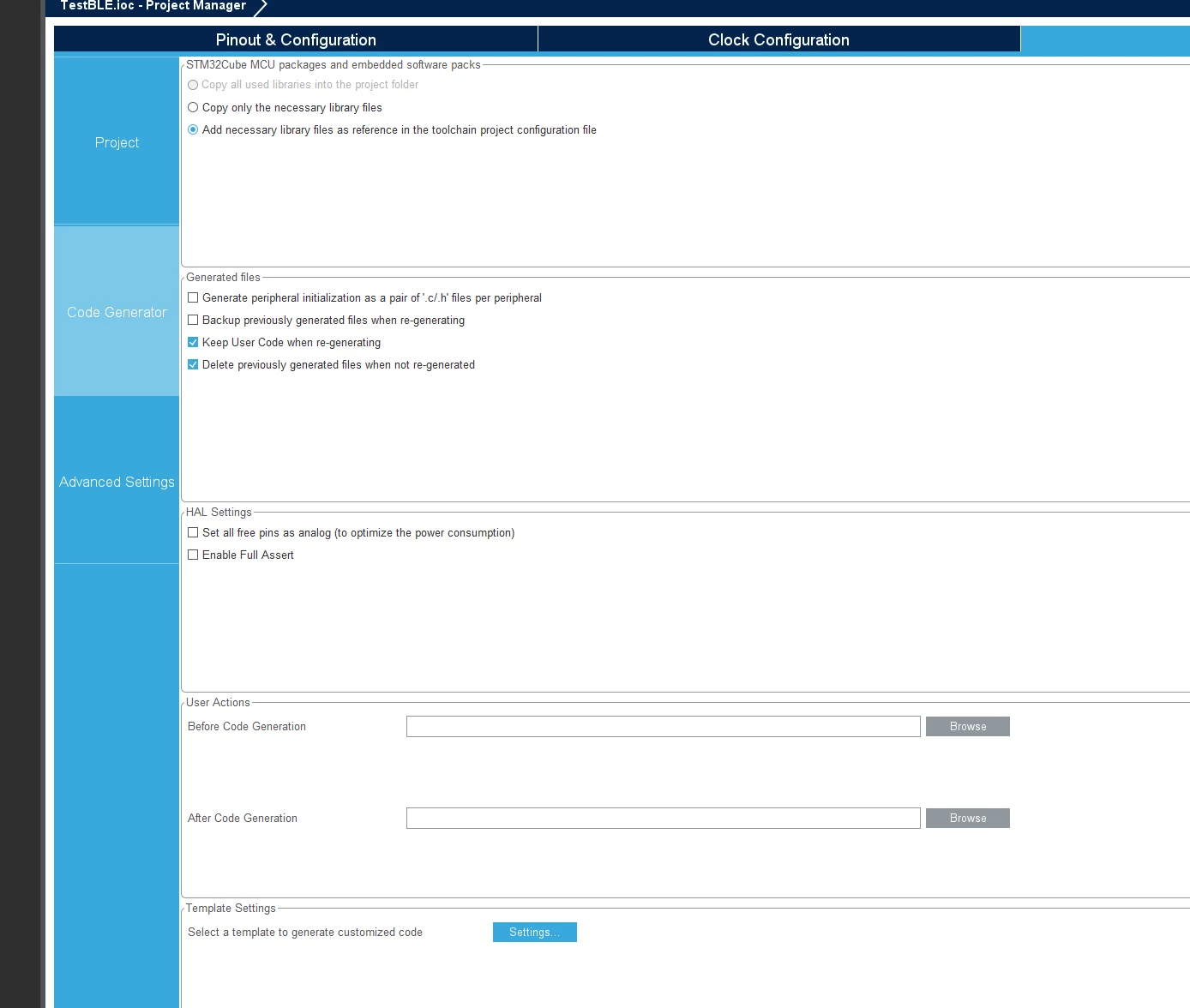

  3. Select the "Add necessary library files as reference in the toolchain project configuration file": STTwo32_0-1738595535120.png
  4. On the Generate function call, follow this screenshot:

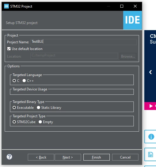

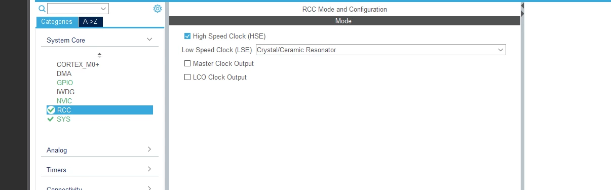

Here I am going to create one blank BLE project and screenshot all process

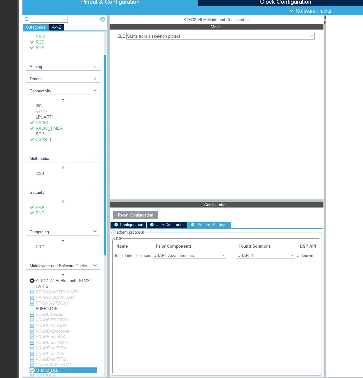

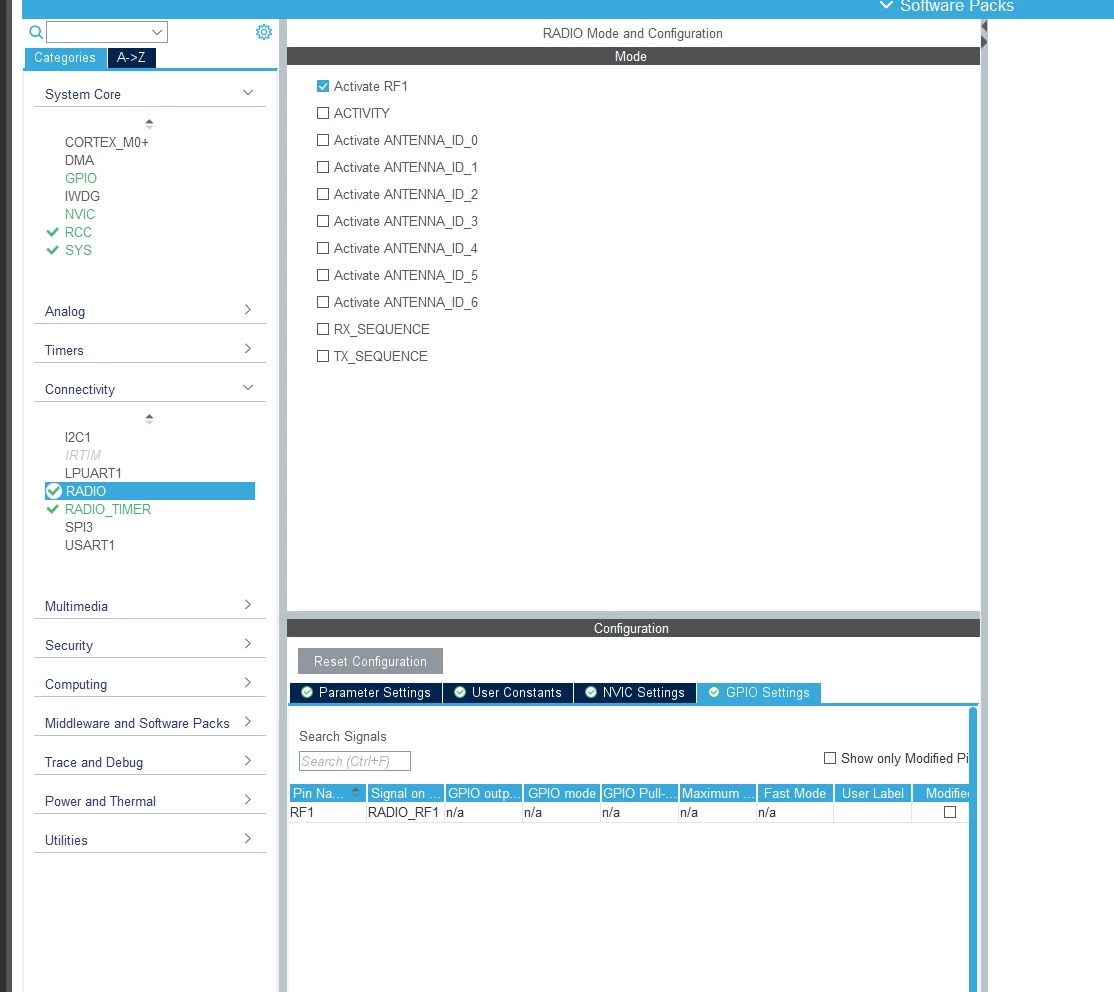

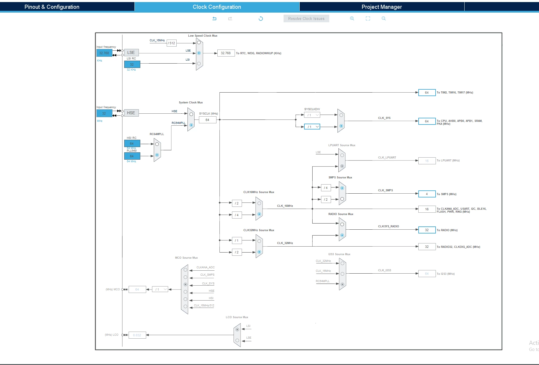

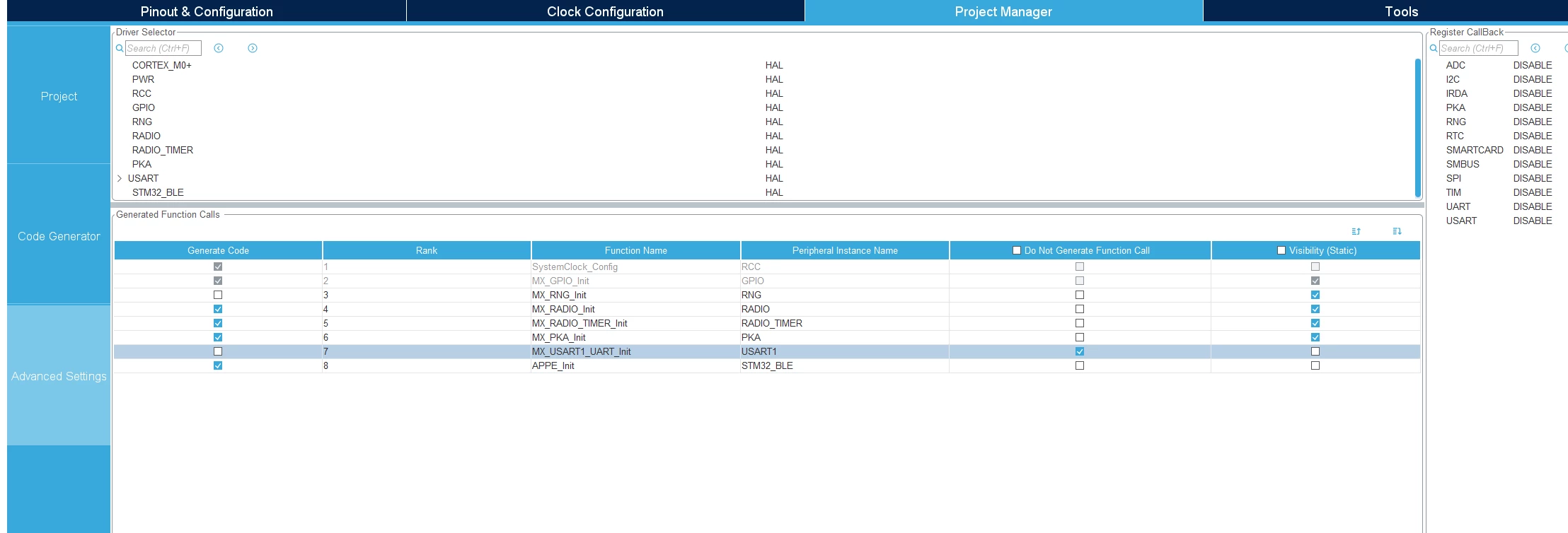

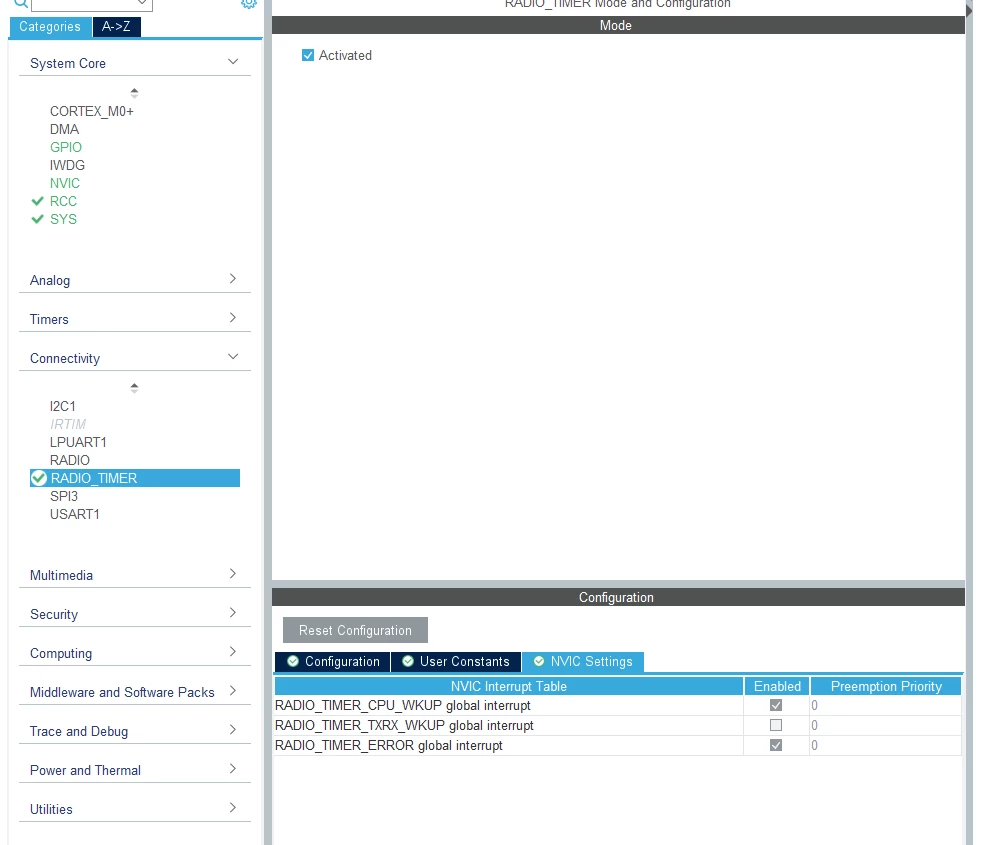

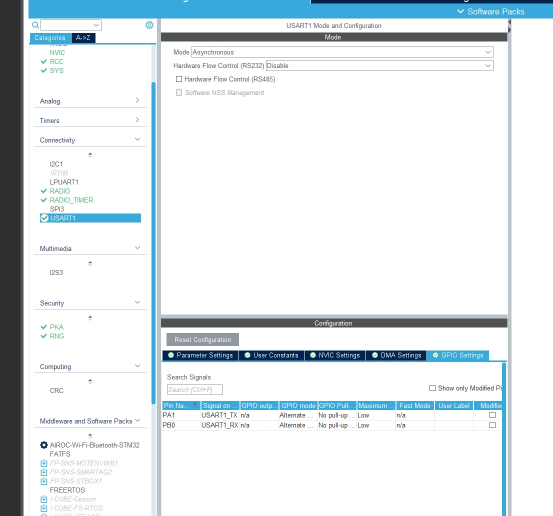

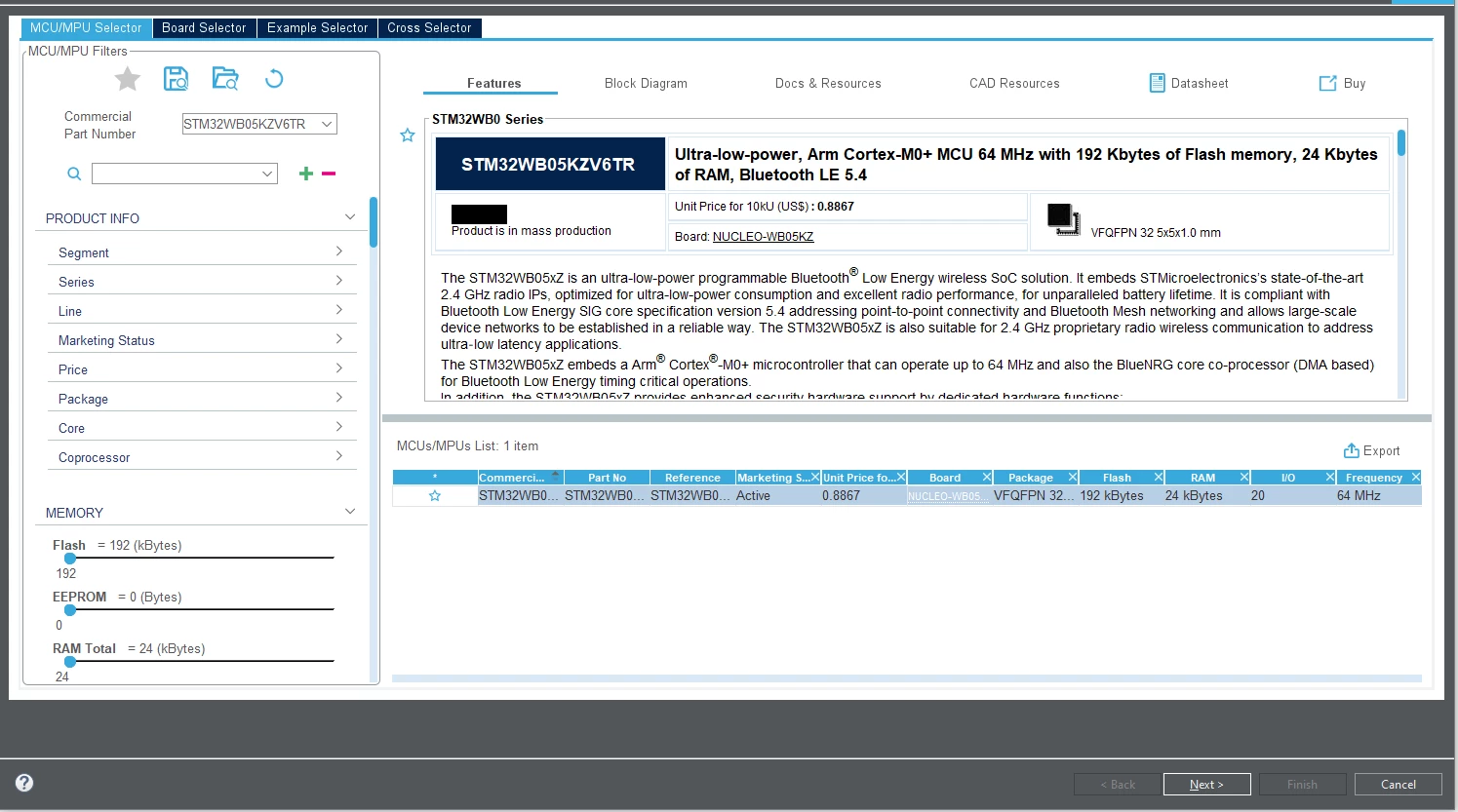

1. Creating a temp project, selecting the target microcontroller (STM32WB05KZV6TR)
2. Selecting C, and hitting yes for opening the configuration tool

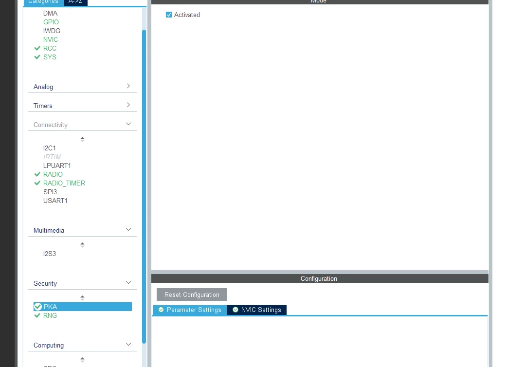

3. Enable the HSE
4. enable the Radio timer
5. Enable the radio
6. Enable the PKA and RNG
7. enable USART
8. enable BLE and add USART as platform for traces
9. Clock configuration
10. add files to the project
11. advanced settings as suggested
12. save and generate code
13. press compile
14. get error

Generate the code to CubeIDE from CubeMX and don’t import it. On CubeMX, Go to project Manager > Project > select CubeIDE as your IDE and give the project a name. Then, click on generate code.
Best Regards.

drafshinAuthor
Feb 12, 2025 6:06 PM UTC
I did, and still same issue. Attached is the zipped folder of the project created with CubeMX. I would appreciate if you could try compiling on your end, or making a project from scratch for STM32WB05KZV6TR. To me I think its the project settings where assembly files are not complied in order, maybe a bug, but only this specific chip gives me hard time, but we can't change it since we have our hardware manufactured, and we followed datasheet for the design, to exact specs.
STTwo-32
Feb 13, 2025 1:55 PM UTC
Hello @drafshin
I've added a project that does compile on the STM32CubeIDE V1.17.0. Please open it as it is or generate your own based on the .ioc file of this project (don't change parameters). After that create another project (any project on any MCU not the STM32WB0) I've got already other projects on my side too:
After that compile the project based on the STME32WB0. You may receive another message. After that compile the other project and recompile your STM32WB0 project. This time it should be working fine with this workaround:
PS: this behavior will be solved on the coming release (coming in a few days) of the STM32CubeMX.
Best Regards.
