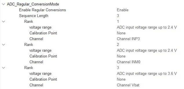

I am using a STM32WB05KZ of a custom PDB, and I can not read a correct value of Vbattery.
I have programed the ACD (+DMA) usgin CubeMX.
I use DMA to read the analog inputs:

According de manual, the formula for ADC converted data after calibration is the following: Code = Integer(4096/3.6 * VIN) [clamped at 4095]. The result of conversion from Vbat is 0x271, applying the formula I get 0,549V when the Vbat is 3V.
I also use 2 analog inputs in PB2 and PB5 and nome of them read correctly. In other proyects with stm32l105 and stm32wl55 the DMA works. I sure I am doing something wrong...
Can anybody help me?

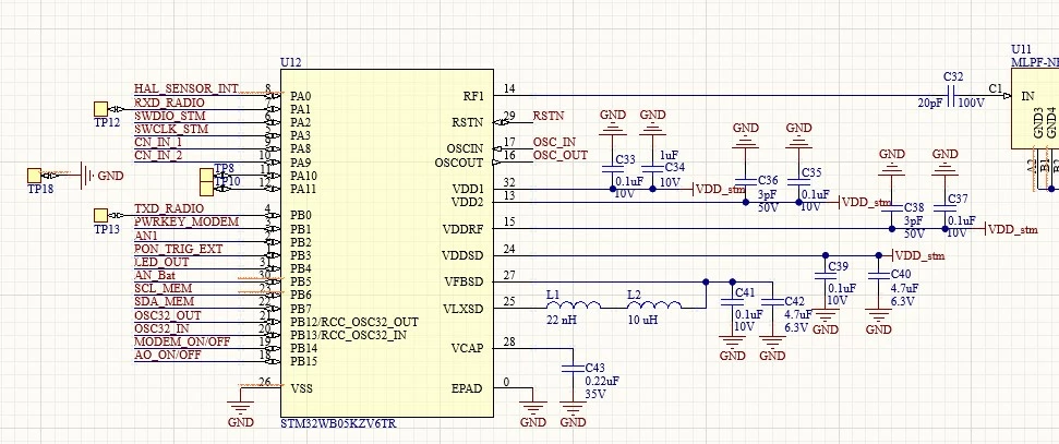

> custom PDB
What is the schematic?

This is the schematic:

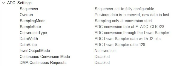

I have changed the sampling time but I get 0x300 (0,675V) as battery level.

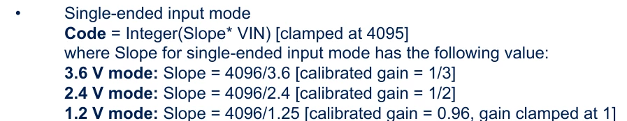

Why the difference? What has changed? I suspect there is a fixed divider but the math isn't working out.
Conversions are listed in the Reference Manual for the different ranges:
"calibrated gain of 1/3" doesn't make sense to me in this context.

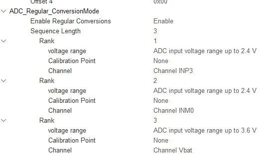

I was changed the sample rate from F_ADC_CLK /16 to F_ADC_CLK /28:
- F_ADC_CLK /16 I get 0,549V when the Vbat is 3V
- F_ADC_CLK /28 I get 0,675V when the Vbat is 3V
I don no use any calibration point
