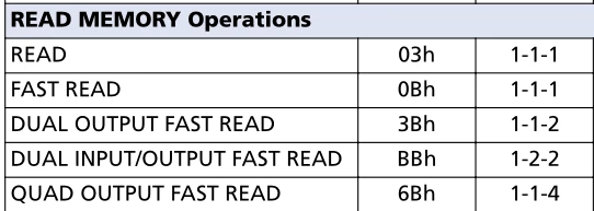

I have a very strange issue with QSPI peripheral. I am using it to store logs in external memory.
The flash that is used is MT25QL256ABA with a custom STM32WB55 board. I have connected PModSF3 using jumper wires that are at least 15cm long.
Issue: When I use the FAST READ (single data line, 1-1-1 mode), it works perfectly fine. I am able to validate it with the hex dump of a buffer that writes ASCII (0-9). But when I use it in QUAD OUTPUT FAST READ (1-1-4), I get some missing data that is probably shifted.
I have specified two dummy cycles based on the datasheet. Tried increasing it, does not make much of difference.
But reducing the clock speed by a factor of 100 seems to help, but then quad mode is useless.
The code is based mostly from the ST examples.
Can anyone help me in figuring out the issue? I can provide more data if needed.

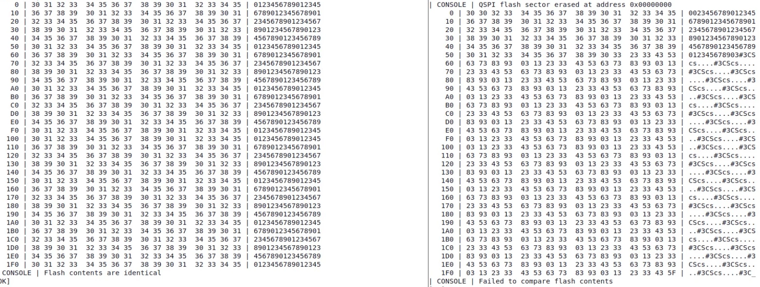

Another strange thing that I have observed when using Quad (1-1-4) addressing is that, when I write the same byte, the contents are perfectly read back.

To generate the above pattern, I have used a loop to write to a buffer. This buffer is written to the QSPI flash.
	ok &= QSpiFlash_Erase(address, len);
	for (int i = 0; i < len; i++)
		pMemBufWrite[i] = (uint8_t) 0x55; // or 0xAA
	ok &= QSpiFlash_Write(address, pMemBufWrite, len);
	ok &= QSpiFlash_Read(address, pMemBufRead, len);
	if (ok)
		Utils_HexDump(address, pMemBufRead, len);
When the bytes are different (random), it fails to read. Almost seems like the data lines are pulled up and they stop working. The idea behind writing 0xAA or 0x55 is to see if all the lines are working as expected. Which to me seems like it is working well.
Now, when I change the code to write an arbitrary pattern, it fails.

I can't seem to reason on why it fails for such a pattern.
That does seem excessively long, the fixtures I've built are at least half that length, and wire-wrapped, not sketchy dupont wiring. For push fit connections perhaps look at Schmart jumper wires.
Are you sure the problem is on the read side? Is the read-back pattern consistent?
Could be an issue on the write? That wouldn't need dummy cycles, but does need bus integrity.
I tend to write a predictable pseudo-random sequence under known conditions, perhaps via programmer or in 1-1-1 modes, and then validating all the read methods (1,2,4-bit) against the gold-rom.

@Tesla DeLorean,
I can confirm that it was the long jumpers that were causing the issue. The same code works perfectly fine on the custom PCB.
