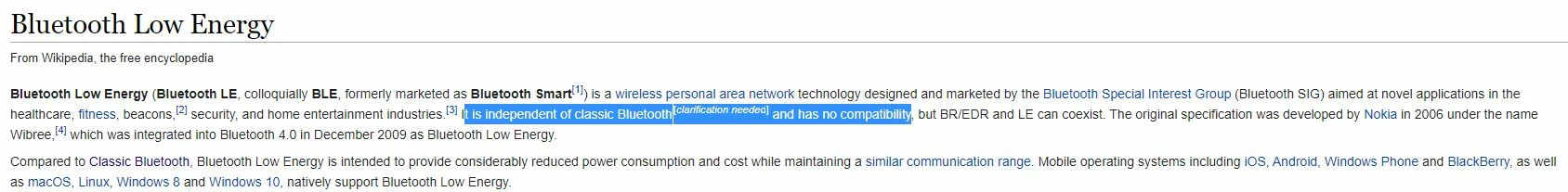

STM32WB with BLE can connect to a classic bluetooth device ?
I want to know if a STM32WB with BLE can connect to a classic bluetooth device
Thank you

@Ons KOOLI​ : About classic bluetooth you can see in the Official website of bluetooth : https://www.bluetooth.com/learn-about-bluetooth/radio-versions/
I read that BLE is independent of classic bluetooth and has no compatibility so i'm a little confused : https://en.wikipedia.org/wiki/Bluetooth_Low_Energy
In STM32CubeWB FW package i can find the exemple between 2 BLE devices but in can't find an exemple between a BLE device and a classic bluetooth device. Do you have some project exemples ?

In fact BLE devices can connect to smart bluetooth devices but not to classic bluetooth devices. See presentation in attachement.
