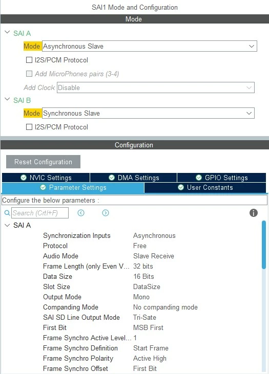

I found a possible bug in the "stm32wbxx_hal_msp.c" file when using Cube in the STM32CubeIDE to enable the SAI peripheral.
I did not test all the combinations, but have mine set up as follows:
SAI A - Async Slave
SAI B - Sync Slave
The bug is that the the code does not include and set the "Alternate" member of the GPOI_InitStruct for SAI Block A and B
The generated code is:

I'm using:
STM32CubeIDE V1.6.1
STM32CubeMX V6.2.1-RC2
with
STM32Cube FW_WB V1.11.1

Khouloud OTHMAN
Jul 29, 2021 5:07 PM UTC
Hello @DeonT​ ,
Please excuse the somewhat late reply and thank you for having reported.
Actually, I wasn't able to reproduce any issue from my side, and GPIO_InitStruct.Alternate = GPIO_AF13_SAI1; is correctly generated.
Could you please attach your .ioc file for further check ?
Thanks in advance,
Khouloud.

DeonT
DeonTAuthor
Aug 5, 2021 9:19 AM UTC
Hi @Khouloud OTHMAN​ ​ ​ ,
Yes, every time CubeMX generates the code after a change, the GPIO_InitStruct.Alternate code is removed.
Unfortunately I cannot test it with version 6.3.0 just yet, since I'm in the middle of a project and don't want to update the software until we reach the next milestone.
I have attached the ioc file for you.
Khouloud OTHMAN
Khouloud OTHMANBest answer
Aug 5, 2021 5:26 PM UTC
Hi @DeonT​ ,
Thanks for your preempt reply and for attaching your project. Actually you're right, I've been able to reproduce the issue using STM32WB35CEUxA MCU even with the latest STM32CubeMX version 6.3.0.
This misbehavior will be reported internally to be fixed. I'll keep you posted with the updates.
Sorry for any inconvenience that this may cause.
Even though this reply doesn’t directly solve the issue, I’m marking it as Best, since it will help clarify the current situation for other customers with the same question. I will post an update here once the issue has been fixed.
Thanks for your contribution.
