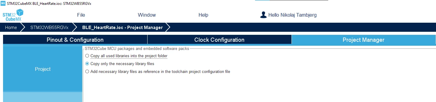

I managed to solve it this way:
  1. Open the project .ioc file in STM32CUBEMX
  2. Go to file > Save Project As
  3. Choose a new location for the project (the selected folder will be the project name)
  4. Under Project Manager > Code Generator > STM32Cube MCU packages and embedded software packs, I selected 'copy only the necessary library files'
  5. Generate code
Step 4 I did mainly because the YouTube tutorial from ST told me to. I don't know if it helped avoid our problem.
EDIT: the code that you expect would be preserved, was in fact not copied to the new project location.

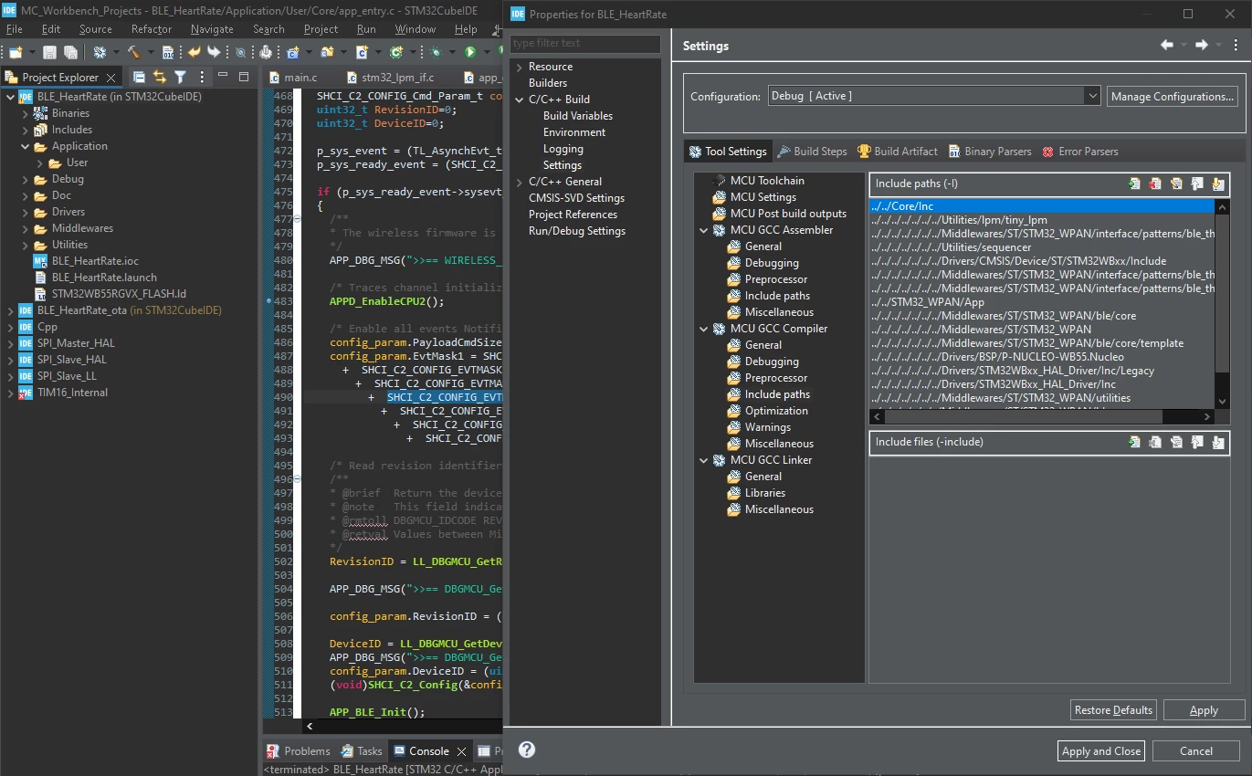

Jun 24, 2024 9:01 AM UTC
When cloning or downloading the STM32Cube_FW_WB_V1.19.0 the examples comes with relative include paths (../)
Opening the Compiler Include Paths looks like this:
When copying a example project the resources should therefore be included as well. This is done in the .ioc file by enabling 'Copy only the necessary library files'.
Afterward the relative include paths should be changed to match the current include paths of the project.
Go to Properties > C/C++ Build > MCU GCC Compiler > Include paths. Update these acording to your project setup. The default setup that matches the folder structure of STM32Cube_FW_WB_V1.19.0 is shown on the first screenshot.
