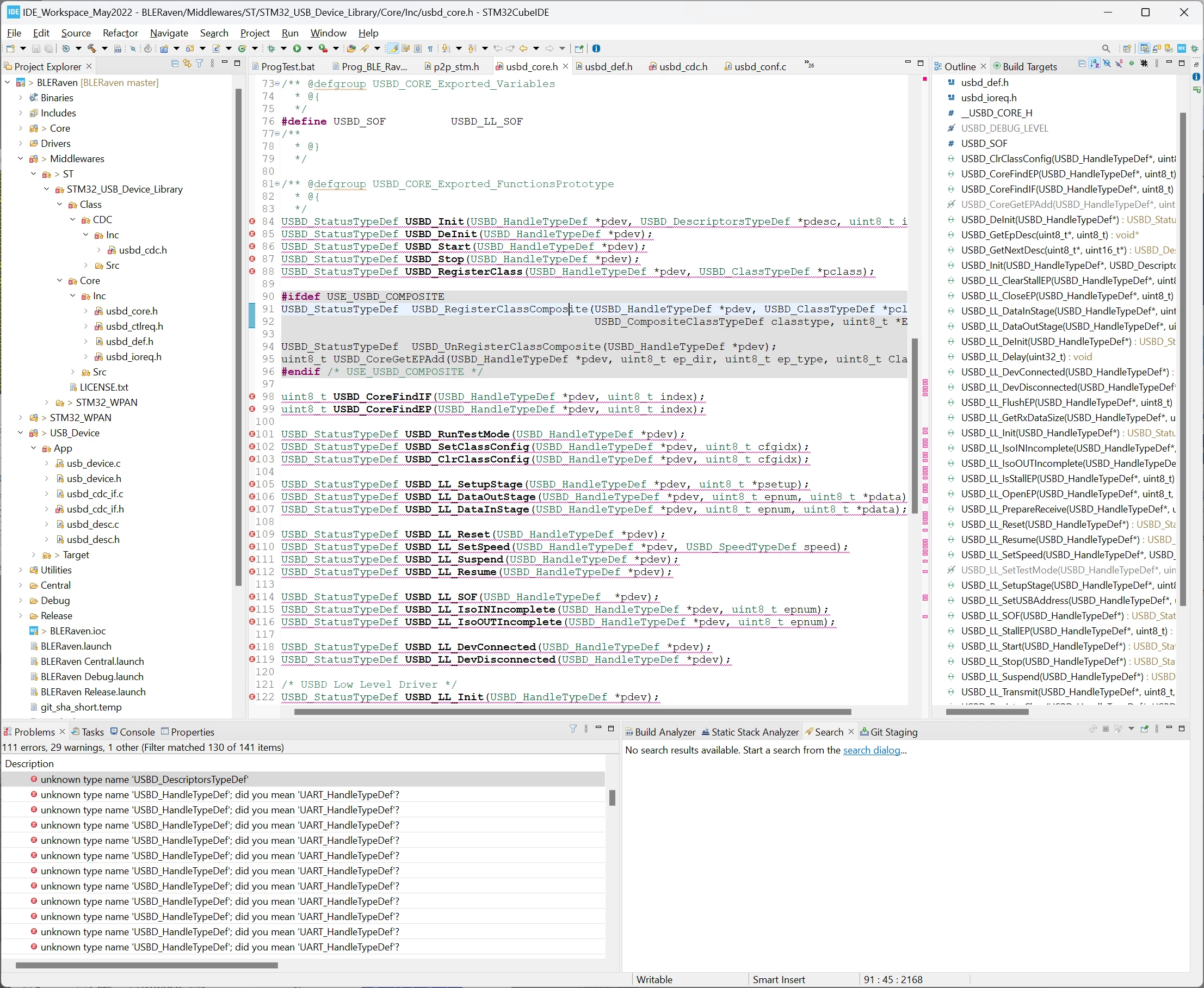

STM32WB IDE update to 1.12 caused hundreds of compile errors
One of the biggest offenders is shown in the image below.
All of the USB device types from usbd_def.h are not getting recognized by the compiler, even though usbd_def.h is in the include list at the top of the file in this image, and I can control-click to any of these structure definitions to go right to the defnition in usbd_def.h. I'm stumped about how to fix this. I have tried refresh, clean project and restart the IDE.

I was able to migrate the attached example project without issues. My steps were:
  1. Extract files in Windows and Import the project into the workspace
  2. Open the .ioc file. Accept the dialog box to migrate the project to FW 1.16.
  3. Generate code.
  4. Compile. It was o.k.
Next I did the same steps with my current project.
  1. Open the .ioc file. Accept the dialog box to migrate to 1.16.
  2. Generate code.
  3. Compile. I'm still getting 229 compile errors, like I showed at the top.
What files do you recommend I diff between the example project and my current project?
Thanks.
-Adrian

The new version of usbd_conf.h added an #include "main.h" that wasn't there before. After I commented that out, the USB compile errors went away and the compile error count went from 229 to 19. Some of the remaining errors are in the auto-generated p2p_stm.h file because "ble_types.h" was not included. I added that include in, and I'm down to 14 errors, mostly in my own BLE app. I added in #include "tl.h", and that fixed the rest, and I can now compile.
The problem is that now when I re-generate code, the #include "main.h" gets added back in, and #include "ble_types.h" gets taken back out of the p2p_stm.h file, and I'm back to 222 errors. Is there a trick I'm missing?
I already have to do some manual edits after every code re-generation (particularly the STM_OTA flag), and it is discouraging that there seems to be a growing list.
Adrian Adamson
Senior
Mar 28, 2023 9:55 PM UTC
I'm back working on this again, and I went to see why adding in main.h to usbd_conf.h would hurt anything. I looked for any user-added defines in my main.h that are usb-related, and I found that I had an #include for usbd_cdc_if.h. Once I commented that out, it fixed my USB errors.
For the ble_types.h problem, I see that it's because I include "p2p_stm.h" in the user code area of main.h. I put an #include "ble_types.h" just before it, and that fixed that set of problems.
It turned out that my USB receive buffer was defined in usbd_cdc_if.h, which is why I originally put it into main.h. It still causes hundreds of compile-time problems if I put it there, so I put the include in main.c instead, so that any other USB definitions would have already happened. Now my project compiles entirely without error.
I do still need to change BLE_CFG_OTA_REBOOT_CHAR back to 1 after every re-generation of code. ST, will you make that a Cube option at some point?
Also, I have to re-define CFG_USB_INTERFACE_ENABLE as 1 in the user error, which gives me warning messages every time I compile, since there doesn't appear to be a way from CubeMX to enable this flag. It's defined to zero in the non-user-modifiable part of app_conf.h and so I re-define it later in the same file.
