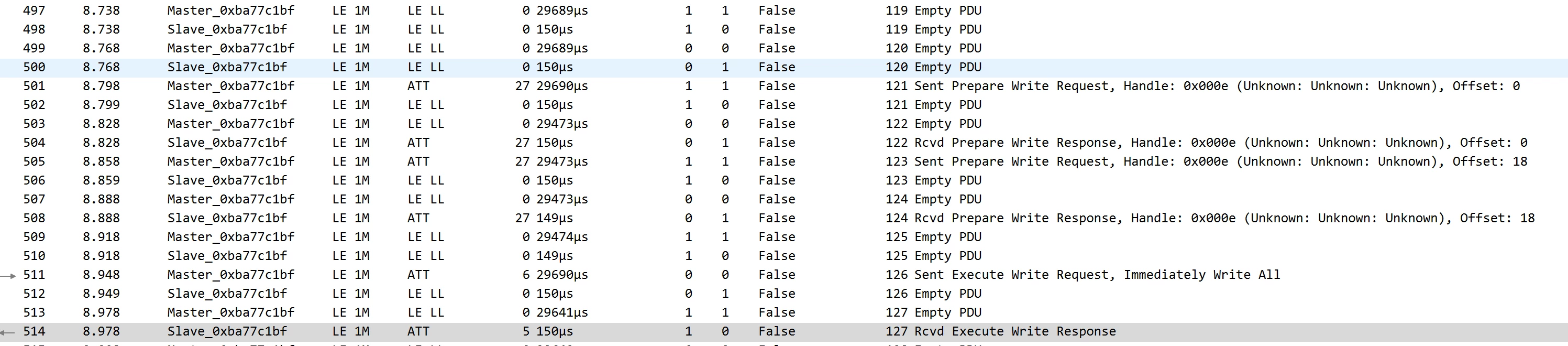

STM32WB, How to catch execute write event ?
I have configured my stm32wb as a BLE server and I would like to write large data. I handle prepare write request properly but how I manage the end of the transfer ?
As show on the figure, the client send a execute write request but how can I catch this event in application firmware ?
I found aci_att_exec_write_resp_event callback but it is never called.
Trace of the transfer :

The execute write event and prepare write event are managed by the BLE Stack. In application side, you can catch the ACI_GATT_ATTRIBUTE_MODIFIED_EVENT as describe in STM32WB_BLE_Wireless_Interface.html documentation, this event is generated to the application by the GATT server when a client modifies any attribute on the server, as consequence of one of the following GATT procedures:
- write without response
- signed write without response
- write characteristic value
- write long characteristic value
- reliable write.

Thank you for your quick answer, it works :thumbs_up:
