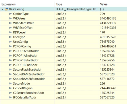

The surprising thing is that I can change the memory via the memory monitor at will, even after it has already been written once. Currently, I try to write to Flash_Register 0x0802F810 and its following.
The error occurs with different boards and different registers and can be repeated unambiguously. The HAL_FLASHEx_OBGetConfig (standard) can be found in the attached picture.
0693W000006FbxTQAS.pngI have already gone through several fora and tried to put in workarounds, but unfortunately without success. Does anyone know this problem or has an idea of how to solve it?
