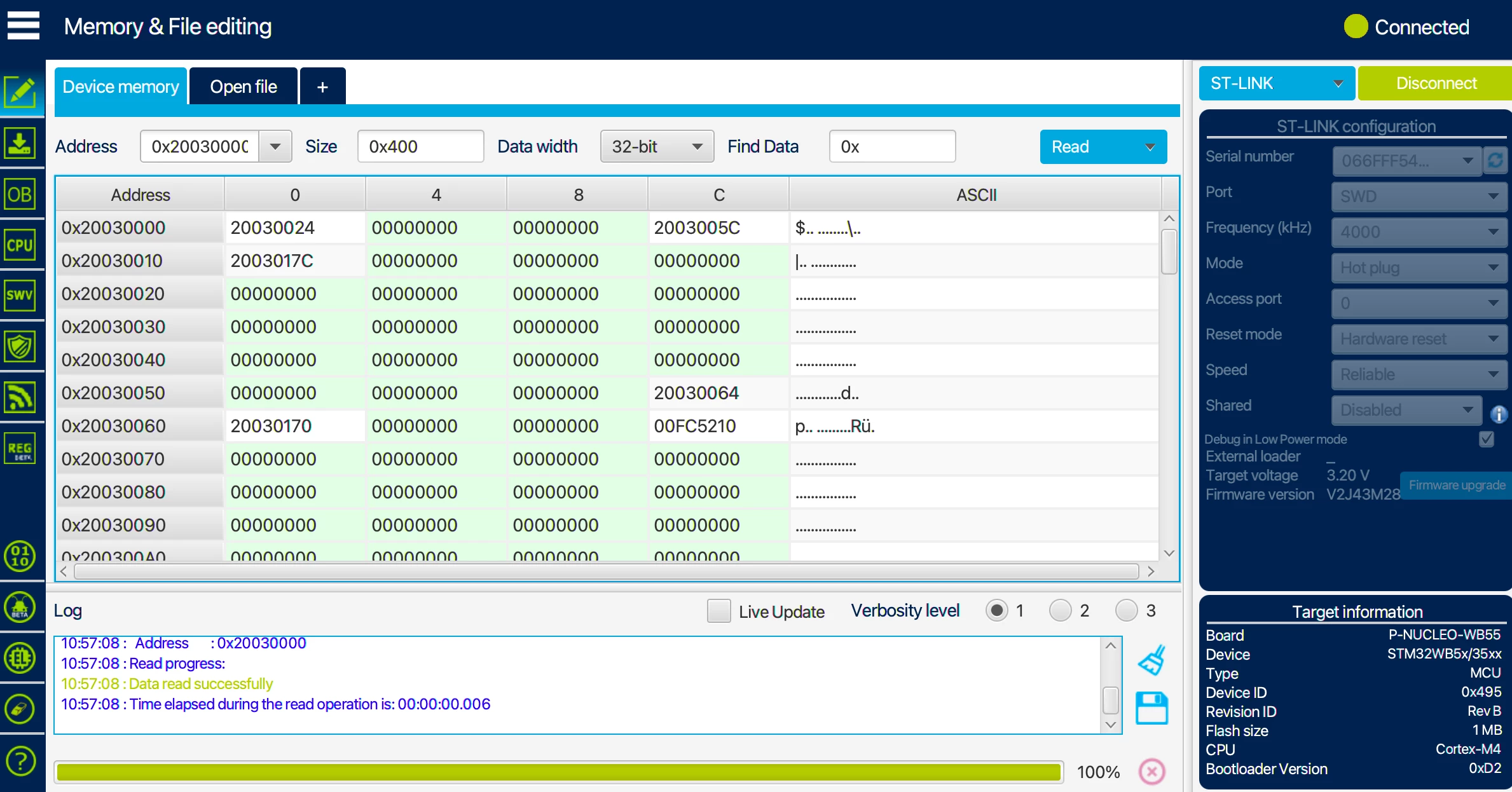

Hi.
I have nucleo board with STM32WB55RGV6 mcu. Trying to start FUS using StCubeProgrammer (swd mode), and unable to start it and even get its version. I do what is described in wiki: connect in normal mode + hardware reset, start fus, disconnect, start in hotplug mode. Tryed many combination but nothing works. What can be the reason?Screenshot 2023-09-20 at 10.57.30.png
 STM32CubeProgrammer v2.14.0
ST-LINK SN : 066FFF545057717867055039
ST-LINK FW : V2J43M28
Board : P-NUCLEO-WB55
Voltage : 3.21V
SWD freq : 4000 KHz
Connect mode: Normal
Reset mode : Software reset
Device ID : 0x495
Revision ID : Rev B
Device name : STM32WB5x/35xx

OPTION BYTES BANK: 0
 Read Out Protection:
 RDP : 0xAA (Level 0, no protection)
 BOR Level:
 BOR_LEV : 0x0 (BOR Level 0 reset level threshold is around 1.7 V)
 User Configuration:
 nBOOT0 : 0x1 (nBOOT0=1 Boot from main Flash)
 nBOOT1 : 0x1 (Boot from code area if BOOT0=0 otherwise system Flash)
 nSWBOOT0 : 0x0 (BOOT0 taken from the option bit nBOOT0)
 SRAM2RST : 0x0 (SRAM2 erased when a system reset occurs)
 SRAM2PE : 0x1 (SRAM2 parity check disable)
 nRST_STOP : 0x1 (No reset generated when entering the Stop mode)
 nRST_STDBY : 0x1 (No reset generated when entering the Standby mode)
 nRSTSHDW : 0x1 (No reset generated when entering the Shutdown mode)
 WWDGSW : 0x1 (Software window watchdog)
 IWDGSTDBY : 0x1 (Independent watchdog counter running in Standby mode)
 IWDGSTOP : 0x1 (Independent watchdog counter running in Stop mode)
 IWDGSW : 0x1 (Software independent watchdog)
 IPCCDBA : 0x0 (0x0)
 Security Configuration Option bytes - 1:
 ESE : 0x0 (Security disabled)
 PCROP Protection:
 PCROP1A_STRT : 0x1FF (0x80FF800)
 PCROP1A_END : 0x0 (0x8000800)
 PCROP_RDP : 0x1 (PCROP zone is erased when RDP is decreased)
 PCROP1B_STRT : 0x1FF (0x80FF800)
 PCROP1B_END : 0x0 (0x8000800)
 Write Protection:
 WRP1A_STRT : 0xFF (0x80FF000)
 WRP1A_END : 0x0 (0x8000000)
 WRP1B_STRT : 0xFF (0x80FF000)
 WRP1B_END : 0x0 (0x8000000)
OPTION BYTES BANK: 1
 Security Configuration Option bytes - 2:
 SFSA : 0xD4 (0x80D4000)
 FSD : 0x1 (System and Flash non-secure)
 DDS : 0x1 (CPU2 debug access disabled)
 C2OPT : 0x1 (SBRV will address Flash)
 NBRSD : 0x1 (SRAM2b is non-secure)
 SNBRSA : 0x14 (0x2003D000)
 BRSD : 0x1 (SRAM2a is non-secure)
 SBRSA : 0xA (0x20032800)
 SBRV : 0x35000 (0x20000000)

All those tutorials show "happy path" when everything works, I wouldn't have asked the question in that case. I tried all combination with dfu, uart, and I suspect bootloader might be damaged somehow, I can connect to board only using st-link.
This board is from ebay and I suspect it might be damaged. Just wanted to ensure I'm not missing something obvious before returning it.
detakm
October 4, 2023
From what I can see your device's ESE, FSD, NBRSD and BRSD option bytes look incorrect. I am not certain how your device ended up in that situation but a common cause (from what I've learned) is disrupting power to the device when FUS is working with flash or writing option bytes.
