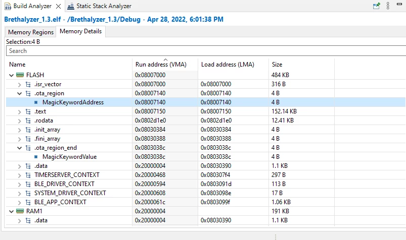

Problem statements & Test procedure
1. Application firmware seems working well and I can pair the BLE device with STBLE app
2. I can send the OTA reboot request from the STBLE app, and MCU also reboot from the application code
3. However the main issue is, "STM_OTA" ble unable to advertise!
4. After power reboot, it's advertising as a "STM_OTA"
5.when I'm trying to send the application bin from 0x7000 then it's downloading from the app seamless
6.However the main issue is, it's always rollback to OTA loader and advertise as "STM_OTA"!!

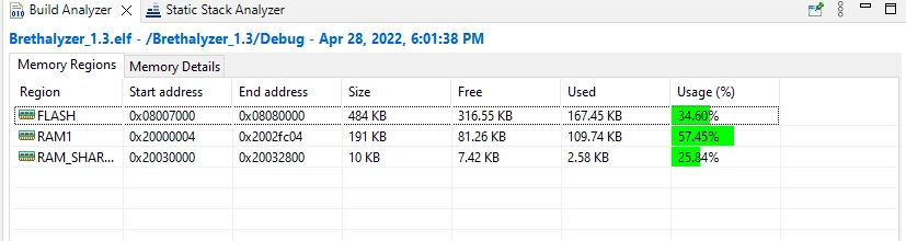

For the reference, here I have attached the linker script, Memory region & memory details screenshot
I'm using the Wireless FW version: 1.13.2 and FUS version: 1.2.0

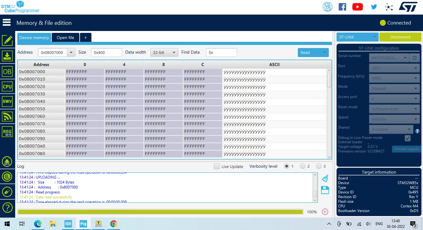

Mahendra Sondagar
Apr 30, 2022 8:22 AM UTC
Hi.. community
here is one more input
When I try to read the Flash memory from 0x08007000 after the OTA update cycle, its shows the empty flash at all

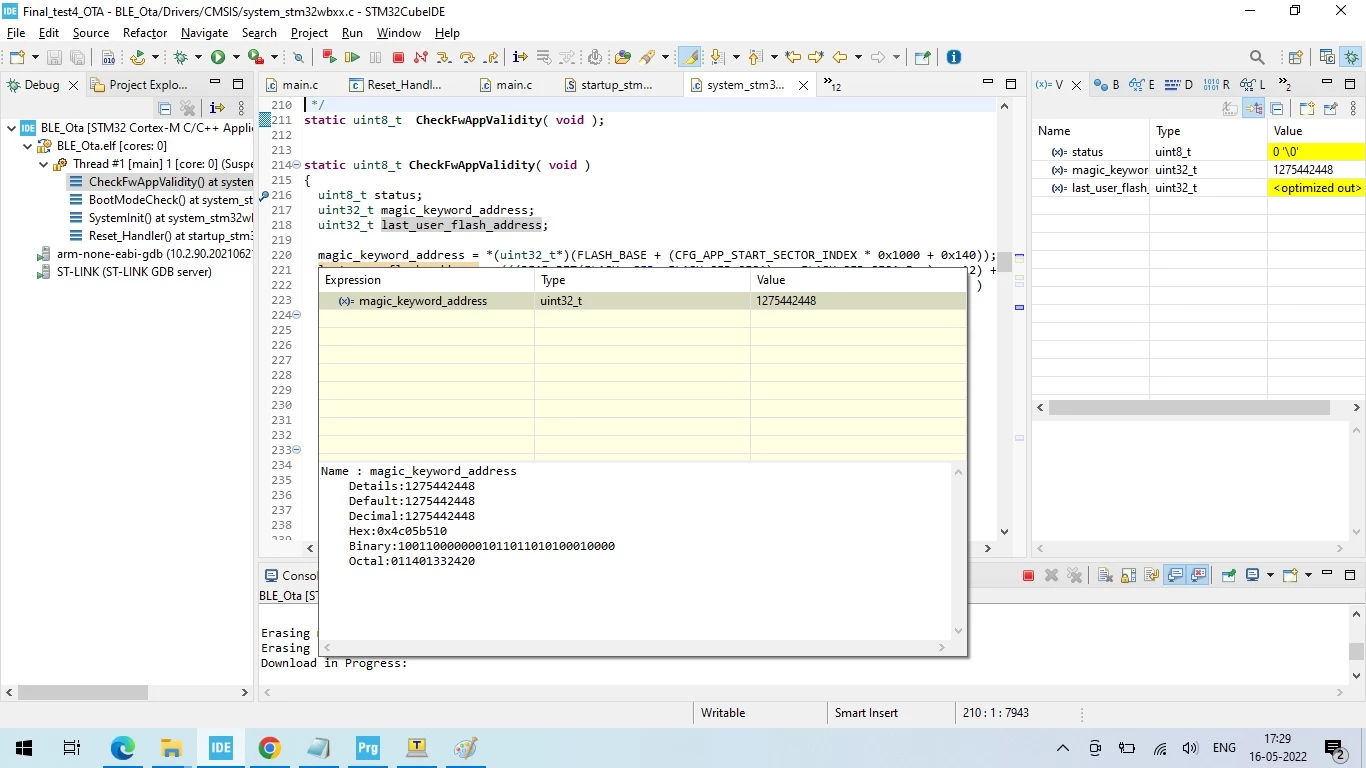

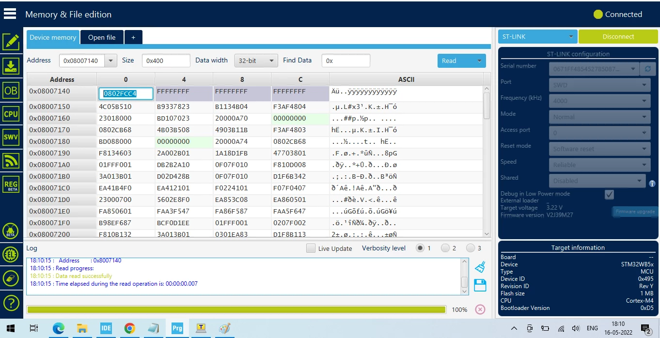

Mahendra Sondagar
May 16, 2022 1:02 PM UTC
Hi...@Remy ISSALYS​
Your above remedy works for me, and I can able to debug the OTA loader app
I have just set the break points as per the reference video, and I got to know that, it is the issue with the Magic No address. verification
When i send the reboot request for the OTA update from the app then, i can check the value of the CFG_OTA_REBOOT_VAL_MSG set to 1, which is as expected
Where as Magic No address seems odd, than what I'm getting from my custom application

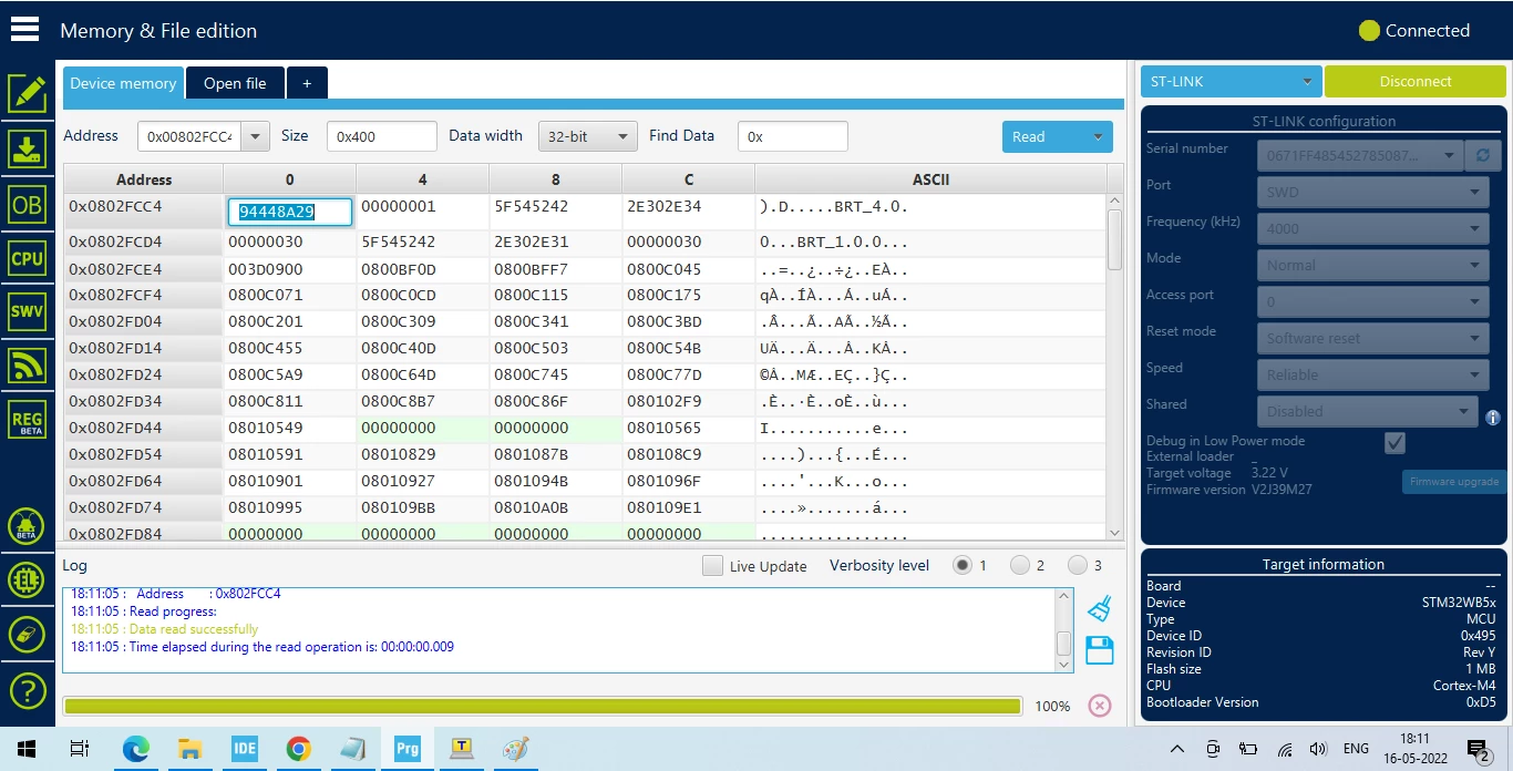

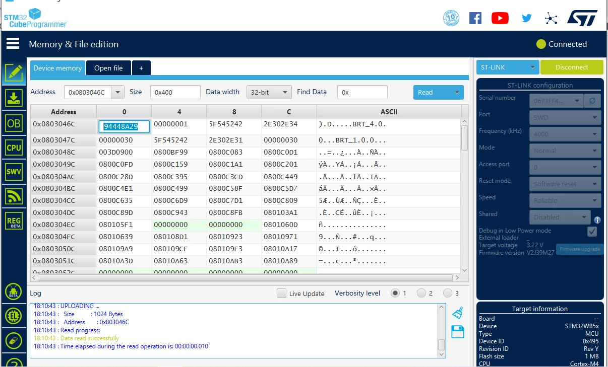

here, i have attached the screenshot from my custom app with using the cube programmer
As you can see from the above two screenshot
0x08007140 is the address at where the address of the magic no stored, which is 0x802Fcc4
In a second screenshot, you can see that at the address 0x802Fcc4 the magic no lies, which is 0x9448A29, which is as expected!
Now here the what i got after reboot at OTA loader app
The magic no. address seems 0x4c05b510 which is odd!
And that's how the magic no. address verification is failed
There is one thing that, i have notices during the OTA update via app
When I'm sending the OTA update request from the app then, instead of rebooting and directly pairing with the app i'll have to goes back from the app to find the "STM_OTA" ble device
And once again, i'll have to attach the file which i need to update!
Can you give me any hint, what's the wrong in it?
Thanks
Mahendra

And question - have you modified BLE_Ota project?
Mahendra Sondagar
May 18, 2022 8:29 AM UTC
Hi... @Greg_​
As I told the earlier, I have custom firmware which is just adopted from the P2P server app
I haven't modified anything with the BLE loader app
Here is the file that i have attached here
Thanks
