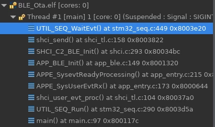

TBran.3
TBran.3Author
July 15, 2023
So when I issue the reboot command and it jumps into the OTA app, it seems to hang here. It's just idling waiting for an event it appears, so it never exits SHCI_C2_BLE_Init(), which means it never makes it to Ble_Hci_Gap_Gatt_Init(). Is this a bug in the OTA app or does this mean I haven't commanded the reset correctly somehow?

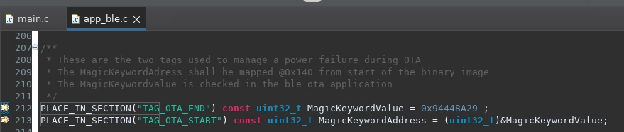

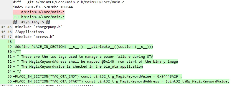

What is missing from your description and probably also from your code is the magic number used by the OTA application to verify that you have a good Firmware.
TBran.3
TBran.3Author
August 8, 2023
I have these, as long as I didn't make a typo somewhere.

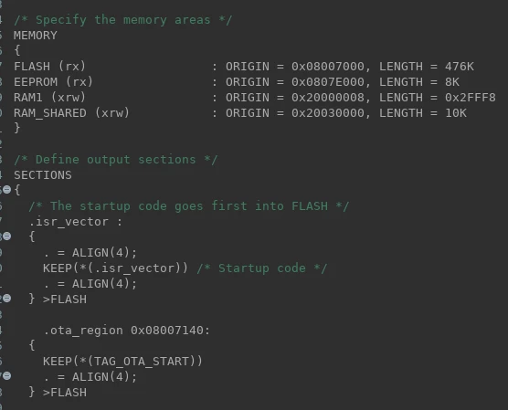

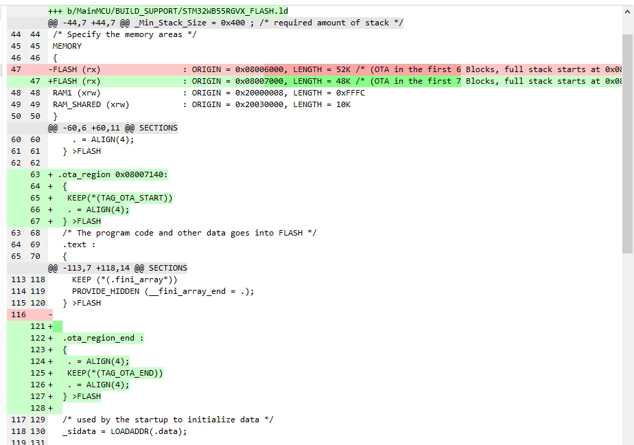

C definitions, in app_ble.c:
Linker file changes:
I'm attaching my entire linker file...

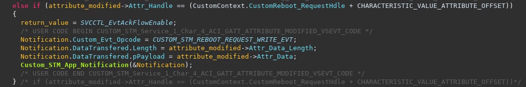

August 8, 2023
While I'm at it, here's the relevant sections from other parts of the code as well:
custom_stm.c, handling the incoming reboot request:
custom_app.c, actually processing the reboot request:
Interestingly enough, if I write a 0 to the reboot request characteristic, which corresponds to a request to reboot into the user application, that works correctly. It is only when I send 0x01 0x07 0x<num sectors> to enter OTA update mode that the OTA loader application hangs.
