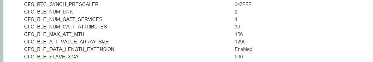

WSH
WSHAuthorBest answer
Aug 9, 2021 12:23 PM UTC
I figured it out! The Init struct must have the header. The reason why I was getting the memory error was due to the STM32WB10's limited memory capacity and an improper CubeMx setup.
For anyone using the STM32WB10, please note you are limited in GATT/GAP services you can initialize. The default CubeMx BLE setup will initialize BLE as if it's for the STM32WB55. You can look at the STM32WB15's sample project setup for the proper settings.
ERoja.2
Visitor II
Feb 11, 2022 5:58 PM UTC
Hi there, first of all ty for you help WSH,
You were right, i'm using the stm32wb15cc so as you appoint there's a bad configuration caused by the cube ide configurator, inside the file app_ble.c line 302, the function SHCI_C2_BLE_Init( &ble_init_cmd_packet ) returns a 0x07 as you stated before, so the way i was able to fix it was changing some default parameters in the WPAN configuration tab, here's a snapshot of the most important IMHO, there are others but i guess these are the most important because the stack size, so any way, checking all the parameters against the examples of wb15cc can solve the problem :)
Regards!
