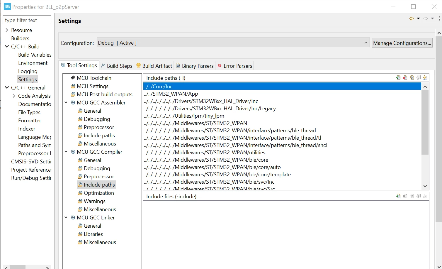

stm32wb error with drivers after building
Hello, I created a new project with STM32WB. I try to build a project but receive many errors for drivers. If I correctly understand I need to install drivers separately from - STM32Cube_FW_WB_V1.14.0? 0693W00000Uo7lYQAR.bmp

Maybe, you are missing some include paths in project settings, see the following screenshot:
Best Regards
