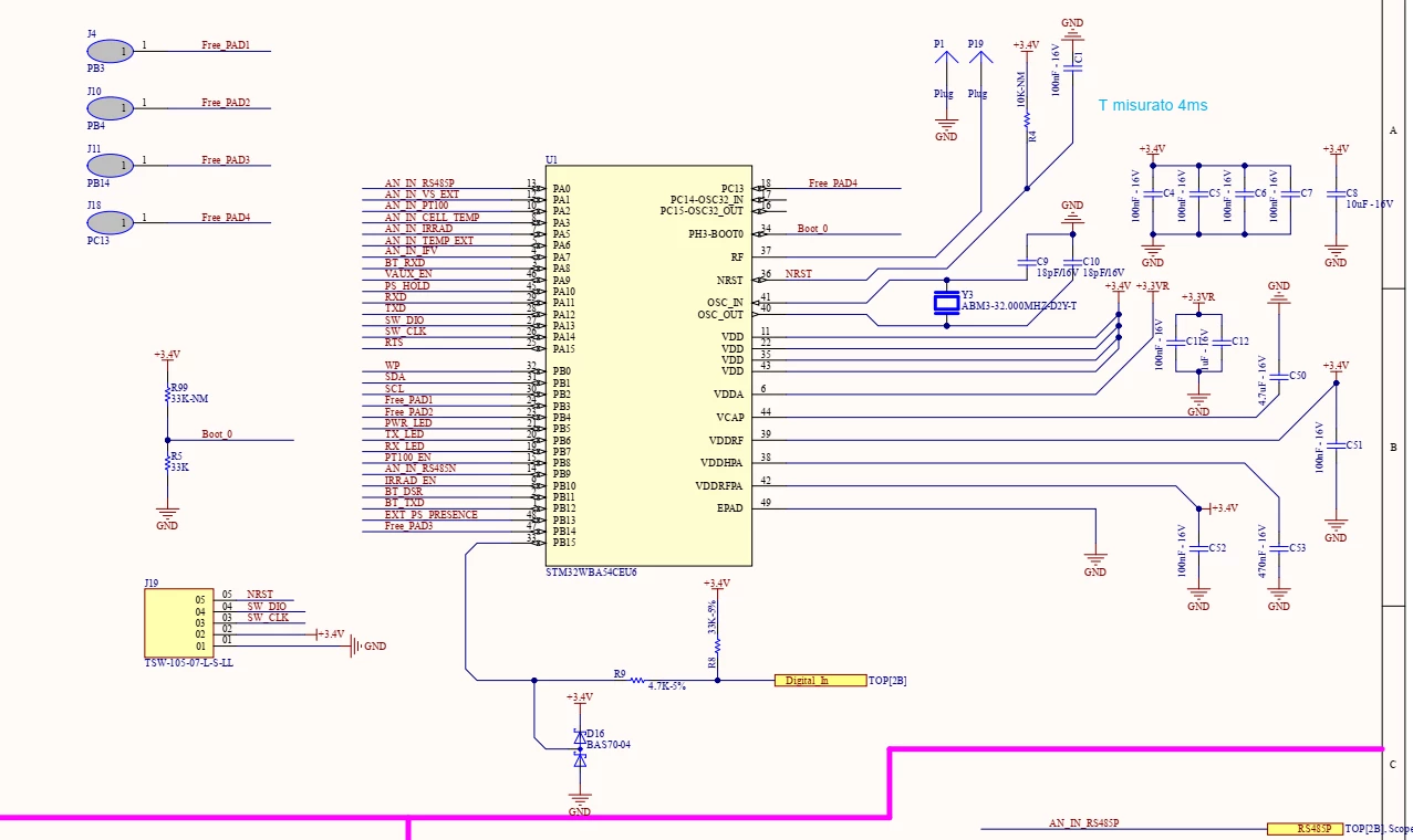

I have the same problem with custom board and  STM32WBA54CE (never happened before on any STM32F3, G4, H7, other ARMs M3, FM4, PIC16/24/32, dsPIC33, Renesas, Freescale, etc.).
I have pull-down at BOOT0 pin, all power supply pins (except VDDA) together by a 3.3V LDO, VDDA by 3.3 voltage reference.
100nF on NRST pin, originally using internal resistor, then 1K pull-up (has some improvements: power-up goes well 1 time over 4-5).
Checked rising time of supply: both VDD and VDDA go up in about 0.5ms (and same on NRST with external pull-up).
With a pulse on NRST starts well every time… so I’m thinking about adding a voltage monitor / reset IC… but shouldn’t it supposed to start well without any external help?

Visitor II
Aug 20, 2026 12:15 PM UTC
uC connections
Laurent LOUAZON
Aug 20, 2026 2:23 PM UTC
Thanks for sharing.
My comments:
- Can you please let me know Y3 exact reference?
We do recommend a 8pF load cap version.
In any case C9 and C10 must be removed. (frequency centering will be done through internal programmable capacitor bank)
- You are not using external LSE xtal.
This is fine but be sure FW is set accordingly.
See below wiki page
https://wiki.st.com/stm32mcu/wiki/Connectivity:HSE_and_LSE:_How_to_select_crystals_and_center_oscillators_with_STM32WBAx
You can find a reference schematics/layout for STM32WBA52 in QFN48 (pin to pin compatible with STM32WBA54) that might be useful.
I do not see RF matching/filtering.
Please refer AN5948 or reference schematics I provided.
Let me know if this helps.

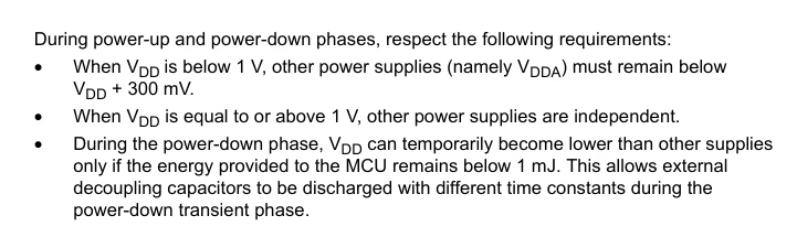

May I ask you to share plots for +3.3VR and +3.4V (on the same plot)?
I’d like to confirm below statement (page30 of datasheet) is respected.
Could you explain why you do have two different power domains?
Also you mention rise up is quite slow (500ms).
I guess you have no choice to change this behavior and confirm proper start if you fasten Vdd rise up time?
In the other hand, our datasheet does not mention limit for it (table42)
But I faced some cases in the past (was not STM32WBA) that a slow ramp up time can lead to “cross conduction” so that registers are not properly initialized).
If you share those information, I could try reproducing such conditions and confirm anu issue here.

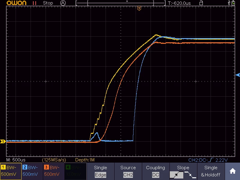

Visitor II
Aug 25, 2026 3:48 PM UTC
hello Laurent,
 0.5ms, not 500ms!
Actually is slighter longer, 1-1.5ms as you can see in the scope capture: yellow is +3.4V, orange is +3.3VR, cyan is NRST.
We use different power domain as VDDA will be used also as reference for ADC and so it comes from a voltage reference ( ADR366BUJZ, supplyed by the +3.4V). The main power supply +3.4V comes from a common LDO (MCP1824T-ADJE/DC).

Thanks for curves.
I do not see problem with your plots vs what we state in our doc (VDDA must remain below VDD+300mV when VDD is below 1V).
I will send you a private message to discuss your case.
