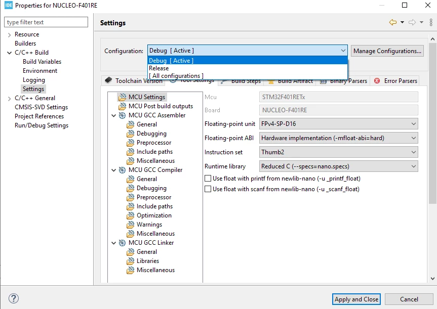

GBehe
Dec 28, 2020 2:01 PM UTC
Hi EJOHA.
You mean, as in the screenshot right? I could not understand the release type build configuration. Do you mean the run/Start up configuration?
Thanks.
EJOHA
Dec 28, 2020 2:35 PM UTC
I was thinking of the project Properties Build settings. Debug configuration normally builds the project with Debug information.

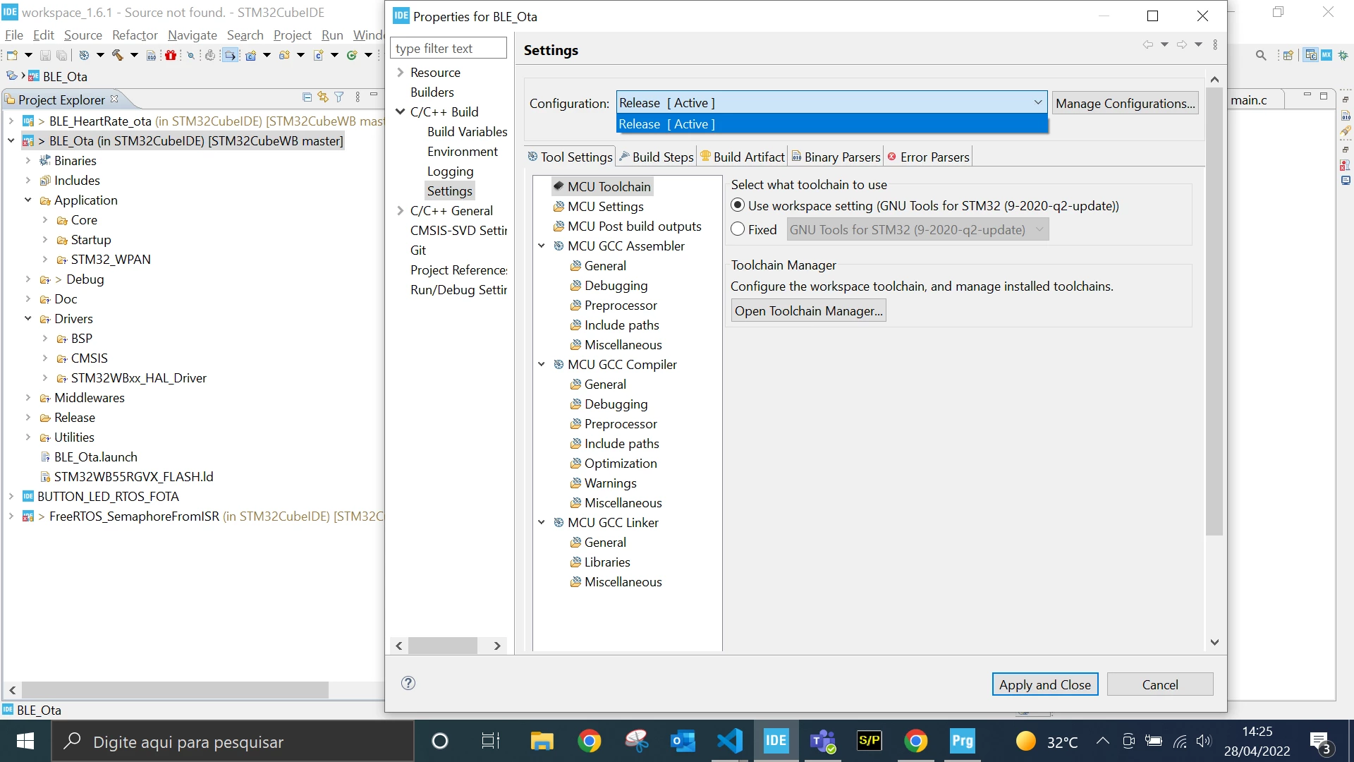

MRebo.2
Apr 28, 2022 5:25 PM UTC
Hi EJOHA.
I can't debug the BLE_OTA project, I noticed that there is no build option for debug, how do I get the project to be built in the debug version?
GBehe
Dec 28, 2020 3:20 PM UTC
Ohh. Thanks for showing it. I see both Release and a Debug build configuration as in screenshot.
What to do next?
Thanks.
EJOHA
Dec 28, 2020 5:21 PM UTC
OK! It seems fine and Debug configuration is the active one.
