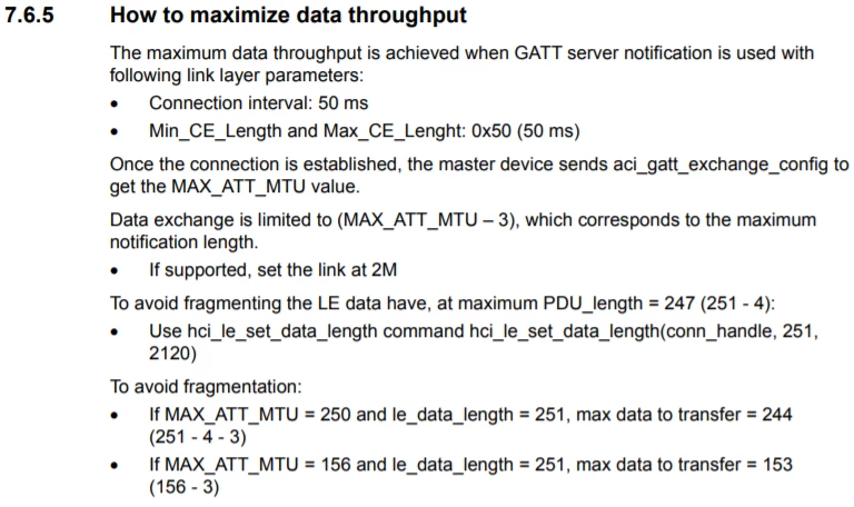

I then altered the code according to ST's AN5289 section 7.6.5 pasted below. I added to the button 2 callback to set the connection interval to 50ms. I changed DATA_NOTIFICATION_MAX_PACKET_SIZE in app_conf.h to 244. I changed hci_le_set_data_length to be (conn_handle, 251, 2120) in app_ble.c. CFG_BLE_MAX_ATT_MTU is already 250 in app_conf.h and changes upon connection.

Remi QUINTIN
August 20, 2020
The max throughput is achieved when the connection interval is set to 400ms. The value mentioned in the application note (50ms) is not the right value.
Regarding the low bit rate measured when the PHY is set to 2 Mbps, did you compile your code with 2 modifications in the app_conf.h file.
#define CFG_TX_PHY   2
#define CFG_RX_PHY   2
If not, please try again with these 2 changes and let us know.
in the end, both boards(Central and peripheral) should be close enough to achieve the highest throughput.
The throughput should be the same for both ways (periph-> central and central->periph).
You can check this in the debug trace of the peripheral.

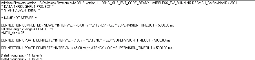

March 14, 2023
@Community member​ @Eason WANG​  could you please explain the steps to show those DT values on the gatt server terminal when using a board-smartphone connection?
March 20, 2023
@Eason WANG​ I'm also using STM32WBCube V1.13.3 on the nucleo board and LightBlue app on the phone. I get these results when writting Hello World to the charasteristic. I find them odd campared to yours.0693W00000aJJQPQA4.png
