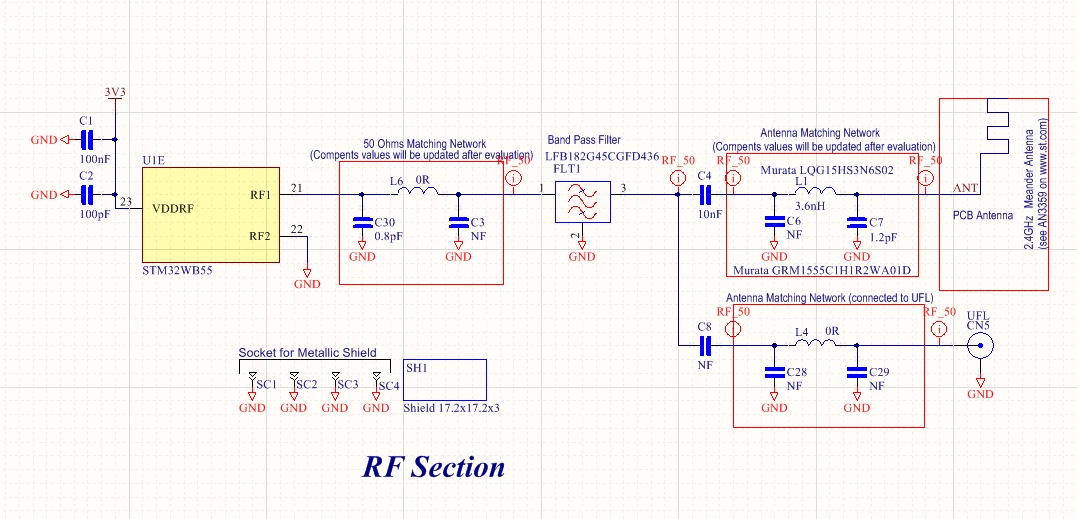

Hello Sir,
I am working on STM32WB. I am using the reference of STM32WB Dongle. The reference Dongle design used STM32WB55CGU6U MCU Part Number. I used STM32WB55CGU6 ( Without 'U') MCU Part. Bluetooth is not working with my PCB.
is there any Difference related to Hardware or Firmware?

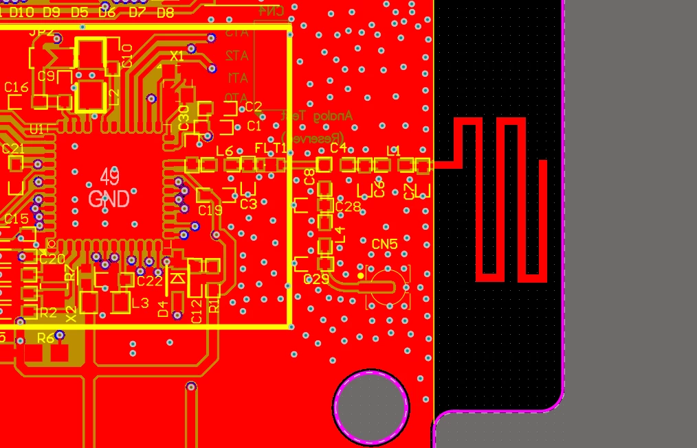

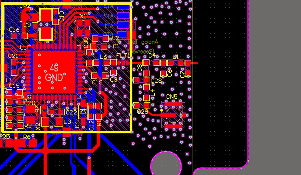

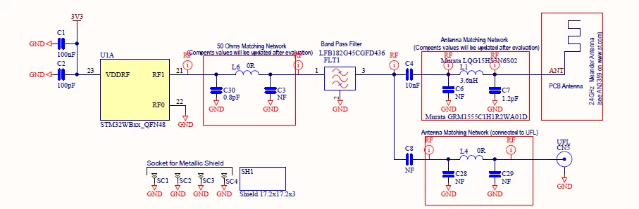

0693W000006EnbJQAS.jpg0693W000006EmRqQAK.pngHello ST Support Team,
Here is my Schematic and PCB Design.Please Suggest Changes or Testing Solution For it.
Reference Design : P-NUCLEO-WB55
Reference Link: https://www.st.com/en/evaluation-tools/p-nucleo-wb55.html
Thanks0693W000006EmS0QAK.pngSagar Kayasth

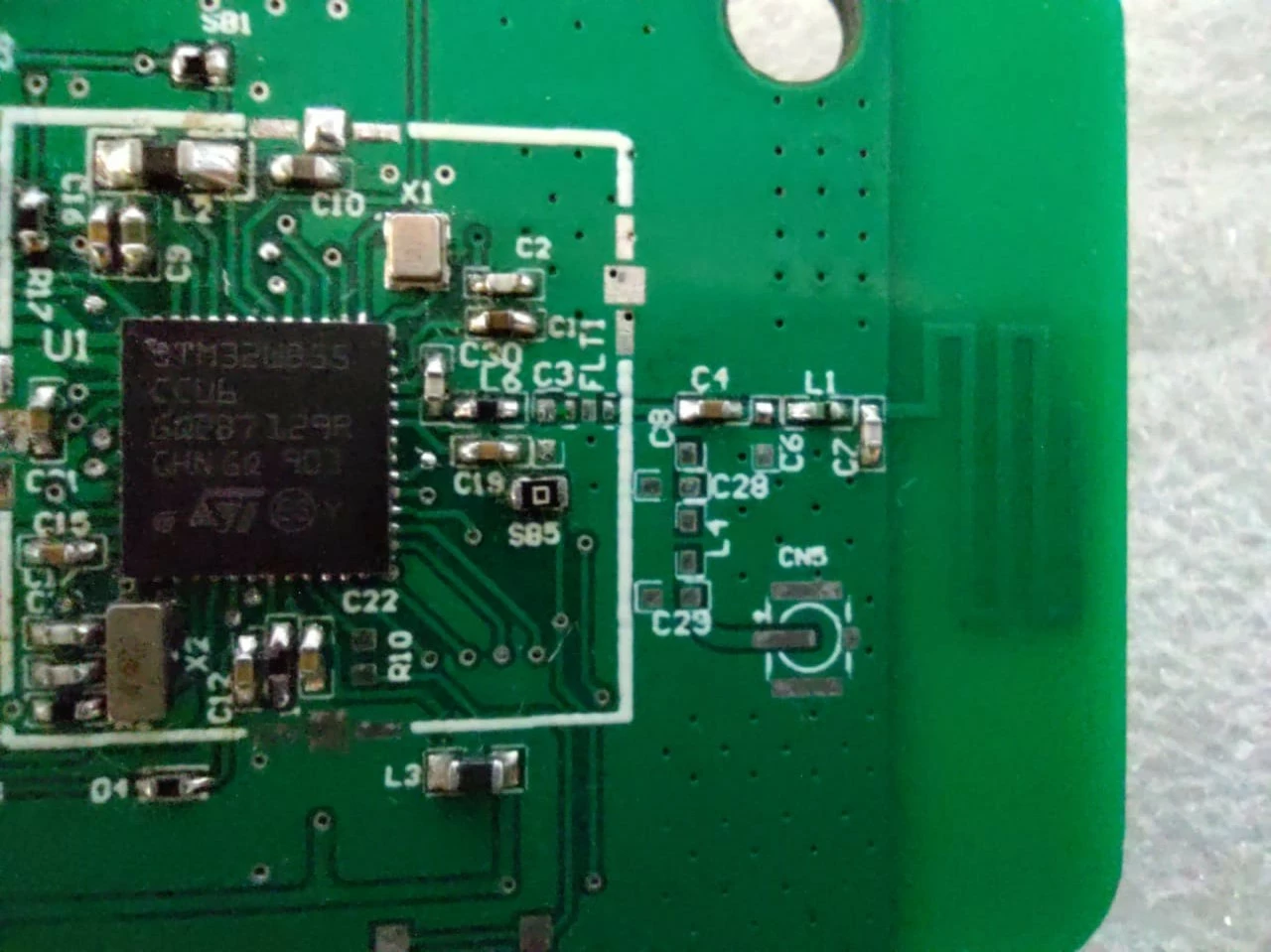

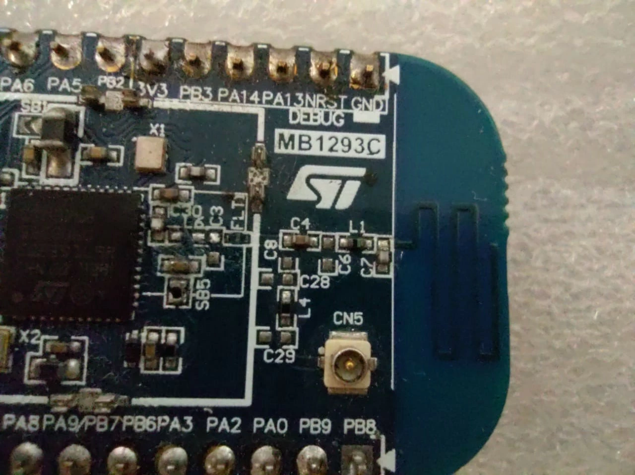

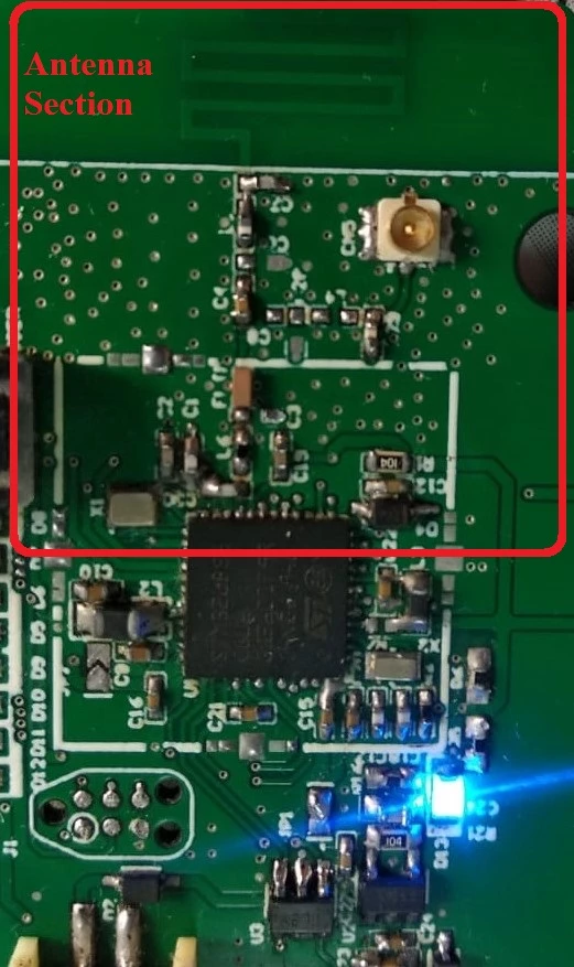

Hello ST,
Same thing is happening to me also, I had taken reference of MB1293 board that what I had put in my design too.
The only difference in the reference and my design is of MCU part no i.e., STM32WB55CGU6U (Reference board MCU) and STM32WB55CGU6 (Used in my design).
But the problem is that, in a reference board a band pass filter (FLT1) is not connected and that do so in my board too. And Reference board is getting Bluetooth signal but not in mine board.
So my question is that, after connecting the band pass filter(FLT1) my design should I able to receive a Bluetooth signal? Or have to change something in API?
If not, please suggest some solution for the same, if I have to change some thing in my design or else what you know about it.
Here I am attaching some images of reference board and my board along with the schematic.
Figure 1. Reference board.
Figure 2. My board.
Figure 3. Schematic.
0693W000006EwHRQA0.jpgFigure 1.
0693W000006EwHWQA0.jpgFigure 2.
0693W000006EwHgQAK.pngFigure 3.
Please Suggest some solution for this as I also looking from my side.
Thanks - Soham Mistry.
*Figure 1. Reference board.
Figure 2. My board.

Here are my PCB files for reference. Second layer is pored with ground PAD without cut below RF lines.

Super old thread, but I thought I'd post one possible answer.  You need to verify that you have loaded the correct BLE stack onto your processor.  If you don't have that on there, your own app code won't work correctly when you go to use the Bluetooth portion...
November 24, 2023
