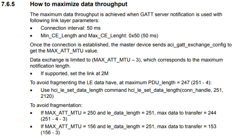

the BLE real troughput speed depends Heavily on the type of Bluetooth chipset your phone/tablet is using.
Im afraid this is a hardware limitation, figure out which chipsets are giving you the worst performance.
You will get the fastest performance out of the new phones with BLE5.2 chipsets which include PHY 2Mbps.
If you have control over packet sizes and conncetion interval you should set them as advised here:0693W000003OmFxQAK.png
https://community.st.com/s/question/0D53W00000ElwrQSAR/stm32wb-data-throughput-issues
