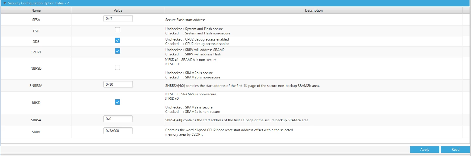

AbidSulaiman
April 10, 2019
yeah but it did costs hahah.
Here is the option byte page from CubeProgrammer. I didnt change anything from default (i guess).
And maybe one question, i thought that user should treat the CM0+ like a black box. Is it correct?
Thanks.
Regards.
April 10, 2019
You are correct, the CM0+ should be considered as a blackbox. I wanted to make sure the option bytes was still correct as you tried to make some CM0+ update.
According to what I can read, the option bytes are correct and the BLE Stack running on CM0+ should be working fine.
The last option byte that may break something is IPCCDBA (user option byte) that should be set to 0 (as long as you are using the delivered BLE application).
As long as the board was working fine with official BLE application and does not work anymore with the same official application, I believe something is wrong with the board or the board settings..
Regards.

April 10, 2019
IPCCDBA is set to 0. For your information, the new board have SBRV set to 0x30000. Tried change it on the faulty board, denied.
But yeah, the new board is working so maybe i should not worry about it until it doesnt work (hopefully it stays good).
Thanks for the reply. Really appreciate it.
Have a nice day.
April 10, 2019
​Hello,
To complete the information regarding option bytes, there is no way for the user to change any secure option bytes. These are fully controlled by the CM0+ on each update. The SBRV is aligned with the content of the CM0+.
On each CM0+ update, if the new wireless image is getting bigger, the SBRV will be updated accordingly along with the SFSA that reflects the secure flash boundary to secure more flash memory ( giving less memory to the application).
Regards.

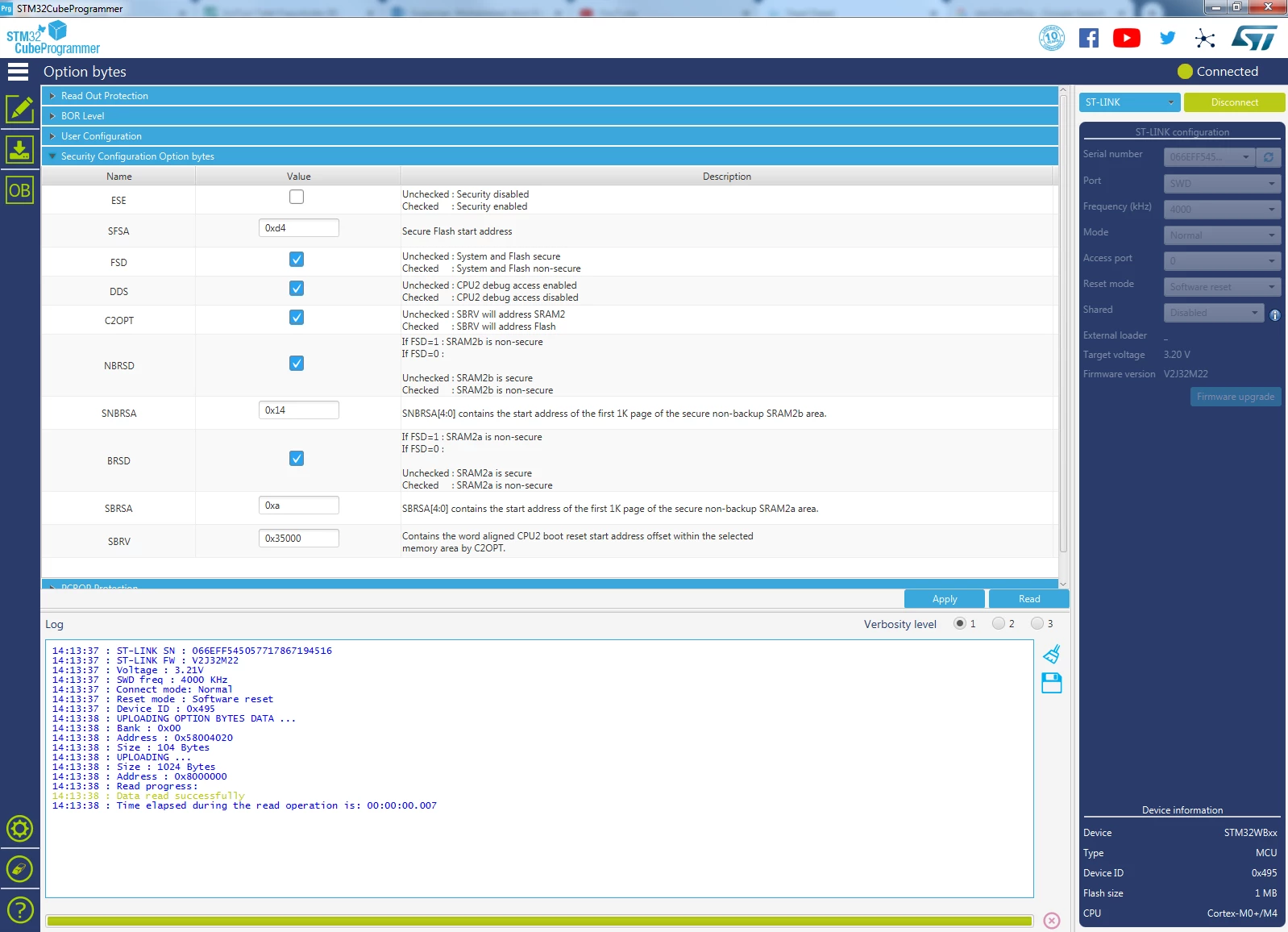

mnoro.1
February 20, 2021
I have also same problem on my custom board. It was working properly, but suddenly now it's BLE functions not working. The M4 core is OK, but APP_BLE_Init function return error and it fall in Error_Handler. When I checked the source of error, I reached to SHCI_C2_BLE_Init that return 0xFE. This error code is unknown.
I checked my board in STM32CubeProg. This picture shows option bytes of that:
0693W000007YzpfQAC.pngAny one can help me?
Thank you.
March 1, 2021
​Hello,
The secure option byte ( SBRV)  shows you are running on the FUS and (SFSA) shows that only the FUS code is made secure.
That means you do not have anymore a wireless stack and you are running the FUS.
You shall install a wireless firmware binary to get BLE application working.
I would expect you tried some CPU2 fimrware update at some points in time or you made some try with Cube Programmer and you unfortunately deleted the wireless firmware.
Regards.
mnoro.1
March 1, 2021
Thanks for your response,
By reprogramming BLE stack, now my custom board is working fine.
Thanks a lot
