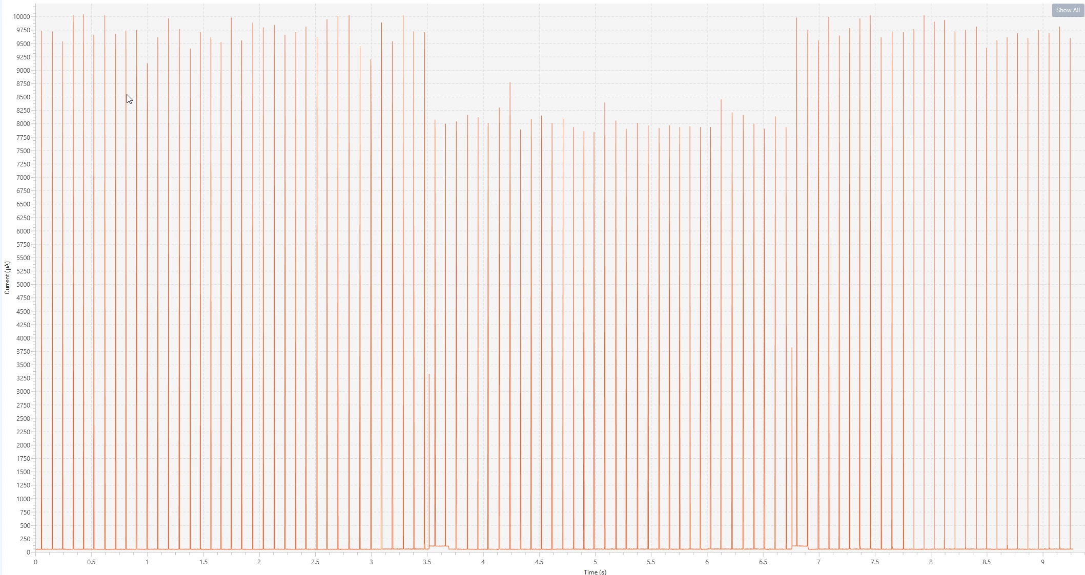

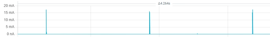

Hello, i am trying to reproduce this demonstration https://www.youtube.com/watch?v=7IVs-nuoXj8&t=439s on a custom WB55 board (WB55CGU6). In the video, the advertising consumes about 10 mA. In my case, it is close to 20 mA. Snímka obrazovky 2024-09-01 174150.png
I though changing the CFG_TX_POWER would help, but it does not change the consumption. How to actually set the TX power of the BLE transceiver? Getting the consumption down to 10 mA would really help.
#define CFG_TX_POWER (0x19) /* 0dBm */
#define CFG_BLE_MIN_TX_POWER (0)
#define CFG_BLE_MAX_TX_POWER (0)
There are 3 parameters in app_conf.h, which are a bit confusing and I wonder how they differ.

Using CFG_TX_POWER to adjust the output power should go without issue. But the most straightforward way is to use the aci_hal_set_tx_power_level(1, CFG_TX_POWER); function with a different second parameter. Here I switch between two levels in the p2p_server example.
You can search for the above function in the code generated for your project to verify that it is actually called with the correct CFG_TX_POWER parameter.
As for the difference between your consumption and what is achievable on a Nucleo - this is as STTwo-32 has said. It can depend on HW and the best way is to run you project on a Nucleo to verify this.
