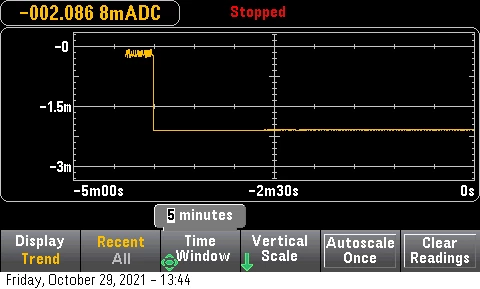

The current consumption is around 200uA during advertising.
But when the advertising stops the current goes up to 2.0 - 2.5mA

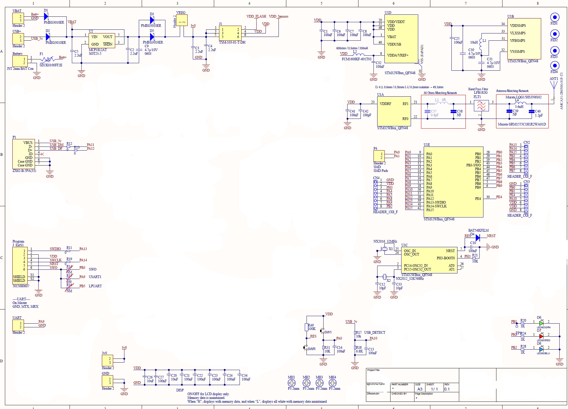

The board is custom designed by me, and all the IO ports are electrical disconnected to any other parts of the board. the oscillators and components are taken from a WB55 dev board from ST.

Here is the schematic.

but as soon I call the aci_gap_set_non_discoverable(); the MCU current goes up to 2.0mA

but when I trigger the Adv_Cancel. All LEDS are blinking -> means that Core2 is running!!
And the consumption is 2mA
What can I do to make sure core 2 is in stop mode ??
The BLE is not visible anymore after Adv_Cancel() is called.
