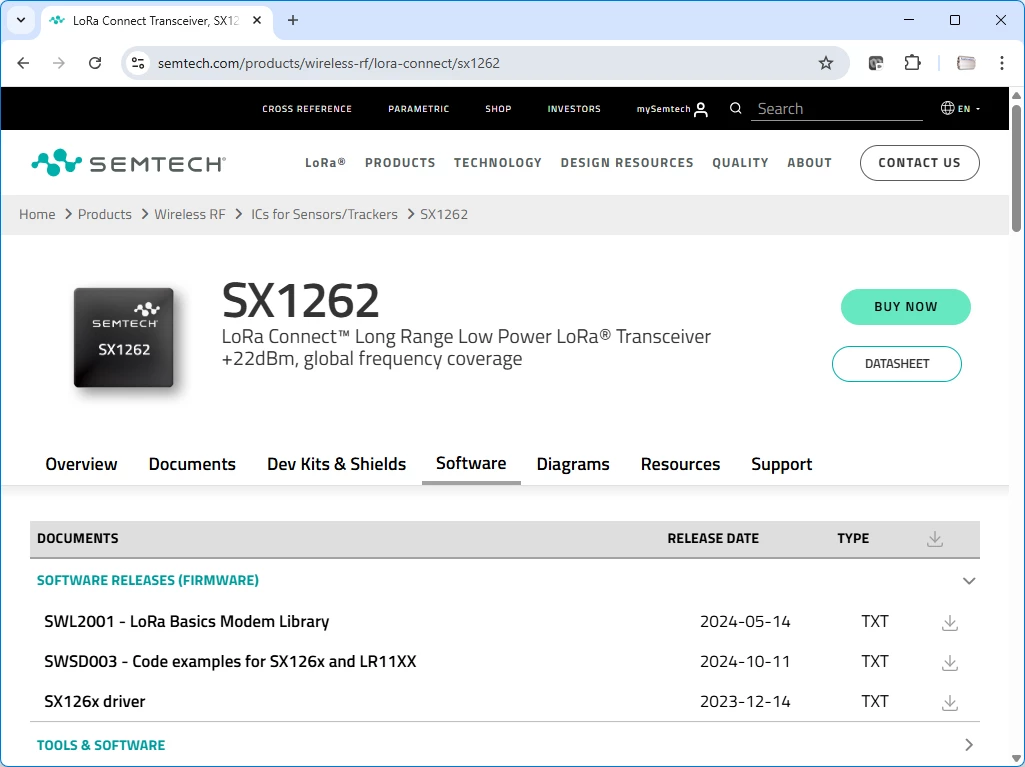

Semtech provide hardware-independent software on their Product Page:
https://www.semtech.com/products/wireless-rf/lora-connect/sx1262

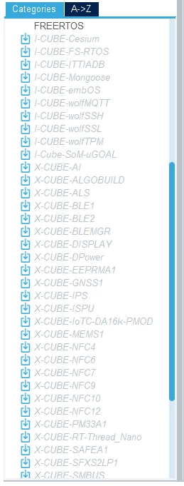

I'm having trouble adding I-CUBE-LRWAN; it doesn't appear in the options:

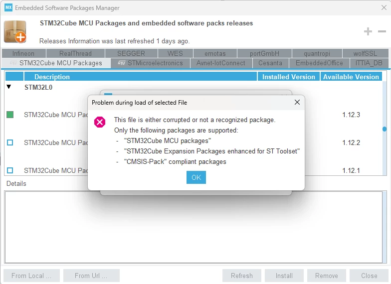

I tried manually adding the .zip file, but got the following error:
Does I-CUBE-LRWAN support STM32L031 family microcontrollers?
Probably, it supports others in the L0x range, I've seen L07x
I do however anticipate it creating something too big, and a build for the L07x should illustrate this quickly enough. Those parts have 192KB of FLASH in the Murata parts, it doesn't use all that, but I'd suspect a LoRaWAN build with any Hash or Crypto would get a foot-print larger than 32KB
