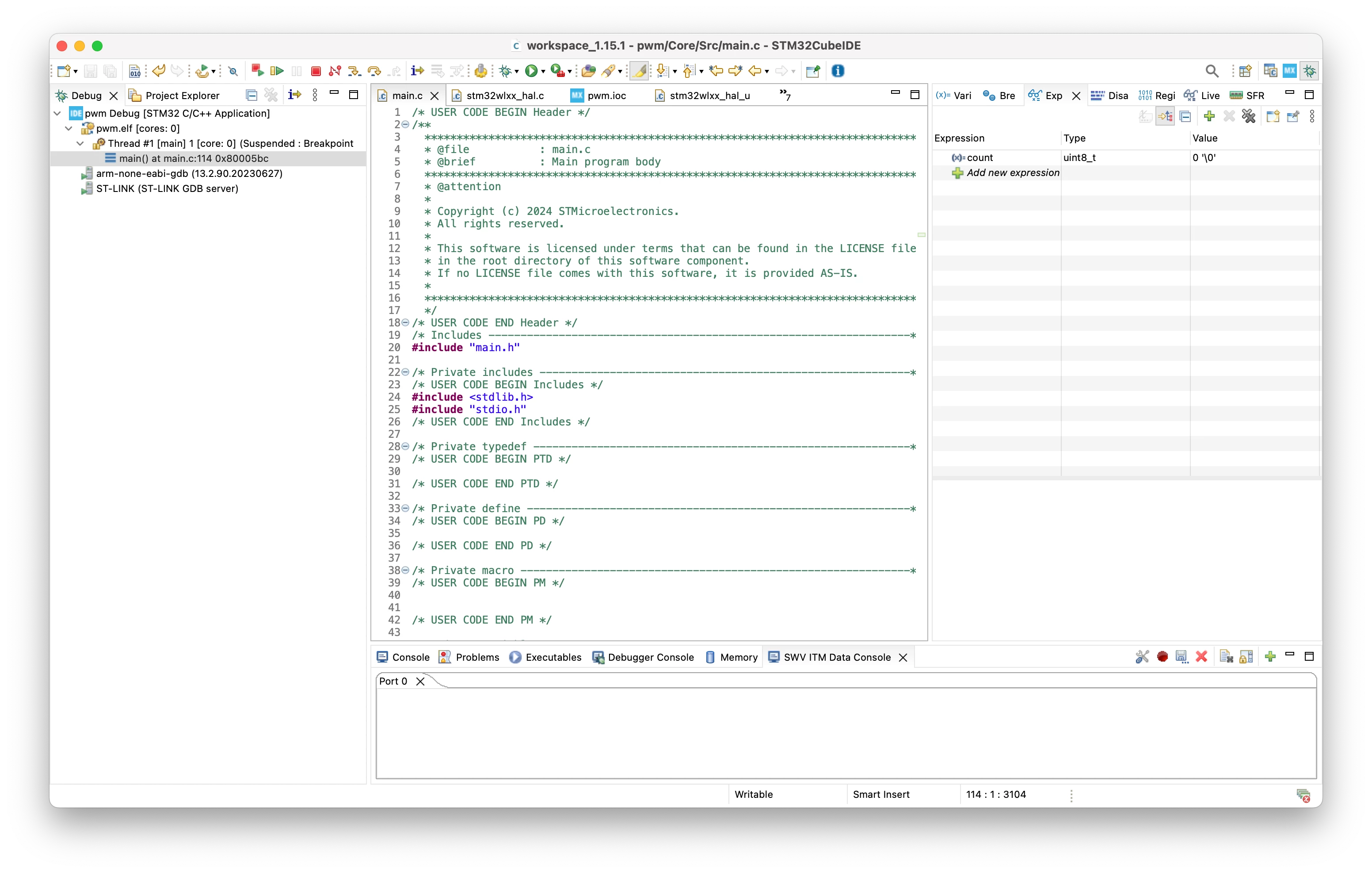

I'm new to STM programming. I have set up everything and I'm able to load the program to the board. but when I'm trying to print some lines to the SWV data console, nothing is getting printed. I have used the example UART printf program that is given by the example of ST projects.

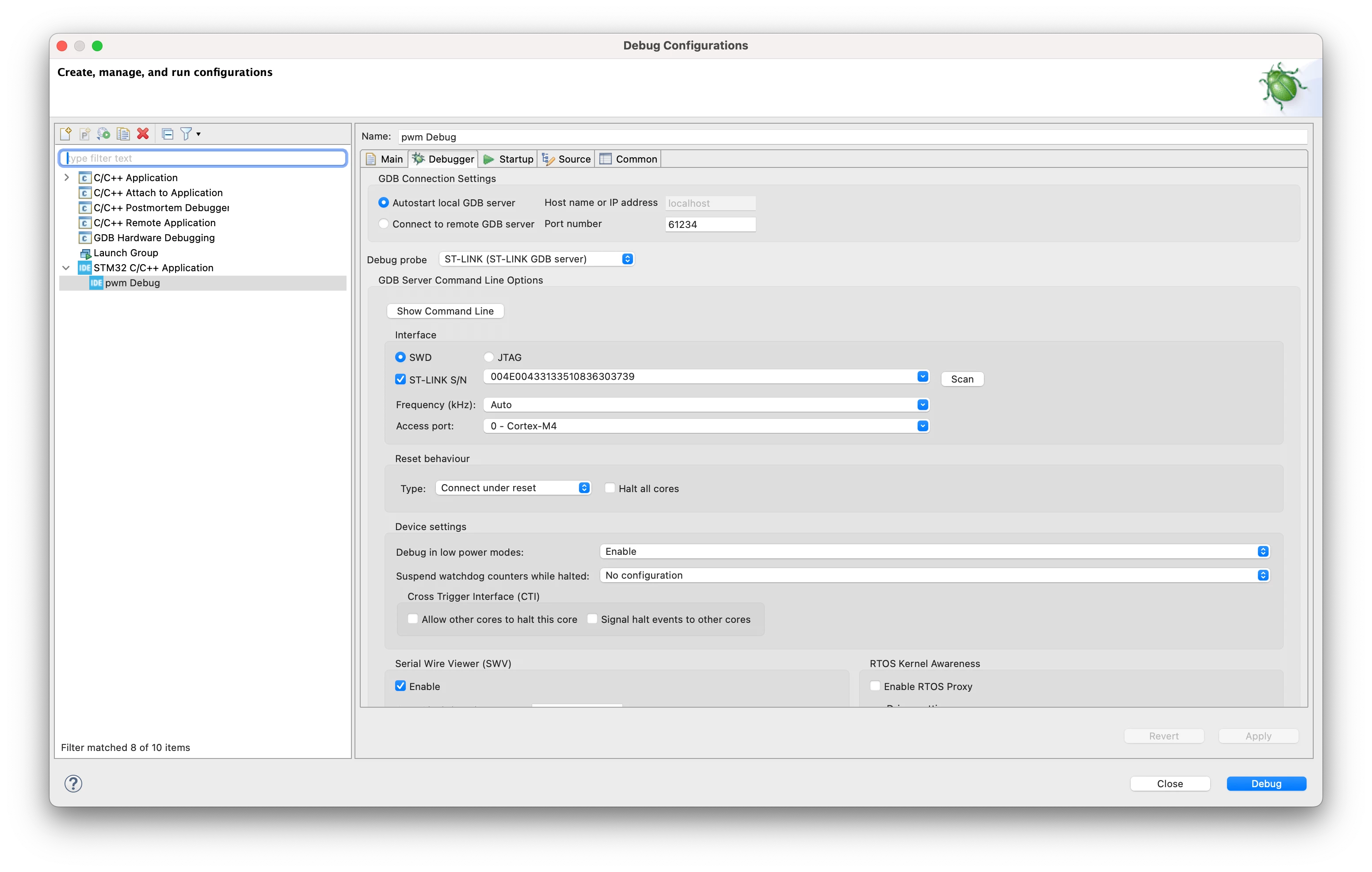

I'm using STLink and below is my configuration for debugging.

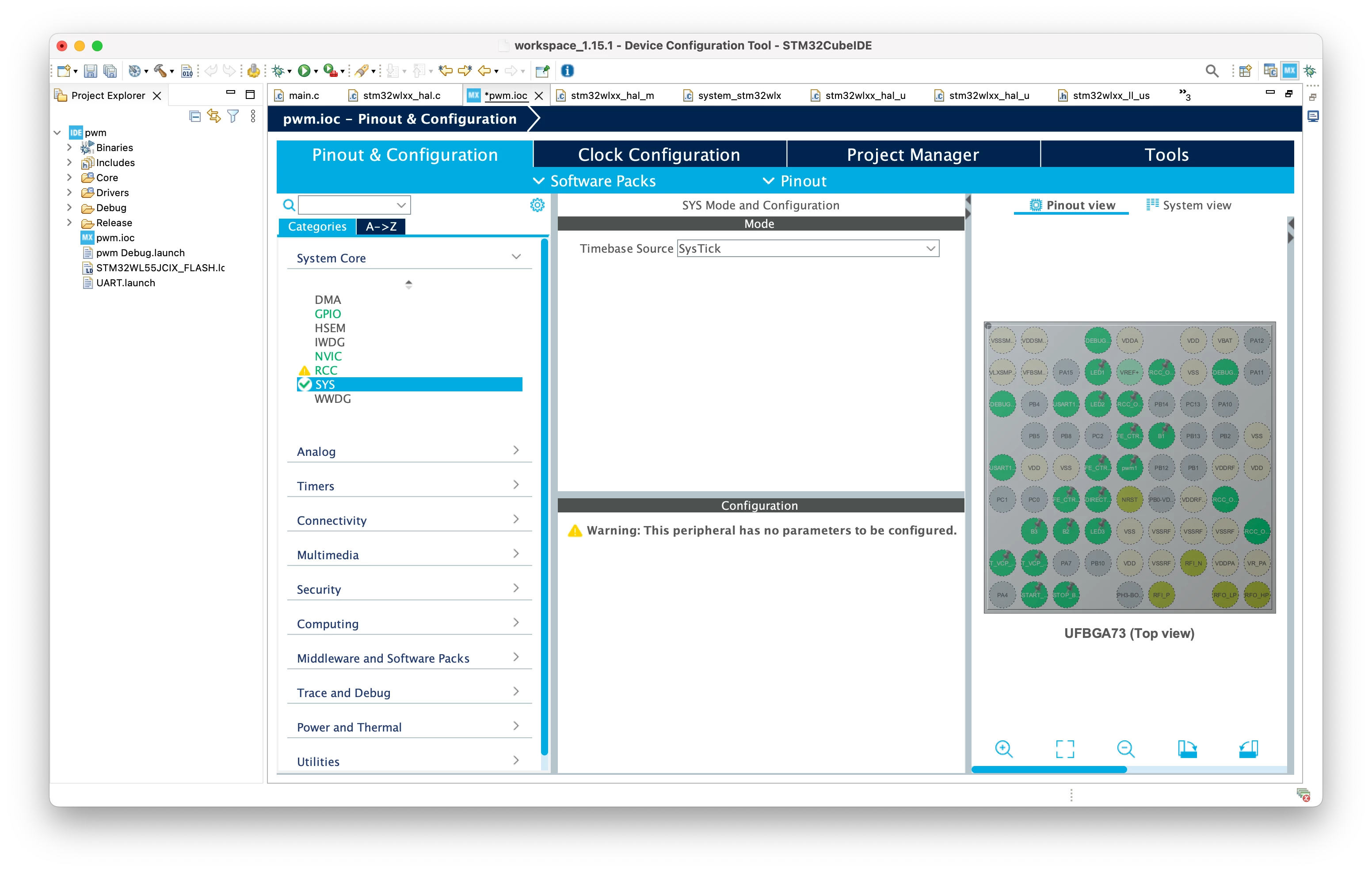

in the .ioc file I'm not able to see the debug option in sys section
this is how I'm getting the debug screen. no error but no prints are coming on the swv data console

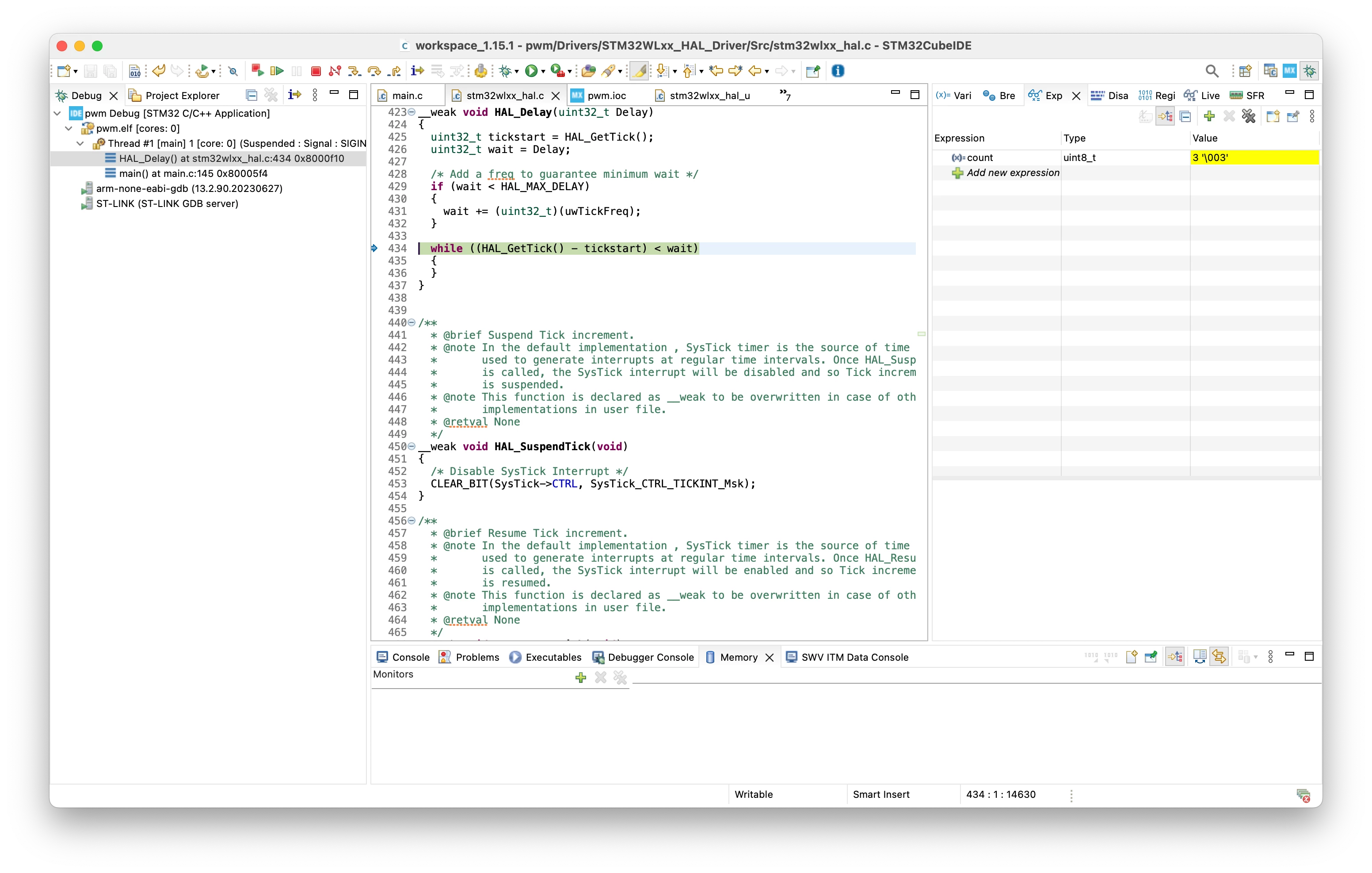

as we can see the count value is changing. but that is not getting printed.

1. set swo active in debug

For the Debug option, is available on the .ioc file under the category "Trace and Debug".
