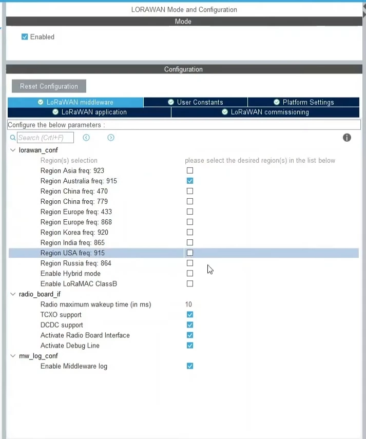

There some limitations/issues with the generation of the LoRaWAN/Target/radio_conf.h
The template radio_conf_h.ftl is hard coding key values in a way that does not preserve user set values.
The following lines are of concern:
#define XTAL_DEFAULT_CAP_VALUE      ( 0x20UL )
#define TCXO_CTRL_VOLTAGE           TCXO_CTRL_1_7V
#define DCDC_ENABLE                 ( 1UL )
It would be useful if these values could be set via the IOC file or, alternatively, be protected from modification in the case of code regeneration.
Noting that the DCDDC_ENABLE value may be redundant as there is an IS_DCDC_SUPPORTED symbol in the radio_board_if.h file.
2 replies
Issamos
September 4, 2023
Hello @Andrew Larkin
I share the same opinion about this topic. it will be better to integrate those lines in CubeMX and make them protected.
For now, cube Mx just give as this interface:
hope the next version will give as some more control.
Best regards.
