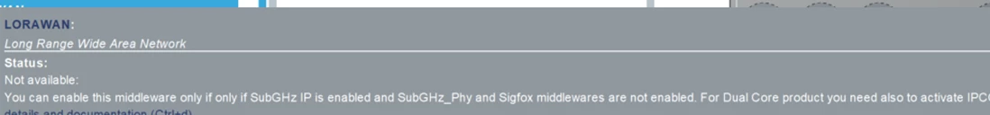

Souan.1
Visitor II
Apr 25, 2022 8:52 PM UTC
hello werewolf can you please share a tutorial on how this is done, i'm stucked on the dual core lorawan as well, im not even able to build , the middleware Lorawan is not available even thought IPPC is enable :dizzy_face:
werwolv98
werwolv98Author
Apr 26, 2022 7:25 AM UTC
Hey
You need to make sure that the SubGHZ and IPCC module are both enabled. Otherwise LoRaWAN is unavailable.
