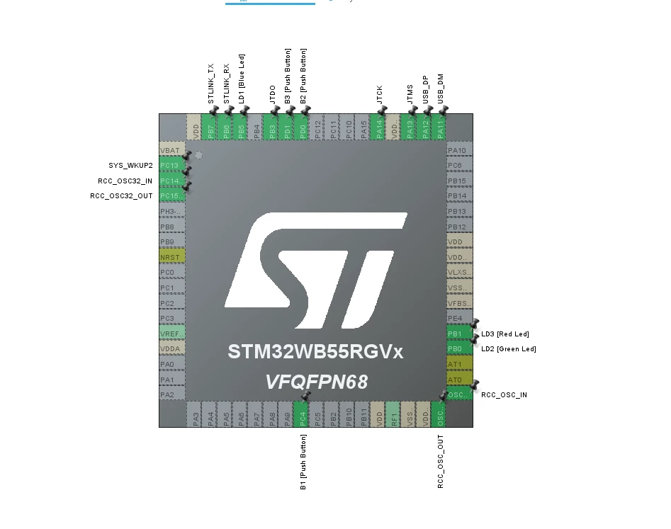

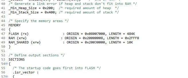

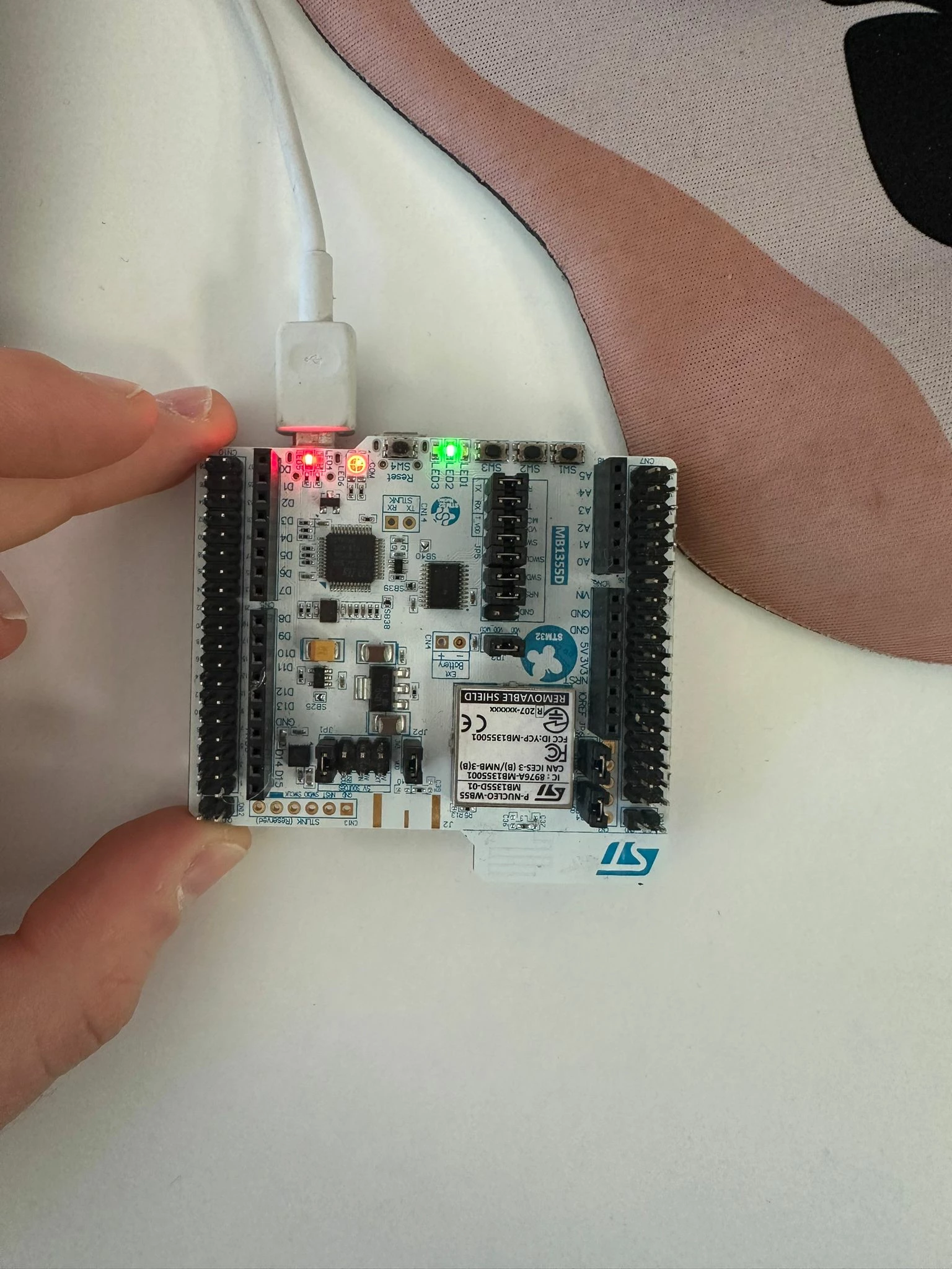

I am trying to make a project for firmware update using OTA with ST BLE Sensor Classic on IOS device but I have a problem I watched the videos and try to understand how can I create a project for fimware update. I started with an easy one I run BLE_OTA on WB55RGV6 than I write a simple blinking led application change the flash address at .ld file
Than export the .bin file and try to update but it does not working. I try to update the examples that ST produced they are working perfectly but they don't have ioc files in it so I don't know what should I specificly do in IOC file. Can anyone help me with my project? I am trying to understand how can I make an OTA firmware update. I checked the P2Pserver_OTA but I couldn't understand how does it work clearly.

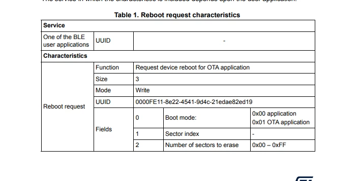

I have another problem. I made it as an OTA application and when I upload BLE_OTA application on my board, I am able to flash my firmware once. However, I don't understand how can I reboot my system and turn back to BLE_OTA partition from my application partition. I need unlimited firmware update continuously.
In here you can see the reboot characteristics. I create one but what should I add to my code to activate it in document it is not explained well and detailed. Could you help me with it?
