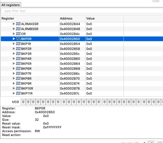

We're faced to an issue in the RTC module. RTC registers: time, date and backup register aren't saved after power off ( we measured the VBAT supply is about 3v given by the supercapa), we used a magic number to ensure that data aren't reinitialized at each software startup:
/** Initialize RTC Only
 hrtc.Instance = RTC;
 hrtc.Init.HourFormat = RTC_HOURFORMAT_24;
 hrtc.Init.AsynchPrediv = CFG_RTC_ASYNCH_PRESCALER;
 hrtc.Init.SynchPrediv = CFG_RTC_SYNCH_PRESCALER;
 hrtc.Init.OutPut = RTC_OUTPUT_DISABLE;
 hrtc.Init.OutPutPolarity = RTC_OUTPUT_POLARITY_HIGH;
 hrtc.Init.OutPutRemap = RTC_OUTPUT_REMAP_NONE;
 if (HAL_RTC_Init(&hrtc) != HAL_OK)
 Error_Handler();
 /* USER CODE BEGIN Check_RTC_BKUP */
 if(HAL_RTCEx_BKUPRead(&hrtc, RTC_BKP_DR0) == 0x55AA)
 // Time and Date are OK
 return;
 /* USER CODE END Check_RTC_BKUP */
 /** Initialize RTC and set the Time and Date
 sTime.Hours = 18;
 sTime.Minutes = 4;
 sTime.Seconds = 0;
 sTime.SubSeconds = 0x0;
 sTime.DayLightSaving = RTC_DAYLIGHTSAVING_NONE;
 sTime.StoreOperation = RTC_STOREOPERATION_RESET;
 if (HAL_RTC_SetTime(&hrtc, &sTime, RTC_FORMAT_BIN) != HAL_OK)
 Error_Handler();
 sDate.WeekDay = RTC_WEEKDAY_THURSDAY;
 sDate.Month = RTC_MONTH_JUNE;
 sDate.Date = 20;
 sDate.Year = 24;
 if (HAL_RTC_SetDate(&hrtc, &sDate, RTC_FORMAT_BIN) != HAL_OK)
 Error_Handler();
 /* USER CODE BEGIN RTC_Init 2 */
 HAL_RTCEx_BKUPWrite(&hrtc, RTC_BKP_DR0, 0x55AA);
Can you please give us some suggestions.

Hello @freecoder,
This is probably a hardware issue...
If VBAT drops below 1.55V, the backup domain won't function correctly, so the RTC register content will be lost;  are you sure the Vbat level is stable? can you share how VDDA/VREF+ is exactly connected?
