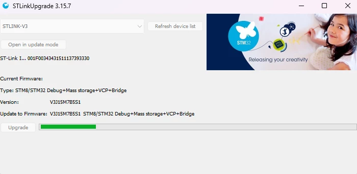

I am able to see it on the STLink Upgrade utility which is in the cube ide.
Could it be because the ST-link chip is working fine but something is wrong with the microprocessor?

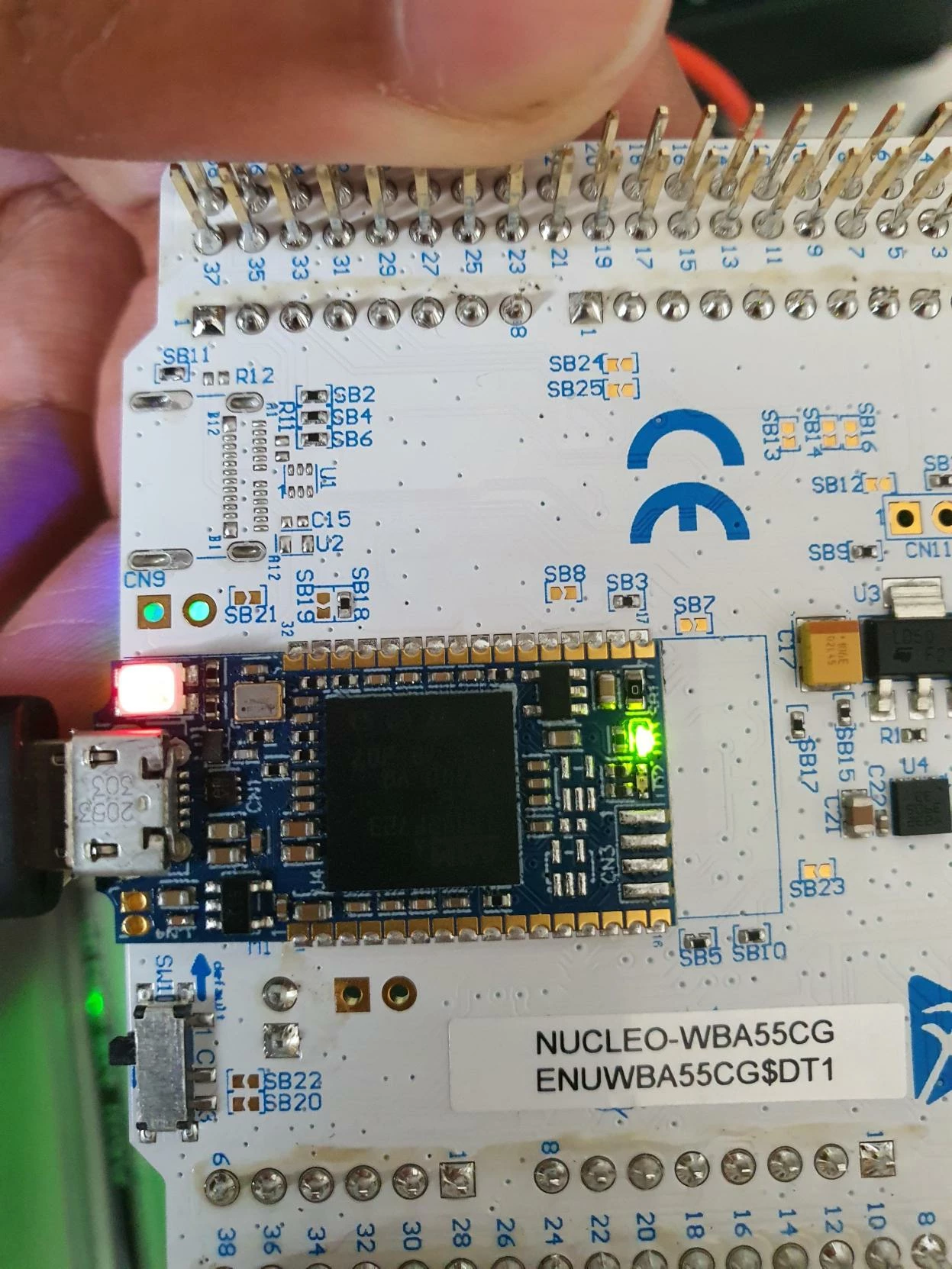

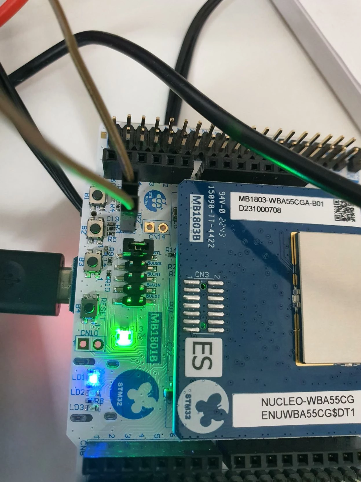

I can confirm my JP2 and JP1 jumpers are on. I have attached some additional pictures to this.
I am using cube ide for this project, you can see through that, i am able to program up the stlink chip

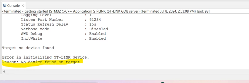

When it comes to flashing it says no device found on target. i can confirm that my reset configuration is "Connect under reset"
