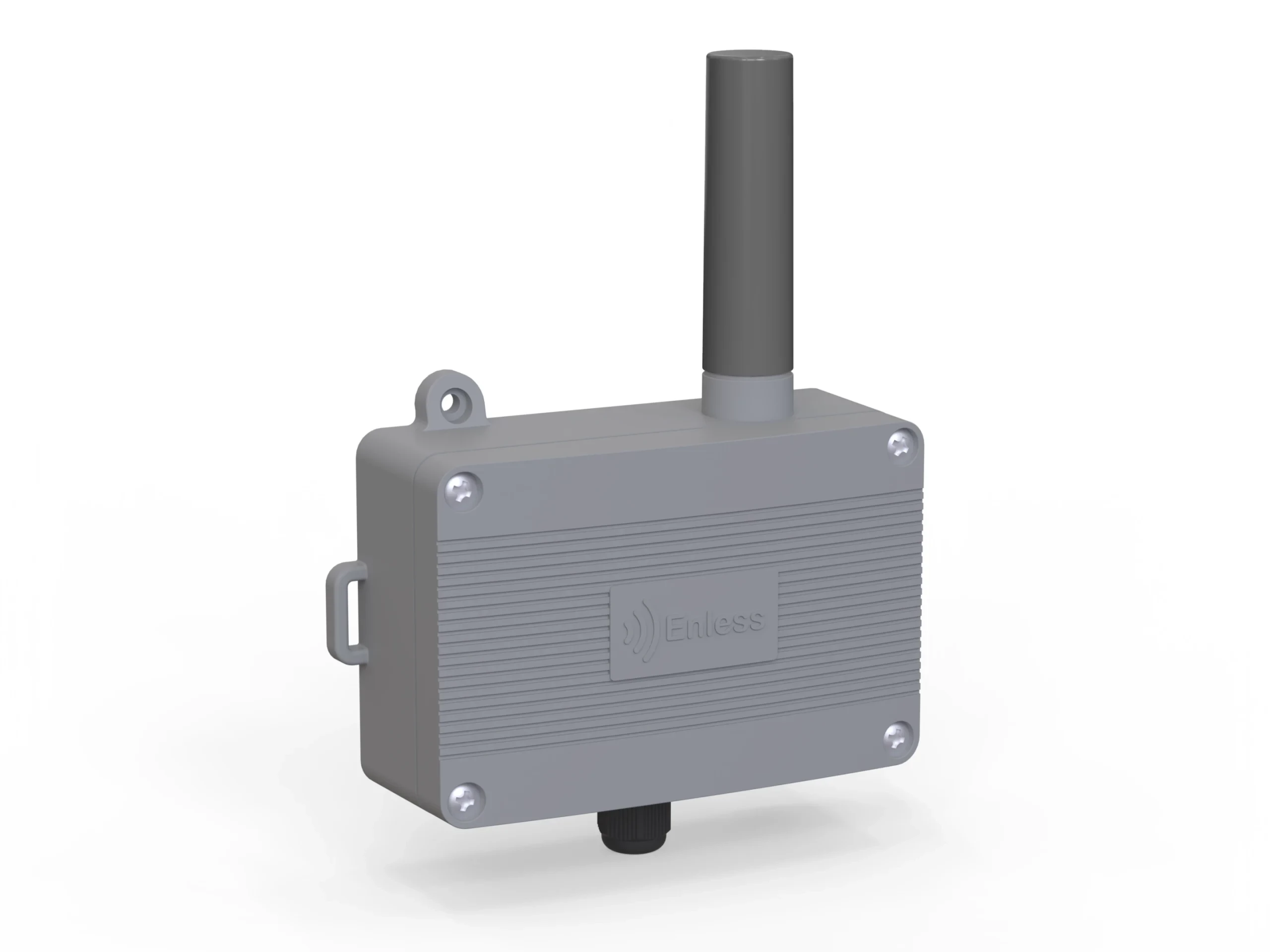

Andrew Neil
Nov 28, 2025 11:20 AM UTC
Not sure what you mean by "STM32-compatible End Devices and Gateways" here ?
You seem to be talking about off-the-shelf manufactured products - this sort f thing:
AndrewNeil_1-1764328580393.pngAndrewNeil_2-1764328620916.pngAndrewNeil_3-1764328690599.png
Yes?
But these kinds of products would just use standard interfaces - UART, SPI, RS485, CAN, etc, etc - so nothing specific to any particular microcontroller or processor.
Or are you asking if any of ST's chips supports LR-FHSS - to build your own product from component level?
