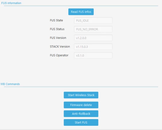

My FUS infos are :

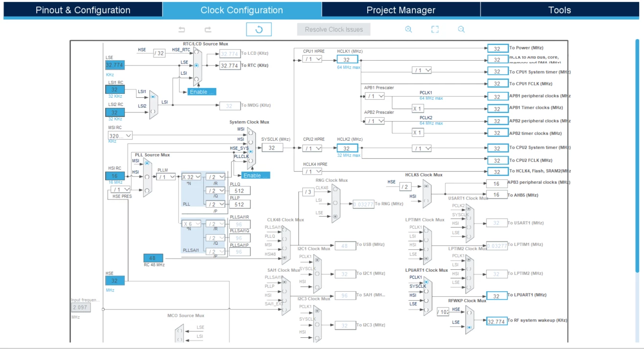

And my clock tree:
0693W00000aHPT6QAO.pngI also try to follow the step describe in the STM32WB_Getting_Started_with_CubeMX_for_BLE_V07 PowerPoint that I attached but no luck as well.

My code get stuck in the APP_BLE_Init() {app_ble.c} waiting for CPU2(Cortex-M0+) to start the BLE stack :
 * Starts the BLE Stack on CPU2
 status = SHCI_C2_BLE_Init(&ble_init_cmd_packet); /* Waiting for ever here */
 if (status != SHCI_Success)
 APP_DBG_MSG(" Fail : SHCI_C2_BLE_Init command, result: 0x%02x\n\r", status);
 /* if you are here, maybe CPU2 doesn't contain STM32WB_Copro_Wireless_Binaries, see Release_Notes.html */
 Error_Handler();
 else
 APP_DBG_MSG(" Success: SHCI_C2_BLE_Init command\n\r");

I found out that no BLE Stack was running on CPU2 (Cotex-M0+).
I solve this issue by:
Step1: updating the BLE STACK to the last version (STM32Cube_FW_WB_V1.15.0\Projects\STM32WB_Copro_Wireless_Binaries\STM32WB5x\stm32wb5x_BLE_Stack_full_fw.bin) at the corresponding address (check the release note according top your exact STM32WB55xx).
Step2: Start the Wireless Stack (I use STM32CubProgrammer to achieve this).
After that everything's work flawless.
Hope this will help,
Regards,
Axel.
Note: AN5185 was very usefull (https://www.st.com/resource/en/application_note/dm00513965-st-firmware-upgrade-services-for-stm32wb-series-stmicroelectronics.pdf)
