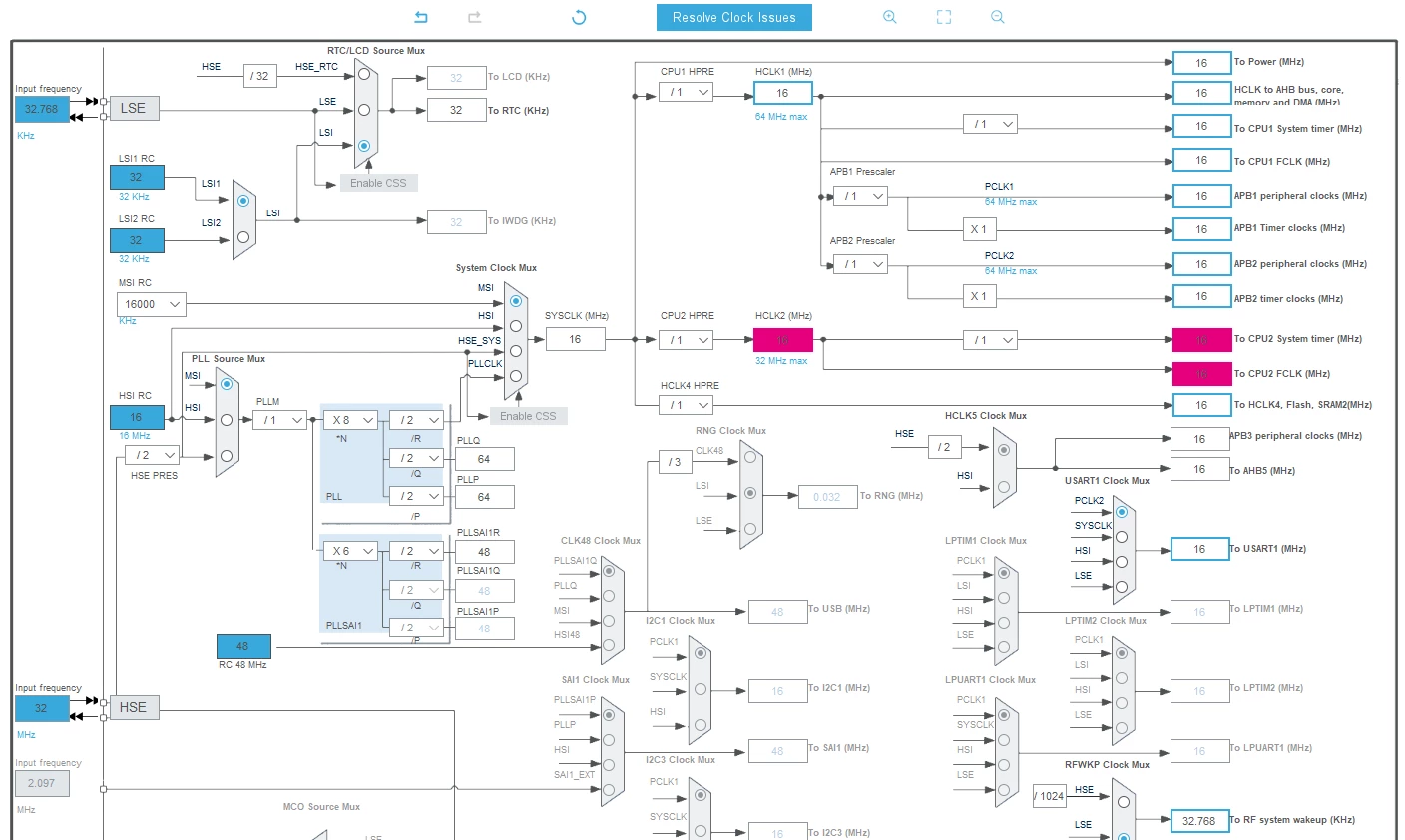

I'm trying to use Range 2 mode in my custom STM32WB55 board to reduce power consumption in my board.

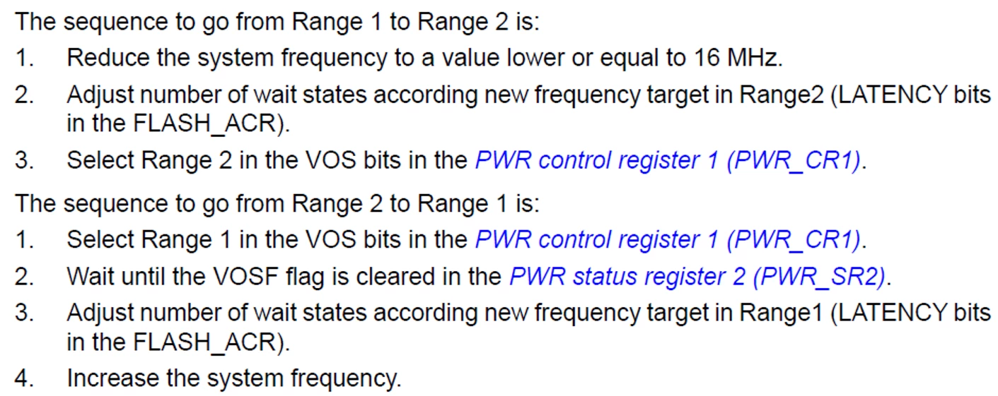

I found the protocol that switchs Range 1 to Range 2 mode in RM0434 document.
The basic protocol is like below and I found that three register should be changed to use Range 2 mode, which is RCC clock control, Flash ACR, and PWR control register (+PWR status register).
So, my question is how to change these registers and is there any example for change these or CubeMX to help change these value?
In addtion, I tried to change RCC clock using CubeMX but HCLK2 cannot be 16 MHz. Why?

go from Range 1 to Range 2 you have to:
  • Reduce the system frequency to a value lower or equal to 16 MHz. as you can see bellow.
  • Write 010 to the Bits 2:0 of the Flash_ACR register to have two wait states ( refer to the Table 4 of the RM0434).
  • Write 10 to the Bits 2:0 of the PWR_CR1 register to select RANGE 2.
you can do this importing some modification on your code's source files.

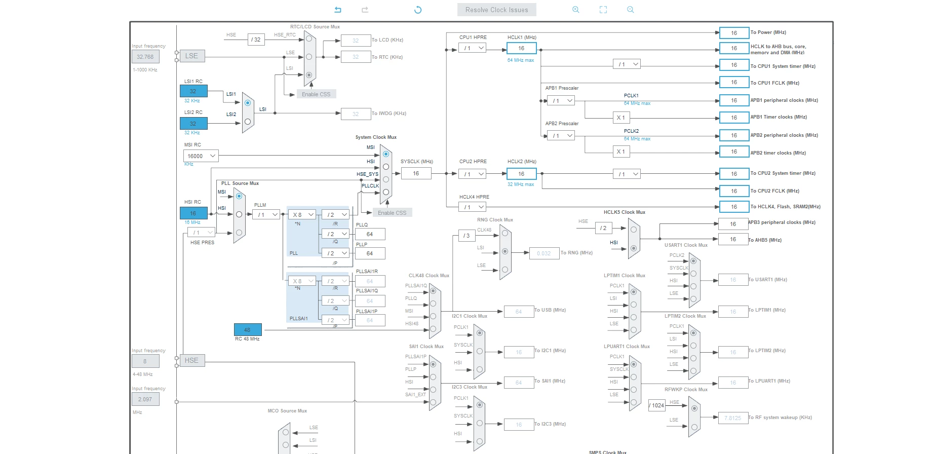

For your second question, the answer is in screenshot below.

Still, my cubeMX shows error in HCLK2 in 16 MHz.
Where can I write Flash_ACR register and PWR_CR1 register?

I suggest you to:
  • Update your CubeMX to the last version.
  • Is always better to change the registers value in your code before importing the program to the microcontroller.
