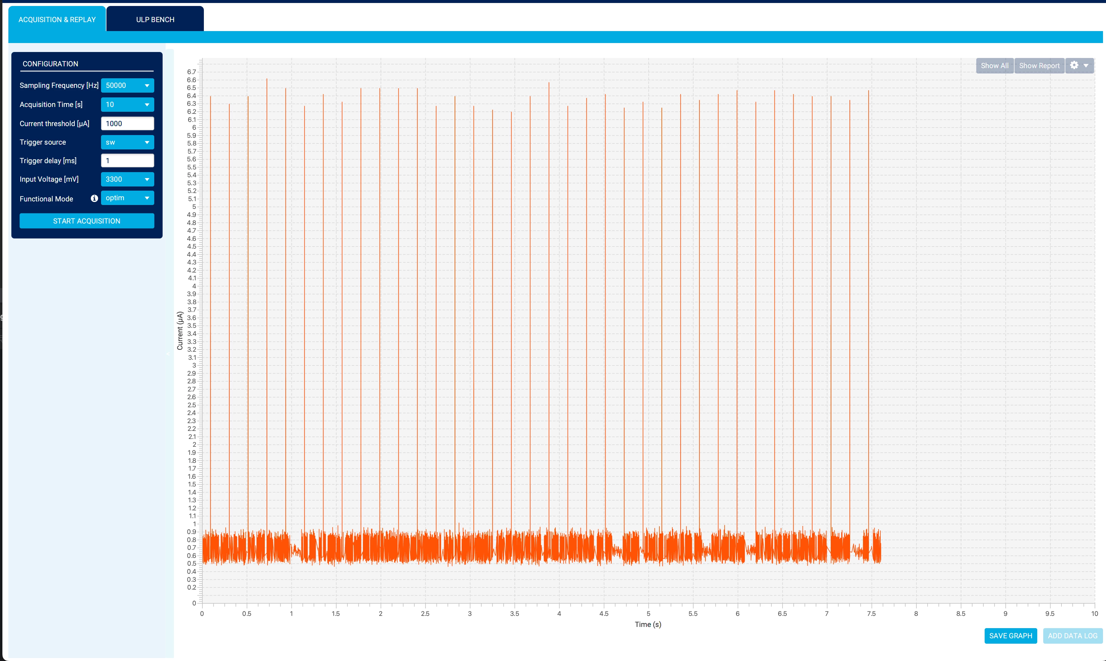

i am currently working on a BLE Customboard using a STM32WB55.
The current setup allows for a 1 second long BLE Advertising, to transmit sensor data.
After this second the device is going into STANDBY MODE using the tiny_lpm class:

Overall this seems to work quite nice since i am ending up with a power consumption of 0.6-0.7 uA which is matching with the datasheet.
I wanted to clarify if the spikes you see in the screenshot below are a normal thing?
The device itself is in standby and NOT waking up as expected. The power-consumption is at minimum but if i zoom in the time axis i can see spikes occouring in a regular pattern.
I am not sure if this is normal / or maybe has sth. to do with measuring inconsistencies.
The RTC-Timer itself should be powered through LSI-Clock.

Hello @Exeu,
Yes, these spikes you observe when the device wakes up from standby mode are a normal consequence of waking up after a certain amount of time
Here is why: when the RTC WakeUp Timer expires, it triggers an interrupt that wakes the microcontroller from standby mode. when waking up, it powers up the CPU and possibly other system peripherals, which consumes more power than when the system is in standby mode.
After that, it will re-enter standby mode, and the power consumption will drop back down to the low standby level!

Hey @Sarra.S.
Thanks for the answer.
Yes I am addressing those spikes in standby mode.
I guess this is not avoidable or? My setup does not have any external wakeup.it needs to wakeup after a certain amount of time. So I guess rtc wakeup timer is the only thing working?
