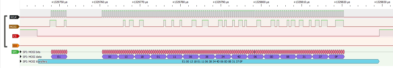

 this works to change CPOL to what the devices need, but whenever CPOL changes, the first byte transmitted is 0x00 and only 7 clock pulses are generated:
(the lines mark the first clock edges of bytes 2, 3 and 4, respectively. the 7 clocks before that are where I would expect byte 1. manually decoding these bytes show that the are indeed what I wanted to send)

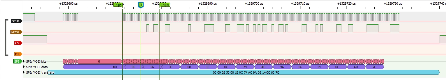

subsequent transfers work just fine:
(the second transmission sends different, but correct data)

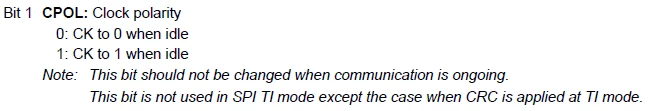

RM0434 35.6.1 states that
no transmission is ongoing when I change the bit, I'd expect the above to work as intended.
