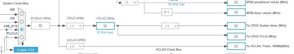

I'm working on a STM32WBRGV6, with dual CPU's, CPU1 for main application and CPU2 for the BLE stack.
I need to make the device ultra low power, and for that I launch the CPU2 in run mode only when I need it (on an external INT), with APPE_Init() function.
I would like to know if there is a way to put it back to a reset state? I can only find commands to release it from reset (with C2BOOT in PWR_CR4 register), but nothing to put it back in reset.
If I put CPU2 in shutdown/standby mode, it is still using too much power for my application.
Thank you in advance,
Rico

Maybe it's possible to turn off the clock for CPU2 (HCLK2) in RCC configuration?

Since my question I got the answer for my question directly from ST, it is NOT possible to reset it once CPU2 has boot.
The thing is I had several other problems in my firmware, and now they are solved, putting CPU2 in STOP MODE 2 make it consume nearly 0, which is good enough for me.
