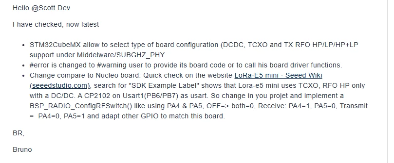

I am really very new to wireless communication but i need to make the project up and working. I have purchased 2 Wio E5 boards, getting confused how to build and make it working. I have gone through two gitshubs STM Repository and the seed studio repository  seedrepository At present i am looking for point to point communication. I found similarities with both the projects for example BSP folders for nucleo and LoraE5mini, i understand is i have to port the code, i tried hard but it is showing compilation errors. Please recommend me how do i proceed in terms of compilation.

Thank you for reply, I was able to compile, on high level i copied the changes to below files in BSP folder
from
I was able to compile not tested yet, but hoping i have done correctly.

As per the link STLink
If  i just change the PA4 and PA5 does it solve the problem?

Hello ​@STuser2 ,
What kind of problem are you observing? You can provide more details on your case and share the error message.
I think this tutorial here will help you on your project.
from
