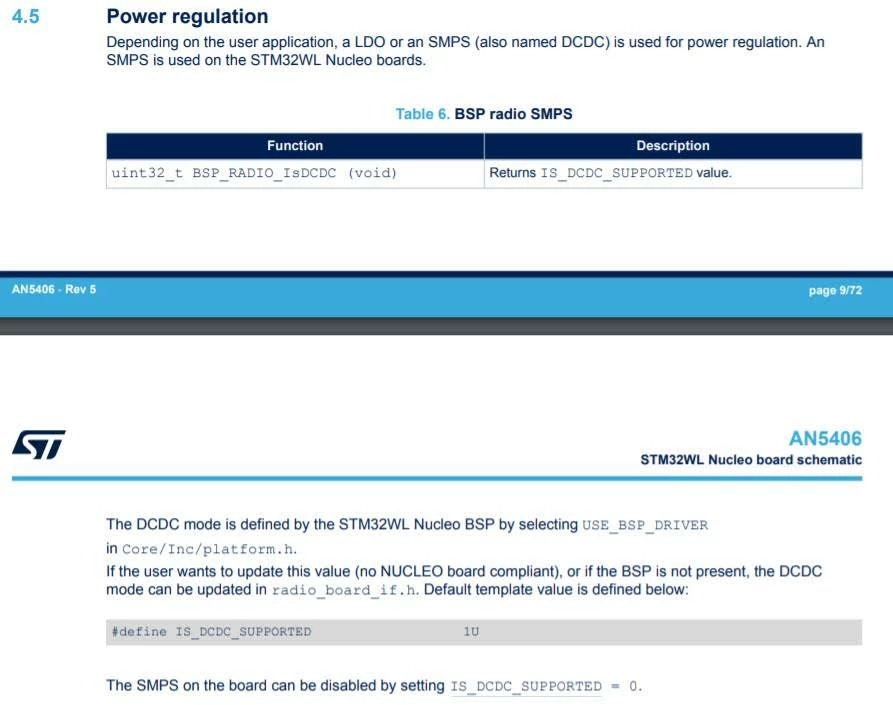

In this application note:
https://www.st.com/resource/en/application_note/dm00660451-how-to-build-a-lora-application-with-stm32cubewl-stmicroelectronics.pdf
I read that SMPS is also named DCDC

DTomi.1
Senior
May 13, 2022 3:07 PM UTC
Any updates on this?
DWalk.3
Jul 7, 2022 4:00 PM UTC
What I did was to modify the RBI_IsDCDC function. This function is called just before enabling the SMPS so I figured it was a good spot.
int32_t RBI_IsDCDC(void) {
 int32_t retcode = IS_DCDC_SUPPORTED;
#if IS_DCDC_SUPPORTED == 1
 // turn on SMPS clock detection
 SUBGRF_WriteRegister( SUBGHZ_SMPSC0R, 1 << 6);
 // now I can turn on the SMPS
 LL_PWR_SMPS_Enable();
#endif
 return retcode;
This is a pretty old thread. Maybe someone from ST will comment if this isn't a good idea.
EP.2
Dec 17, 2023 4:58 AM UTC
DWalk.3, the RM states that SUBGHZ_SMPSC0R reserved bits must be kept at reset value, so your code in function RBI_IsDCDC(void) should be something like this:
uint8_t register_read = 0; register_read = SUBGRF_ReadRegister(SUBGHZ_SMPSC0R);
register_read |= SMPS_CLK_DET_ENABLE; // 1 << 6
SUBGRF_WriteRegister(SUBGHZ_SMPSC0R, register_read);
