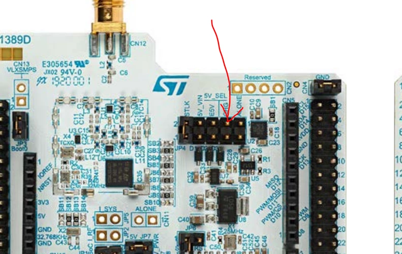

I want to check the low consumption in stop2 mode. I use directly the Sigfox_PushButton example of cubeWL
Page 71/79 of the AN5480 (Rev4 - July 2020) :

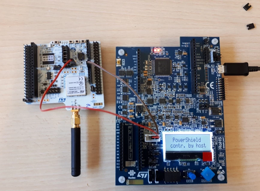

0693W00000JN51fQAD.pngI use the X_NUCLEO-LPM01A to measure the consumption in stop mode. With this setup:
0693W00000JN56BQAT.pngI supply the MCU through I_SoC (JP1) (at 3.3V)
I remove JP7 to remove LED5.
I remove STLK jumper (as shown in UM2592 P.22)

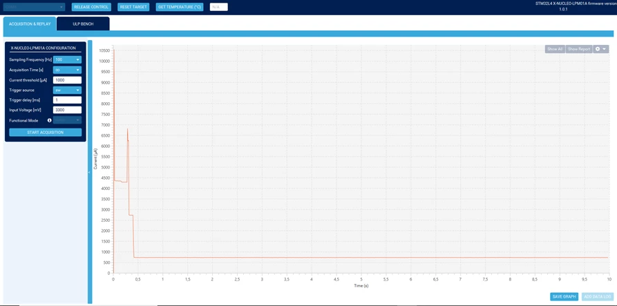

I measure : 725uA !!!0693W00000JN57iQAD.png
How in practice to measure these 2uA ?
Thank you

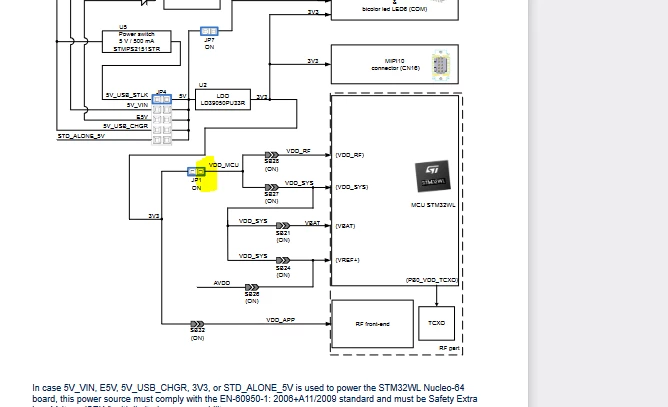

Hello @LLr.1​
In the above measurement, you have to power-up the LDO (component U2) Figure 10. STM32WL Nucleo-64 board power tree because 3.3V is needed to supply the VDD_APP.
If you want to only supply the board through X_NUCLEO-LPM01A only, i would suggest to supply MCU through JP1 BUT keeping JP1 closed and unsolder SB1 to remove connection to LDO (otherwise it is seeking current when unpowered)
BR,
Bruno

OK, but removing SB1 is permanent. Can I solder a jumper ? (as I can be done with SB28/JP2 or SB27/JP3). (In order to change after this single measurement to 5V USB supply to flash the code et cetera.)
Nevertheless, I don't understand how the LDO can seek current because I supply thought JP1 which is open. see screenshoot :
NB: I managed to find the standby current of the datasheet by feeding here. (with simple PWR_STANDBY and POWER_STANDBY_RTC example)
Best regards
Jan 28, 2022 10:12 AM UTC
Ok, so just to be sure when executing Sigfox_PushButton  did you power off/on the board and compile without debug in lpm mode ?
Can you measure again this scenario by powering the STLINK and VDD_APP ?
Seeking current though SB1 is not permanent but happens more on wakeups & TX/RX RF phases (as VDD_APP) is required. So it is just an advice to measure the consumption of the whole board without external power supply (ex USB STLINK connection) and reach the minimum consumption in the MCU range 1.71v to 3.6v.
Yes, you can solder a jumper. µ

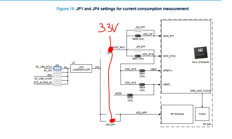

Thus, if I understand well your measure 2uA by removing SB1 and after I have to use external wires to feed in 3.3V JP1 and JP2 with the pin here ? :
0693W00000JNjSlQAL.pngBest regards
Jan 28, 2022 4:09 PM UTC
Let me do the same setup as you & i will get back to you soon.
BR,
Bruno

Jan 31, 2022 1:13 PM UTC
Hello @LLr.1​
So, i confirm my expectations...
If you power the nucleo with USB (STLINK) + JP1 via X_NUCLEO-LPM01A, you get effectively the 2uA in STOP2 mode in the Sigfox example.
If you only power the nucleo via JP1 (X_NUCLEO-LPM01A) + remove all JP7 jumpers (so performs the measurement like shown in you first picture with JP7 removed) you get an overcurrent because of VDD_APP not beeing supplied (due to the RF switch U3). If you keep SB32 and solder a jumper on JP9 then disconnecting JP9 and you get your 2uA back (but RF is not functional anymore).
So yes, i agree with you best choice is to solder JP9 and supply both JP1 + JP9 external with X_NUCLEO-LPM01A.
Another remark, i have noticed that putting the fingers around JP7 create can also create overconsumptions. It is expected as you left in a dangling state VCP_RX & VCP_TX. So to keep traces functional and avoid extra consumptions due to noise, pull-up PA2/PA3 (GPIO_InitStruct.Pull = GPIO_PULLUP;)
Do you confirm it is now ok on you side ?
BR,
Bruno
PS: Please select as best answer to improve stcommunity experience

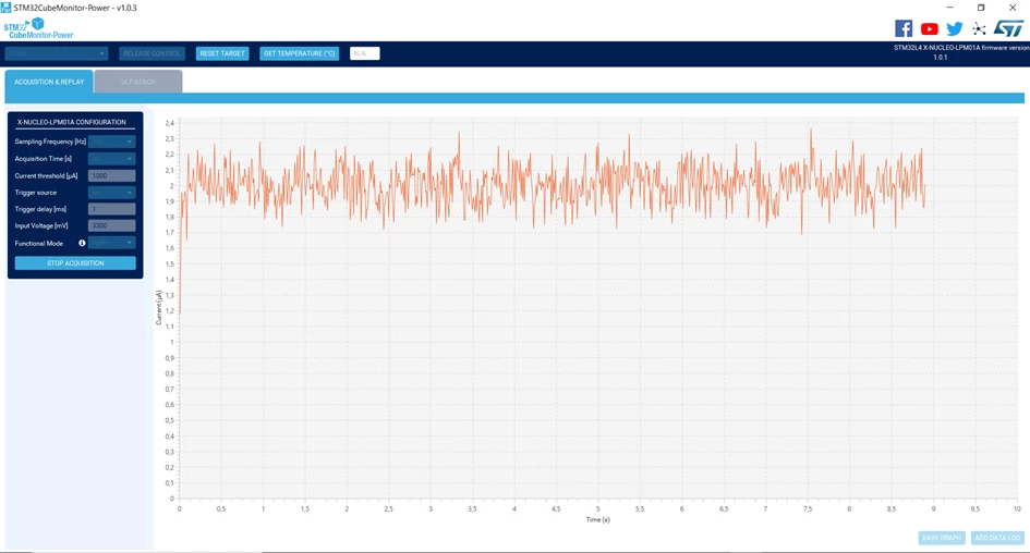

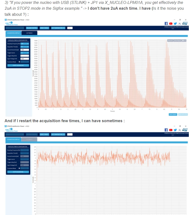

1) "only power the nucleo via JP1 (X_NUCLEO-LPM01A) + remove all JP7 jumpers (so performs the measurement like shown in you first picture with JP7 removed) you get an overcurrent because of VDD_APP not beeing supplied (due to the RF switch U3). If you unsolder SB32 and solder a jumper on JP9 then disconnecting JP9 and you get your "2uA back (but RF is not functional anymore)." -> Ok, I have 2ua
2) "solder JP9 and supply both JP1 + JP9 external with X_NUCLEO-LPM01A." -> Ok, I have 2ua

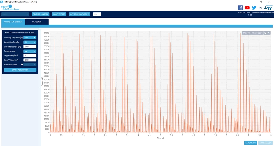

3) "If you power the nucleo with USB (STLINK) + JP1 via X_NUCLEO-LPM01A, you get effectively the 2uA in STOP2 mode in the Sigfox example." -> I don't have 2uA each time. I have (Is it the noise you talk about ?) : 0693W00000JOpODQA1.pngAnd if I restart the acquisition few times, I can have sometimes : 0693W00000JOpOmQAL.pngThank you
Best regards
Feb 7, 2022 1:29 PM UTC
Hello @LLr.1​
Great !
Yes please try with pull-up on PA2/PA3.
Br
Bruno

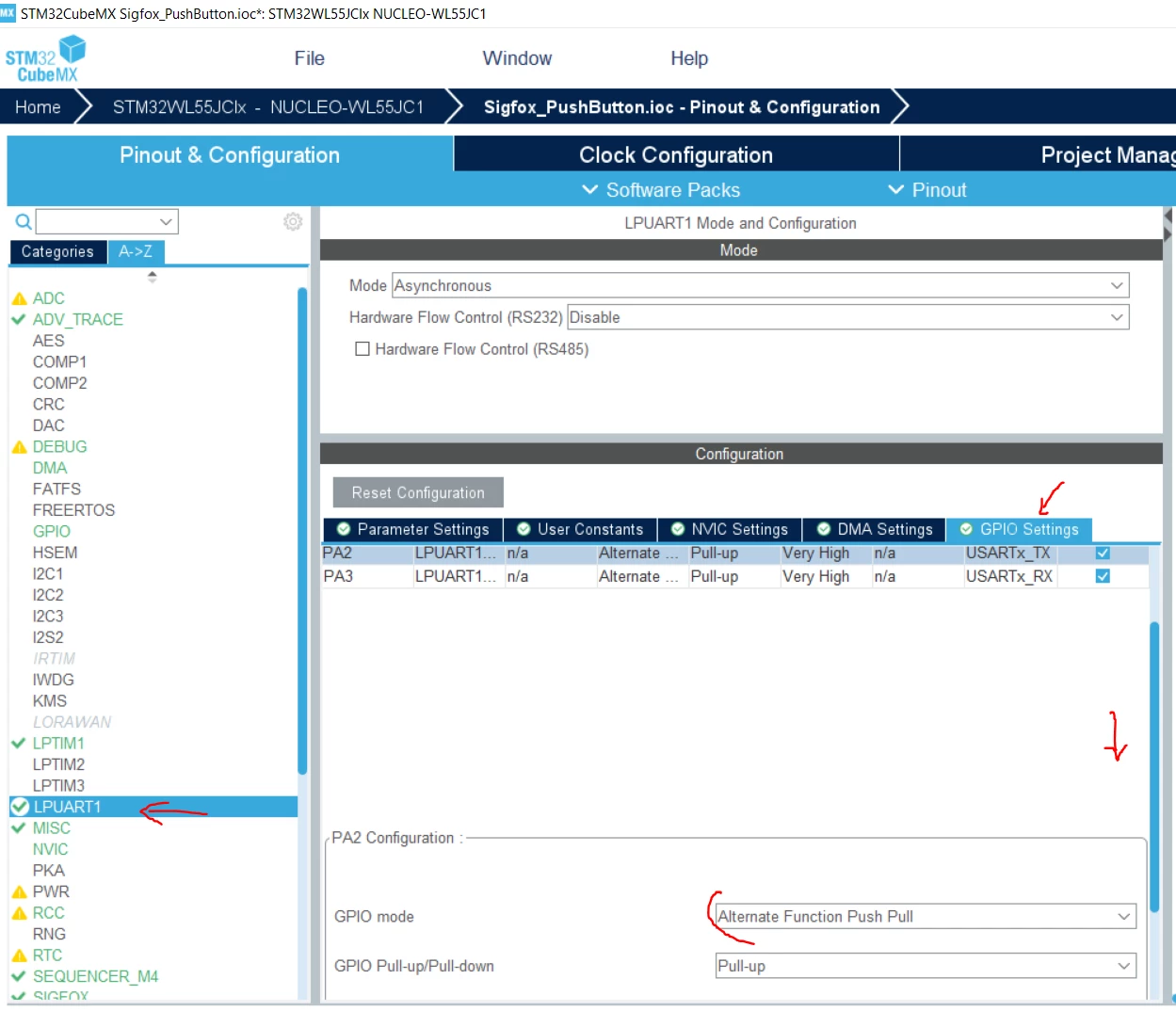

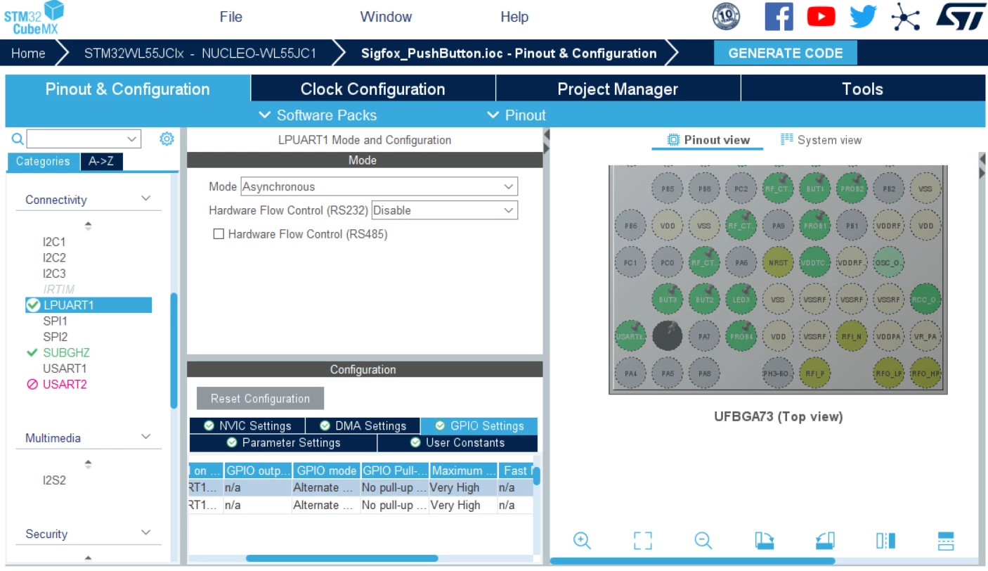

I tried to pull-up PA2/PA3 on Cube MX:
0693W00000JOrBVQA1.pngbut I cannot change the "No pull-up..." in "Pull-up". Also, What is the use of this LPUART1 ? It is not used with LoraWan end node
Feb 8, 2022 7:32 AM UTC
@LLr.1​
Please try to pull them up directly in the Code. I will check, but i suspect a CubeMX bug that i will report if it is the case.

Feb 7, 2022 3:14 PM UTC
Please try changing in the code directly. I will check why CubeMX doesn't want to and report a tool bug if it is the case...

I cannont see the classic MX_GPIO_Init(); to initialize the pins where I can do that ?
Feb 16, 2022 2:29 PM UTC
I have check there is no bug tool (CubeMX version 6.4.0)0693W00000JQ3ayQAD.pngIn the code it is in HAL_UART_MspInit().
BR,
Bruno

Feb 17, 2022 7:23 AM UTC
Update : it is just a problem with this board, with another board, I have the good current curve.
