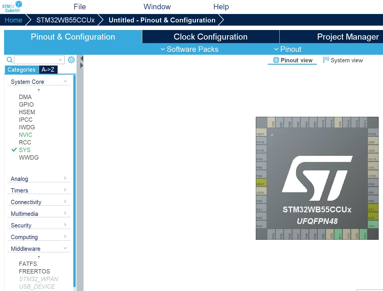

After checking, your MCU does not support the touch sensing capability.
You need to use another one.
Best Regards.

STTwo-32
Aug 15, 2024 6:09 AM UTC
Hello @Parry
So, the STM32_Touchsensingis a middleware that can be used with some STM32 MCUs. So, all you have is to open CubeMX, select an MCU or a board that you are going to use (as i can see is an STM32WB) and start your project. On the configuration panel of CubeMX m, go to middleware and enable the STM32_Touchsensing (you lay also have some settings to do for the middleware parameters).

ParryAuthor
Aug 15, 2024 6:01 PM UTC
Hi there, I do not see an option to enable touch sensing for this MCU. It does appear to automatically be there for the
STM32F072RB MCU though.
Is there something I need to configure in order to get it to appear?
STTwo-32
Aug 15, 2024 6:27 PM UTC
It should be under middleware. It may be garyed. If so, please put you cursor on it and a message that tell you what you have to do before you can enable it.
Dont forget to use the last version of CubeMX (V6.12.0).

ParryAuthor
Aug 15, 2024 7:37 PM UTC
never mind, the STM32WB55CE does not have touch sensing capabilities.
