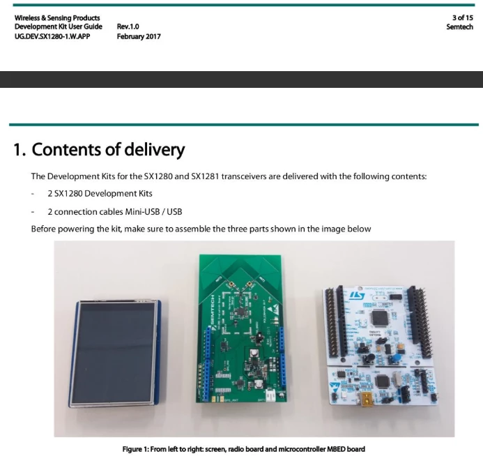

As @unknown says, see Semtech's site for drivers, SDK, etc for their chips
https://www.semtech.com/products/wireless-rf/lora-connect/sx1280 - see the 'Software' tab.
Note that Semtech's own devkit for the SX1280 is based on an STM32 Nucleo board:
Andrew Neil
Mar 3, 2026 5:24 PM UTC
@JamesParking wrote:
a Semtech SX1280 Evaluation Board
What board, exactly ?
Make sure that it doesn't interfere with the VCP connection (on Arduino pins D0,D1) ...
First try to get just the VCP connection working without this extra board attached

I'm using the Nucleo L073RZ STM32 board connected to the SX1280 evaluation board. I have the STM32 connected to my PC via USB, and I can see it on STM32 Cube Programmer, but nothing shows up on the serial monitor.

You still haven't said what SX1280 board you are using.
