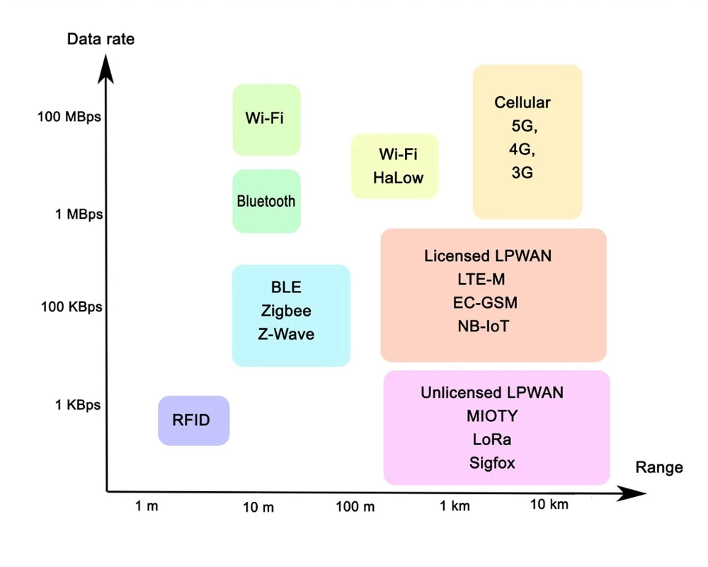

I chose this due to the mesh structure and the high number of connected devices. Do you have any other protocol recommendations that would be suitable for the structure I mentioned?
Andrew Neil
Oct 22, 2024 1:14 PM UTC
WiFi would seem an obvious choice?
Why do you particularly need a mesh?
from: https://www.emnify.com/iot-glossary/guide-iot-protocols
Not sure that their depiction of "BLE" accounts for the v5 2M PHY ?
Also not shown on that (too new?)  is the 5G DECT NR+
https://www.5gtechnologyworld.com/the-first-non-cellular-5g-standard-dect-nr/
https://www.dect.org/nrplus
Maybe also look at Matter?
