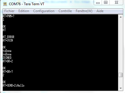

Send LoRa packet with AT command - b-l072z-lrwan1
Posted on June 12, 2017 at 15:37
I am trying to use LoRa connectivity with the brand new b-l072z-lrwan1 discovery board. The End Node project works perfectly but I have an issue with the AT Slave project. When I try to send LoRa packet to my Multitech gateway, this one never receive the packet and I cannot use AT command with the disco board anymore. I can only do a hardware reset of the board.
As you can see on my screenshot, the Join process has been done correctly. After the AT+SEND command I never receive a status like OK or AT ERROR.
Are you able to help me ?
Thank you !
Aaron

I am having this same issue. It appears to be related to the tiny_sscanf, but I can't seem to figure out why?

Try rebuilding the firmware using the v1.1.1 release of the LRWAN software

I have exactly the same problem in the AT_Slave software that I built.
I was using LRWAN software v1.1.1. I only added the 'REGION_US915' compiler switch without modifying anything of the code.
If I use the binary provided in this thread:
https://community.st.com/community/stm32-community/blog/2017/04/05/lora-discovery-kit
LoraDisco_ATSlave_US915.hex),
I can send data without this stopping issue.
Any way to solve it?

Here is a quick build of AT_Slave V1.1.1 US915

Thanks Clive One. Your build works for me. I can send the data and receive response.
But I also need to figure out our cause as we need to customize the firmware and build ourselves.

Like others have posted we need customization, we also use US_915_HYBRID and require channel masks (hence our custom build).

I used the provided project and the recommended eclipse based tools. It builds just fine. Just send doesn't work. It hangs in tiny_sscanf. I worked around it and doing my own build with my own tool chain that is now working fine.
